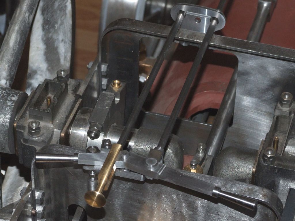

          I've just done this for a clevis on my regulator, bottom middle:
          Sadly I don't have a picture of the slot machining as I didn't think it merited one. I cut the slot with the steel bar vertical in the machine vice. I used a 6mm carbide endmill. First cuts were through the middle of the slot going 2.5mm deep per pass. I then shaved one side full depth (20mm) to get the side to the correct thickness, and then the other side to get the slot the correct width. For a hand knurling holder it wouldn't matter if the slot wasn't exactly central.
          I considered using a 1/4" S&F cutter, but it was too much of a faff to set it up. That would have been on a large horizontal mill. I wouldn't consider using the S&F cutter on my vertical (Bridgeport) mill; it simply isn't rigid enough.
