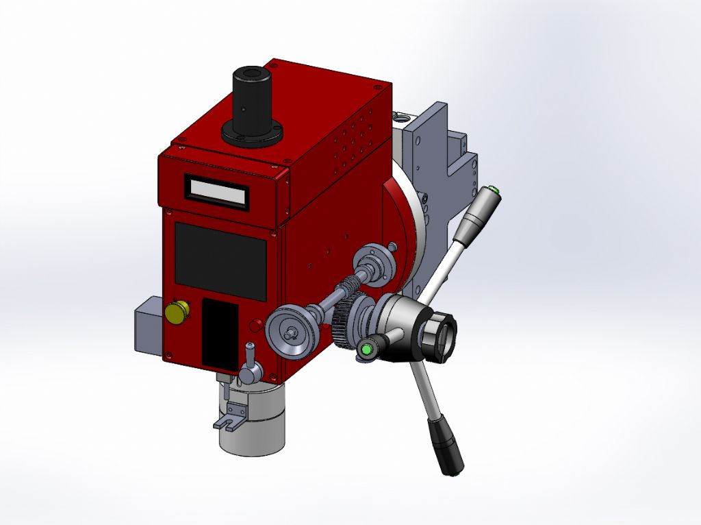

      I've had an X3 mill for quite a few years now but in an idle moment wondered how the fine feed on the SX3 is coupled /decoupled from the quill handle such that the worm is not jammed solid when the quill handle is used.
      Can't see anything obvious on the exploded view nor the dismantling guide on the arceuro website

          Usually a splined/dog clutch operated via the knob on the end of the main 3 spoke handle.
          regards
          #335116
            Part 120 is a small handwheel that when done up locks the worm gear to the spindle quill feed which is then driven by the fine feed handwheel worm at the front. When it is loose the quill "drilling" handles can rotate freely and they drive the quill.
            See "Fine feed locking knob" on the SX2.7

                The quill fine feed is engaged with a friction clutch arrangement when you tighten the locking knob. (shown here in model with cover removed).
