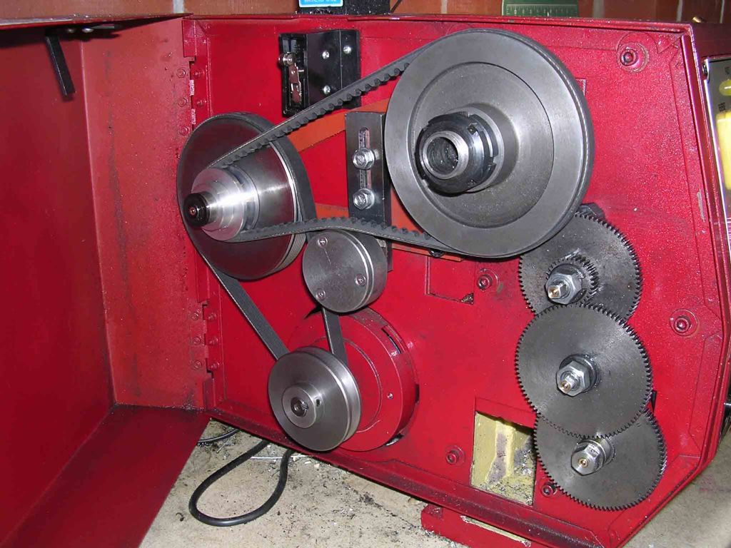

      Hi Guys, have worked out many new gear combinations for Sieg's C6 lathe. Can cut all tpi and mm threads in common use today. In order to do this, make one small grind and one small milling cut to the gear rest. This makes it fit better, and allows many more threads to be cut, with the supplied gear set.
      If interested in turning a fairly capable lathe into a world beater let me know.

                  Hi Guys, thanks to all of you who replied. The Sieg C6 (or Axminster) can "only" cut 20 threads as per the thread chart supplied with the lathe. My lathe has a 2mm leadscrew. My calculations will only work with that. As of yesterday, the C6 can cut 46 threads -all of the metric and imperial needed. This is the first time I've ever used a forum. Don't know how to include a photo. The small modification requires a little grinding of the gear rest or holder or banjo. And a small 30 degree milling slit. These increase the clearance between the holder and the 40 tooth gear assembly permanently attached to the lathe (unless you wish to use the reverse gear).
                  I reiterate that I've only had access to the gear set supplied with the C6 (25,30,33,40,42,50,55,60,66,70,75,80 and 90 toothed gears). But these will make 18 additional threads, mostly imperial. I can provide charts, and a photo if interested. But if okay I will send it to the forum host who can disperse to interested people. Sieg are going to provide me with all the gears I haven't got to turn 46 "perfect" threads with almost zero error. A revised chart will be made available asap.

                      So the mod allows the banjo that holds the gears to swing closer to the spindle, so that smaller gears can be used at the top end?

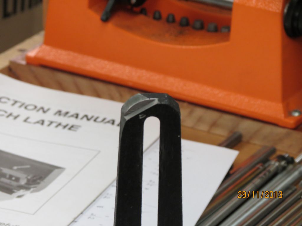

                        Hi Steve, yes it would allow a little lathe to do "big stuff.
                        At present, with no difficulty I can thread from 254 tpi to 8 tpi, and from 0.1 mm to 5.0 mm. I have posted a photo of the lathe banjo modification. The main threads are 48tpi to 8tpi, and from .4 mm to 5.0 mm.
                        When you reply I'll include the revised gear chart. This hopefully will only be a temporary one since Sieg is looking at providing accessory pack of all the gears necessary for really accurate threads. Mine will suffice perfectly for all threads, but is a little out for some – but nothing to worry about, unless you're trying to make a spaceship! Ordinary nuts thread effortlessly if you do your part on the thread.
