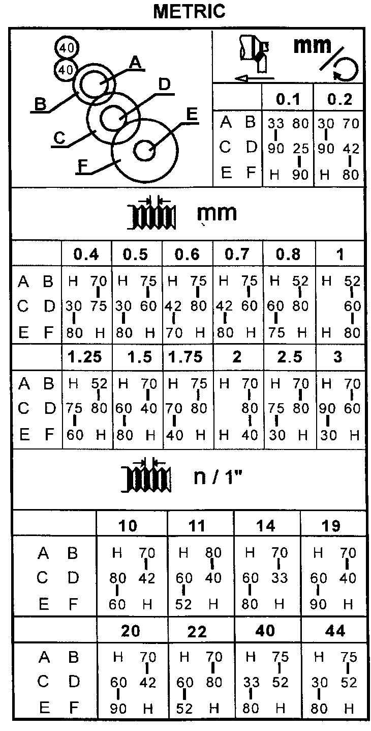

                      #197054
                      AlanW
                        @alanw96569
                        Ian, I hope I haven't found this thread too late to receive a response. I bought a metric version of the Warco wM240 recently, only to find that it has some gaps in the tpi thread range. The more glaring omissions to me are 18 and 24tpi, used in the Unified and Whitworth ranges. I've tried on-line change gear calculators but haven't found any solutions that make any sense. With the WM240 having the same 40T spindle and idler gears, I wondered if your calculations for the C6 would apply, if I obtained the suitable extra gear(s).
                        The table for the WM240 is below.
                        Alan
                        Edited By JasonB on 17/07/2015 18:45:37

                              #197143
                              AlanW
                                @alanw96569
                                Hi Graham,
                                That is a very kind offer. Thank you. I'm sure there are other 240 owners that would also be grateful for a list of extra threads.
                                The magic gear that is absent from the 240 range seems to be the '66'; bit of a cheapskate omission if it could provide such a range of other common thread pitches. (Anyone from Warco reading this?) The full set of gears I have includes: The resident 40T on the spindle plus 40T idler; the actual 'change gears are 25, 30, 33, 40, 42, 52, 60, 70, 75, 80, 90, 90.
                                Comparing your solution above for 24tpi to the standard gear set also shows that '50' is also not included. Both of the omitted gears are available from HPC in Mod 1 size at reasonable prices. The banjo size would also not be too much of a problem because a redesigned replacement would be simple to manufacture. I've been there before adding an extension to my Hobbymat banjo to extend the range. That, though, was simply to add a 30:60 or 35:70 cluster to double or halve existing threads.
                                I have tried to access the thread on Woodworkforums.com but ,even after registering, it won't allow access.
                                I look forward to seeing what your calculator comes up with.
                                Alan

                                    #197172
                                    Graham Wharton
                                      @grahamwharton
                                      Hi Alan,
                                      Well using your set of change gears I've run the numbers and I get the following.
                                      http://gwharton.com/wm240.html
                                      There's a whole load of data there as it basically runs every imperial pitch from 5TPI to 80TPI in 0.5TPI intervals and then from 0.01mm to 0.2mm pitch in 0.01mm intervals and 0.25mm to 6.0mm in 0.05mm intervals.
                                      Should probably explain in the geartrain column,
                                      • a – means that the two gears are meshed. i.e 10-20 is 10 meshed with 20.
                                      • a : means that the two gears are on the same shaft. i.e 10:20 is 10 and 20 gears on the same shaft.
                                      • Sometimes you might get 90:90 where both gears are the same on that shaft, in this case, just install the one gear, you dont need to use two.
                                      It lists the desired pitch, the achieved pitch, and the % error in what was achieved.
                                      From the chart I now get
                                      17.95 TPI = 70 (TOP RIGHT), then 90 (TOP LEFT) meshed with 42 (MIDDLE LEFT) and 52 (MIDDLE RIGHT) meshed with 90 (BOTTOM RIGHT)
                                      24.04 TPI = 70 (TOP RIGHT), then 80 (TOP LEFT) meshed with 75 (MIDDLE LEFT) and 52 (MIDDLE RIGHT) meshed with 60 (BOTTOM RIGHT)
                                      I dare say, there are probably a few standard pitches that you will be able to pick out the charts that will fit straight off. I don't know whether manufacturers down play the amount of threads that their machines can cut out of the box in order to tempt you into going for higher models. I could certainly cut many more threads than advertised with my C6B out of the box.
                                      Obviously all of these numbers are based on the physical limitations of the C6B, so I may be throwing away more accurate combinations because of this.
                                      If you wanted to go one step further, you could make the following measurements and let me know the results and I will rerun with the limitations of the WM240 instead of the C6B
                                      • Distance from the centre of the feedscrew shaft to the bottom of the 40T idler gear + 2mm. C6B = 156mm
                                      • Put your largest gear in the top shaft of the banjo at the furthest extent so it still meshes with the 40T idler and measure the distance from the centre of the feedscrew to the top of the largest gear you fitted (inline with the axis of the banjo, not where it meshes with the idler). There might be obstructions that stop you putting a large gear at the very top of the banjo. C6B = 181mm
                                      • Move the lower shaft of the banjo to the lowest position with no gear fitted and measure the distance from the centre of the feedscrew shaft to the centre of the lower banjo shaft C6B = 43mm
                                      • Place a gear in the top shaft on the banjo and engage with the 40 tooth idler. Now, if you were to put a gear next to it on the top shaft, how much bigger in diameter can that second gear be, before it fouls on the end of the 40T idler shaft. C6B = 20mm. i.e For module 1 gears, 1 tooth = 1mm diameter. So in my case, if I put a 60T gear to mesh with the 40T idler, I cant put anything bigger than an 80T next to it.
                                      • How much air gap to leave between gears so they don't mesh. C6B = 1mm
                                      • What is the diameter of your spacers. C6B = 21mm
                                      • Place the upper shaft on the banjo at the top position as far as it will go. Place the lower shaft on the banjo at the lowest position, and measure the distance between the two shaft centres. C6B = 100mm
                                      • Whats the smallest size of gear that you can fit on the top banjo shaft and still engage the gear with the 40T idler, without the gear securing bolt fouling on the spindle Vee Belt pulley. C6B = 60 teeth. You might not have this limitation if the drive pulley arrangement is different on the WM240.
                                      Hope this helps.
                                      Graham
                                      Edited By Graham Wharton on 18/07/2015 16:01:58
                                      Edited By Graham Wharton on 18/07/2015 16:05:50
                                      #197173
                                      mahgnia
                                        @mahgnia
                                        Alan'
                                        Using gears that I have made for my C6, including supplied gears:
                                        18TPI:
                                        18.011 TPI, 40 – Idler – 52 : 55 – 60 Error 0.061%
                                        18.011 TPI, 40 – Idler – 60 : 55 – 52 Error 0.061%
                                        18.011 TPI, 40 – 50 : 55 – 90 : 75 – 52 Error 0.061%
                                        18.011 TPI, 40 – 52 : 55 – 90 : 75 – 50 Error 0.061%
                                        18.008 TPI, 40 – 75 : 80 – 66 : 60 – 55 Error 0.046%
                                        17.995 TPI, 40 – 75 : 80 – 70 : 66 – 57 Error 0.030%
                                        18.011 TPI, 40 – 80 : 75 – 65 : 55 – 45 Error 0.061%
                                        18.011 TPI, 40 – 65 : 55 – 90 : 75 – 40 Error 0.061%
                                        18 TPI can be done with the standard supplied gears with a high degree of accuracy only with certain mods to the gear quadrant or gear assembly to allow spindle clearance from the gears.
                                        24TPI:
                                        24.003 TPI, 40 – Idler – 42 : 25 – 45 Error 0.013%
                                        24.003 TPI, 40 – Idler – 42 : 50 – 90 Error 0.013%
                                        24.003 TPI, 40 – 42 : 40 – 90 : 75 – 60 Error 0.013%
                                        23.993 TPI, 40 – 70 : 66 – 75 : 60 – 57 Error 0.030%
                                        23.993 TPI, 40 – 70 : 66 – 65 : 52 – 57 Error 0.030%
                                        23.995 TPI, 40 – 70 : 65 – 80 : 57 – 50 Error 0.022%
                                        24.003 TPI, 40 – 90 : 75 – 70 : 50 – 45 Error 0.013%
                                        24.003 TPI, 40 – 45 : 50 – 90 : 75 – 70 Error 0.013%
                                        23.993 TPI, 40 – 57 : 60 – 70 : 66 – 75 Error 0.030%
                                        23.993 TPI, 40 – 57 : 60 – 75 : 66 – 70 Error 0.030%
                                        23.993 TPI, 40 – 65 : 66 – 70 : 52 – 57 Error 0.030%
                                        23.993 TPI, 40 – 65 : 66 – 57 : 52 – 70 Error 0.030%
                                        The second listed gear train uses only standard supplied gears.
                                        These have all been calculated by my program to be installable on the C6.
                                        They may also work on your lathe.
                                        The gears that are not standard on the C6 were made from aluminium using plastic gears from the C3 lathe as indexing templates, with a fly cutter ground to similar size MOD 1 gear tooth profile, in an indexing fixture. This gave me additional gears 35T, 45T, 55T, 57T and 65T.
                                        Andrew.
                                        Edited By mahgnia on 18/07/2015 16:34:53

                                          #197290
                                          AlanW
                                            @alanw96569
                                            Hi Graham,
                                            I have measured my WM240 as you detailed and obtained the following:
                                            a) Distance from feedscrew centre to bottom of 40T idler 152mm (150mm measured +2mm)
                                            b) Distance from feedscrew centre to top of largest (90T) gear 185mm
                                            c) Distance from feedscrew centre to lowest banjo lower spindle centre 39mm
                                            d) Maximum size differential between gear diameters on top banjo spindle 8mm (52:60) *
                                            e) Air gap between gears 1mm (boss on all gears except 25mm)
                                            f) Spacer diameters 22mm
                                            g) Maximum distance between upper and lower banjo spindle centres 100mm
                                            h) Smallest size top banjo gear in mesh with 40T idler smallest gear (25mm)
                                            * This distance seems disappointing when compared to the 20mm for your C6B and, reading down the top banjo spindle combinations, it looks as though quite a few selections would be prevented with the idler as is. The limitation is caused by the second gear fouling a large washer/cover plate over the idler gear bearing. More space could possibly be gained by replacing the ball race with either a plain or needle roller bearing. I tried several combinations of adjacent size gears but couldn't better the 8mm. 60:70 just rubs on the offending bearing cover, preventing complete meshing.
                                            Other than the lack of gear size differential, most of the WM240 measurements are not vastly different to your C6B.
                                            I appreciate the time you must have put into this for me. Thank you.
                                            Alan
