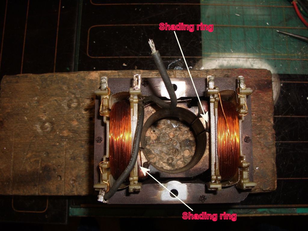

      I have an extractor fan motor (not working) where one shaded ring is wired in parallel with the stator windings. An internet search of wiring diagrams does'nt show this, but there are so many I may have missed it. Is this wiring arrangement unusual. I would be interested to know a bit more about it.

                Thanks to all who have responded to my post. Having looked again one lead is is attached to a stator coil, however
                the other lead is not , I had thought that there was a link from where the other wire of the coil was soldered, to the tag where the other lead shaded ring was attached , and there is'nt. deteriorating eyesight, age related that is my excuse. There was once a speed control system consisting of potentiometer triac resistor and capacitor, which overheated in a serious fashion, burnt out infact. I am not into electronics sufficiently to put together a replacement.. The resistance through the stator windings is 8 ohms, which seems very low.
                It is going to be an interesting exercise to find a replacement which is dimensionally similar. The extractor assembly is German , as are the rest of the kitchen units, and fitted over 25 years ago

                        Colin, thanks for your informative response.The motor does indeed have 2 stator winding, and 2 shading rings, one of which has 2 leads from it which I now am aware was probably connected to a capacitor. There was once a speed controller which gave variable speed (not stepped) and a capacitor which had seen better days, just a sticky mess, , so I could'nt determine any values the rest of the controller had burnt out .The extractor hood assy is German, and a label on the casing states 'motor 230v, 50hz,230w.
                        I have readings through the 2 stator windings, the rotor looks ok , but how would I check?. Capacitor type and values? and wiring it in would be speculative. I would be quite pleased to have the motor run at one speed.
                        The motor has all the characteristics of a ______ from what I have seen of pictures, so what should I call it. I could come up with a few non electrical terms. Regards Lynne

                            John, I have created an album,and there should be a photo of the motor

                              Just a quick thought, could that be a connection to a thermal switch/fuse that is bedded in the assembly to protect the windings/motor from overheating?

                                  Les Jones 1
                                    @lesjones1
                                    Hi Lynne,
                                    I have never seen any connections made to the shading rings on a motor. I can not see any connections to the shading rings on the side of the motor in your photo. can you post a picture of the other side of the motor showing the connection to the shading rings. Also can you post the schematic of how the motor was originally wired. Was the capacitor you refer to just the low value capacitor (In the region of 100 nF) used in the phase angle speed controller or was it a larger value capacitor.
                                    I have copied your picture into this post so that people do not have to go to your album to see it.

                                      Thanks for posting the picture.
                                      Nick, without the picture it had sounded as though there were two sets of coils. I can see now that there is just one set of coils connected in series or parallel so they both see the same phase.
                                      The shading rings will delay the field causing it to rotate anti clockwise as viewed in the picture.
                                      Lynne, I can't see any reason for a capacitor to be included unless it was for power factor correction but that seems a little over the top for a small cooling fan motor.

                                        Colin is correct, this is a basic single winding shaded pole motor where the winding is split between the two opposing pole pieces. The extra black wire is odd and if I had to guess it's an extra winding that used to generate a low voltage to do with the crude triac speed control. The two "shade" windings are entirely conventional.
                                        Lynne, I'd suggest stripping off the thick black wire and the motor should work at a single speed off the mains. No need for any capacitors or anything like that. This should get your extractor back on the road.
                                        This motor probably has quite a high resistance rotor and would qualify as a "torque motor". These run at high slip ratio and you can vary their speed by varying the winding current. Used for example as spool drives in reel-to-reel tape decks, where a low current is used when playing or recording, a higher current for fast-forward or rewind. I used to have a Magnavox deck which had two of these for the spools, plus some big resistors switched in and out to vary the torque depending on what you were doing. There was a third more conventional motor driving the capstan at constant speed.
                                        The triac control would just be working like a lamp dimmer, the capacitor probably as a phase shifting component in the gate drive. Horrid.

                                          Can't help thinking the black wires simply go to a thermal cutout buried down the side of the winding. It also looks as if the free black wire was originally soldered to the spare tag (second from left on top row). I bet if you measure between the black wires you will find an open circuit (non-resettable thermal trip blown) and if you bypass the black wires the motor will run again.
                                          Of course, even if this "fixes" the motor, the cause of the overheating may still remain. Generally the lifetime of a motor like this will be down to the bearings (not shown). Both porous bushes and ball bearings dry out with time, at which point the motor load, winding current and temperature will increase. Unless this is an impedance protected motor, you need a thermal cutout to protect against stalled or overloaded conditions. You might bypass the cutout but if you don't rejuvenate the bearings, you may simply cause a fire next week / month / year.
                                          For motors of this quality, you may be best to throw it in the skip and buy a new one. They aren't really intended to be repaired.

                                            Muzzer. You are correct, the free black lead did go to the tag. Your suggestion that the two were from a thermal cutout buried down the side of the windings, encouraged me to try and extract it, and it did relatively easily, together with the protective shroud. I have put a picture in my album, for as yet I have not sussed attaching pictures to my posts. However I did get a reading of 8 ohms across the two leads, and 18 ohms through the two stator windings, so what does that tell you?
                                            Reasons for overheating. The motor and cyl. type fan, were seriously gunged up with fat, despite renewing filters from time to time. It would be a shame to bin it, as the bracketry and bearings are robust, and incorporate rubber mtgs.
                                            Les. Thanks for the picture upgrade. Wish I were able to do that. No info on wiring arrangement. Capacitor value, no idea. The innards had extruded themselves from the casing, which was a sticky mess, and attempts to clean, resulted in removal of any data that existed. Picture of the other side in my album Sorry.
                                            John & Colin. Thanks for all your input. I guess that if the device is indeed a thermal cut out, it should be retained in the circuitry , that is if the motor ever runs again .

                                              Sounds as if the cutout didn't blow – or that it may be some form of PTC (resetting) device if your meter is accurate – have you checked what reading you get with the probes shorted together?
                                              If the bearings are still OK but the fan simply bunged up, it may be possible to reuse it but I'd suggest you keep the thermal protection thing in place. Sounds as if it should work again if you free it up.
