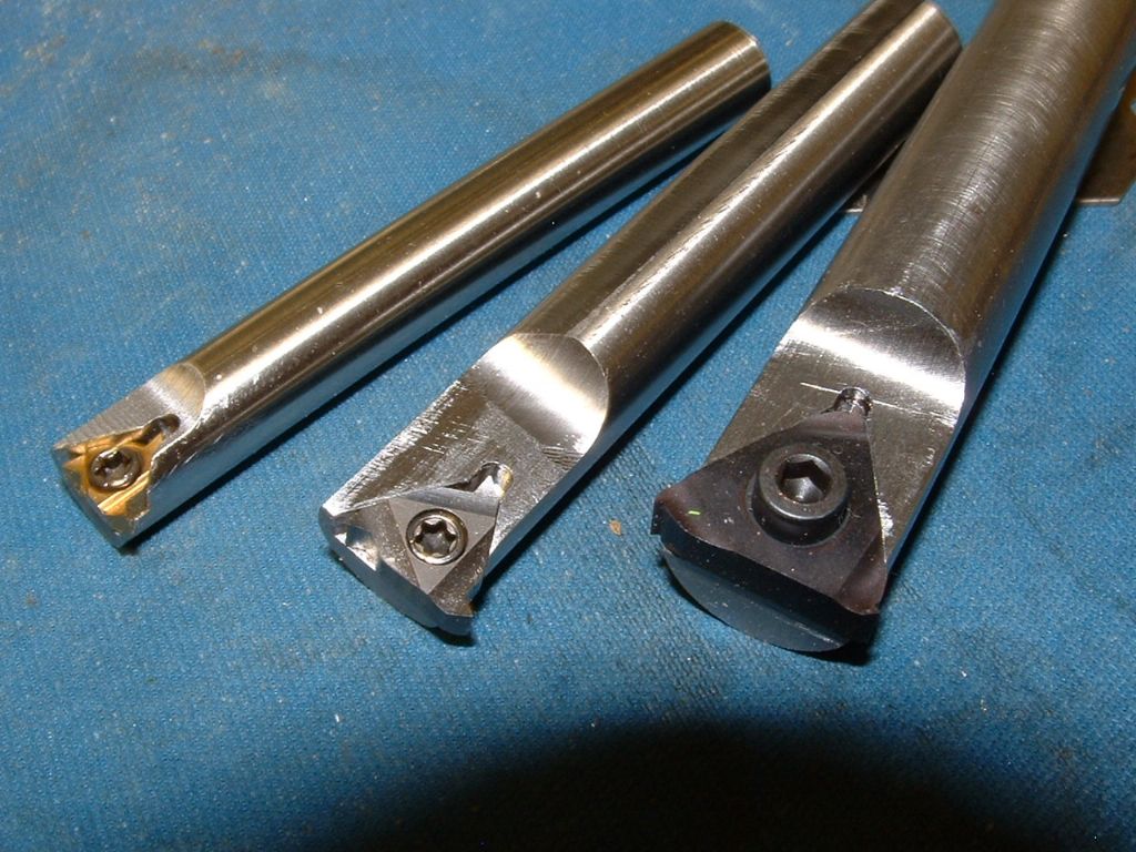

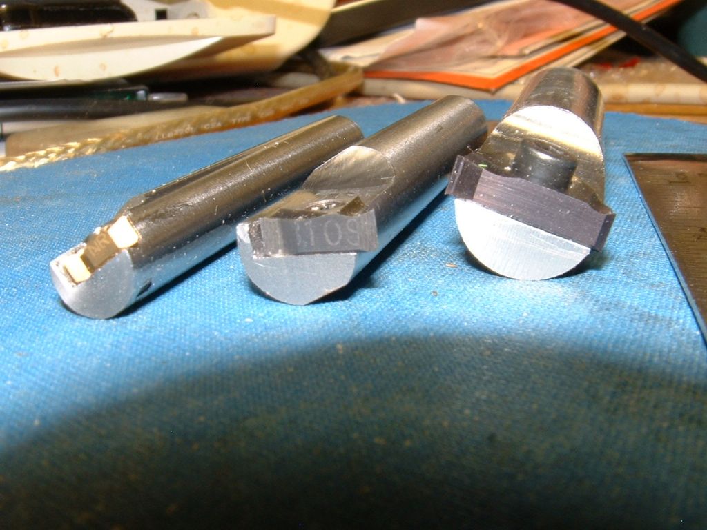

                        Some of the tools I finished today, they are all for internal threading and use commercially available inserts that are available in all thread types and as you are advised full and partial thread forms. The largest tool has a 0.50mm insert the other 2 are just 60 deg cutting inserts that will cut up to 1.5mm threads. I had to make a replacement tool for 12mm ID threads and while set up it was simple to cut the additional 2 tools.
                        The 3 sizes are 08, 11 and 16 and are shown in order on the tools with diameters of 8mm, 10mm & 12mm. The seat is 60 degrees included and cut 30 degrees each side of the tool centreline.
                        Some more pictures in my Album.

                              Emgee, those look good, I hadn't thought about making holders – have you mounted these flat, i.e. zero degrees in the holder? Do you need to worry about helix angles (I may be over-thinking this..!)

                                  James
                                  Because the insert cutting surface is above the centre of the holder when viewed end-on, if the tool diameter will not pass in the bored hole, it will be necessary to rotate the tool in it's holder and cut the thread with negative rake. I haven't found this to be a problem with partial profile inserts, no different to using a boring bar with neg rake.
                                  The N.16 insert is mounted on a 12mm shank to avoid using with neg rake as the tip is full tooth profile, normally the shank for this size insert is 16mm diameter.
                                  The centre tool below has flats top and bottom for use in a standard toolholder, that gives an idea of the tool angle in use.
                                  I normally use these tools in a rotary toolchanger so it is simple job to rotate the tip if required.

                                                  Emgee – what material grade did you use for the holder? Any through hardening?
                                                  #210973
                                                  Muzzer
                                                    @muzzer
                                                    Double post
                                                    Edited By Muzzer on 07/11/2015 00:16:11
                                                    #210981
                                                    Emgee
                                                      @emgee
                                                      Muzzer
                                                      Silver steel for the 8mm and 10mm, EN8 for the 12mm, heat treating the SS today, will use the 12mm as is.
