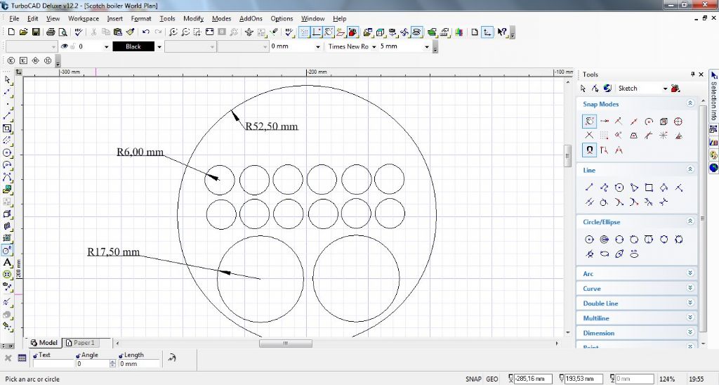

      I am drawing a 4" scotch boiler for gas firing. (1.25 furnace flue, no Galloway tubes, dryback, single return). Probably a "poker" burner vs a blowlamp with a "v" of stainless mesh.
      I am trying to work out the best number and size of tubes.
      KN Harris has 28 5/16 tubes in his 5" boiler.
      When I draw sketches using a 4mm "ligament", I can fit 15 3/8 tubes or 22 5/16 tubes, leaving the top 1/3 of the boiler without tubes.
      The factors that I am interested in include:-
      1. How much difference does the area of the tubes actually make? I can see plenty of internet-land builds with a couple of large return flues. Also "they" say that in locos 80% of the heat transfer happens in the firebox.
      2. How much space should be left above the top row?
      3. will loads of tubes make assembly a bridge-too-far?

              Hi, i has Scotch boiler. Then i can tell you: With large diameter in flue tubes will have larger heat surface. With calloway pipe in furnace will improve the effect of boiler.
              To example the boiler 100 mm diameter and 160 mm length and the boiler is fired with blow lamp:
              Boiler #1
              Furnace: 35 mm diameter x 1 furnace
              calloway: 10 mm x 7 tubes
              Flue tube: 10 mm x 12 tubes
              Total heat of surface: 0,856 m2
              Boiler #2
              Calloway: 10 mm x 7 tubes
              Flue tubes: 15 mm x 8 tubes
              In case: flue tube: 15 mm x 12 tubes will give total heat of surface at 1158 m2
              Best to calculate the heat of surface first before you are planning to make the boiler. Also larger heat of surface will give more steam and short boiling time from cold water to full steam pressure. Prevent to use too thick wall tickness in flue pipe and furnace due loss of heat. I am using 1 mm wall tickness in flue and furnace while the boiler 2,5 mm thick. Insulate the boiler to keep boiler heat enough to produce more steam.
              I will recommend you to buy the book "Model boilers and boiler making" by K. N. Harris, there is a lot of information about boiler and how to design and make the boiler.

                ive got KNH's book . I am comparing his design, for a 127mm dia boiler with 28x 8mm tubes.
                for my 100mm design, I can fit 15 x 10mm tubes or 17x 8mm tubes up to 65% of the height. I could fit another 7x 8mm or 5x 10mm if I went another row but then the steam space would be less and the soldering more!
                i plan to use a 32mm furnace because that suits the local rules better.
                what about 2x 25 mm furnaces? Is there a downside?

                        My scotch boiler is fired with blow lamp. My bolier 105 mm x 190 mm long dia. has double furnace 35 mm and 10 mm x 10 calloway in each furnace + flue tubes 12 mm x 12 tubes. Boiler is a "dry back" type due practical to repair if leakage is occured.  When the boiler got heated by blow lamps and it came weak heat out of chimney without burning my hand when i hold the hand over chimney. Mostly of heat is taken up though flue tubes. It means the boiler is effective to produce steam. The steam engine is a Stuart triple steam engine.
                        There is two alternatives: "Poke" type burner or ceramic burner.
                        And my vertical multi tubular boiler has ceramic burner, works very well.
                        Are your scotch boiler wet or dry back boiler?
                        Edited By Jens Eirik Skogstad on 02/04/2014 06:06:50

                          similar size to my plan. I have 100mm tube and imagined 200mm long.
                          my sketches can't seem to fit as many 12mm tubes over a 32mm furnace as you have managed.
                          What is the spacing between tubes and how much space is there above the tubes?
                          would you be prepared to let me see your sketches (perhaps by a private message if you don't want to post them?)

                            I used the Turbocad when i measured and placed the tubes before i maked the boiler. It is practical to use Turbocad or Autocad when you are planning to make the boiler where you can try and fail to place the tubes in the boiler in case it is possible or impossible to have a lot of flue tube/furnaces.
                            Edited By Jens Eirik Skogstad on 02/04/2014 19:15:03

                              Thanks for the pic Jens.
                              I see that you have your WL about 75% of the way up.
                              How much do think the galloways help?- I am worried that they will limit me to a blow-torch burner and will add to the complexity of the build (especially if they leak!)
                              And- what was your order of assembly – obviously the galloways go in the furnaces first (and then did you test them?). Did you then solder in the flue tubes and furnaces to the endplates, then solder that assembly; or solder on one endplate, then the tubes to that end, then the other end; or solder in both end plates then the flues?
                              Did you use just one type of solder, or different melting points for different steps?

                                No problem with leakage in calloways if you are careful to silversolder the calloways in the furnace. First expanding the calloway tube if the calloway tube is too loose in the hole in the furnace before silversoldering. After soldering is tone, take leakage test with waterpressure to be sure it is tight around calloways/furnace before assembly with the parts of scotch boiler and then silversoldering + boiler test with pressure of water. Best to use difference melting points to be sure the solder is not melting in the calloways when soldering the boiler.
                                I did with calloways placed as a spiral form inside the furnace to distibute the heat oveall in the calloways. Works very well.
