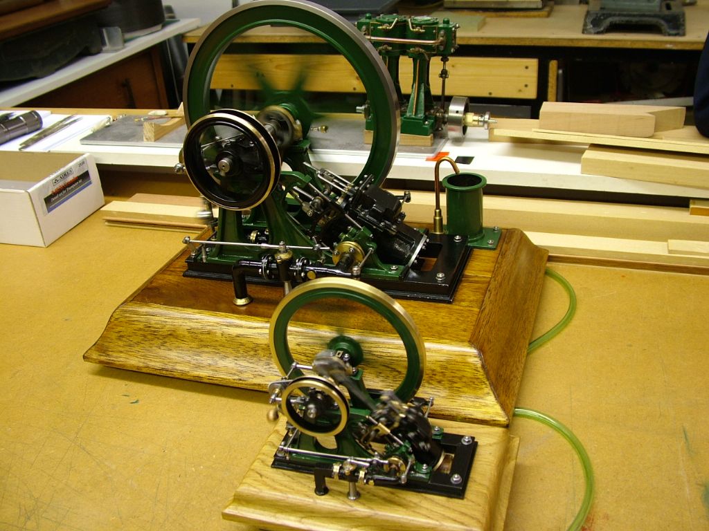

                            I'm afraid I can't agree with that surmising Paul, my good friend Chris Collinson has scaled down a considerable number of steam engine designs to half size all of which work very well if a little fast. As said above though, like myself he works to the dimension and does not change things to suit stock material unless there is no option – that is where matters begin to go wrong as one change leads to another.
                            Here's a pic of his two M'c Onie Oscillators one standard size the other half size
                            and another of his Galloway
                            Scaling does bring issues depending on the amount scaled but it's a well worth objective and does give a personal touch to a project.
