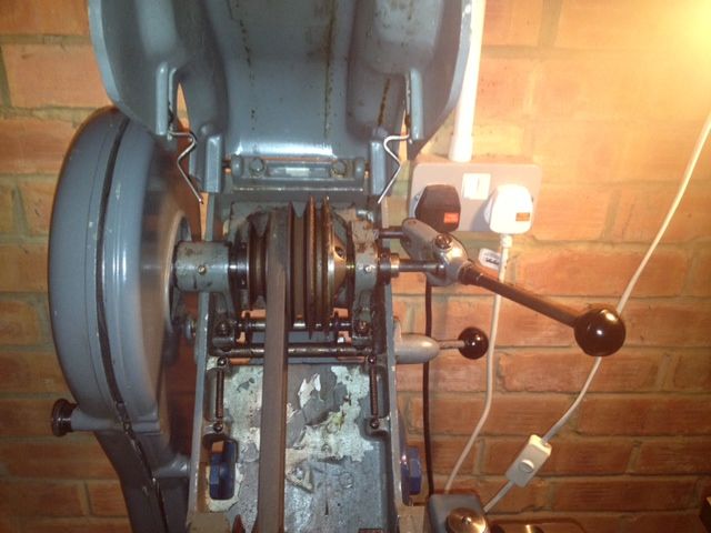

      Okay where to start…

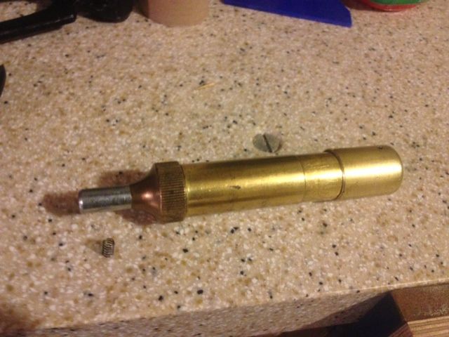

      I am now the proud owner of a Super 7. I am going through the set up and making sure everything it lubricated correctly. The instruction booklet says I hould use nutto H44 on all the nipple points, the lathe came with some Nutto 32 so I tried using that in the grease gun (attached pic). I am a little unfamiliar with this… as I understand it you pump it until enough pressure it built up and then the oil is released. I tried this and it always came out the top all over my hands. When I openeed it up the cork was at the nozzle end, I assume this should be at the pump end? I also removed the spring (pictured) and it kinda works but still not quite how I expect. Can anyone point me in the right direction?
      Do the grease nipples open under pressure or should they have a mechanism to open them?
      My main area of concern is the clutch – This makes a right racket under speed, it very stiff to use and doesn't work all that well, making the spindle still turn weakly. Should I dissasemble the clutch and give it a "service" or should enouigh attention with the lube correct this?
      Thanks all

          That really looks like a grease gun, so won't work very well with oil. I have one somewhere (part of a BSA toolkit?) so will have a look.

                  Thomas, most has already been said and yes the gun you have is intended for grease, most were made by Tecalemite and came with cycles or motor cycles, I have several of these and most were for grease but I do have a couple for oil for cycles.
                  Personally I would bite the bullet and buy one of the late model guns from Myford — not perfect but better than most, but another trick is to place a piece of thin cotton cloth over the nipple and force the oil through this, the cotton acts as a seal between the nipple and the oil gun — an old trick but it works well.

                    The problem with the genuine Myford oil gun, apart from a price of £75, is it has a plain steel nozzle which needs great pressure to maintain contact with the nipple. Great pressure means that the oil comes out before a seal is made!
                    A good one can be had from ebay for less money, and has a soft insert to seal the nipple. I have found these to work well, but won't reach the pulley nipple in the headstock

                      Yes, I don't really fancy forking out £75 for an oil gun but EdH's method does sound rather laborious sorry. I think I will try the one in the link thanks. The brass plunger head on my one is also slightly cracked so probably isnt up to it anyway.
                      Attached a photo of my clutch:

                        You have a Mk1 (expanding type) clutch there. You also have grease nipples on the ends of the shaft instead of oil cups which means your early machine (pre 1956) was fitted with needle roller bearings. There was a mod available through proper Myford for some years after 1956 to fit bronze bushes instead of the rollers and it seems yours never got done. They do rattle but should still function OK. Try injecting a lightish grease and see if the rattle stops/ diminishes. Next, does the pulley waggle about at all indicating the roller bearing inside the pulley assembly is knackered (less usual). Do you have the early assembly manual? I would send you a personal message if I could figure out where the button/icon has gone on the screen, and send you the relevant pages.
                        Can somebody tell me where the PM button has gone?
                        A tight action suggests your cone clutch should have no slip, so something is not right. Do not just try to disassemble it as the countershaft has to be withdrawn through the right end. I will have to fish that history out if no one has the ready answer.
                        The Lautard oil gun is the one to go for. the Myford one works but often leaks from new.

                              The Mk1 clutch is notoriously temperamental, but adjustment and lubrication should sort it out. They are over 50 years old after all.

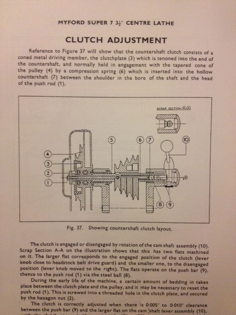

                                Attached the photo of the clutch assembly in the booklet that came with the lathe – but seeing as the serial number of the lathe is SK5874 and the booklet has an email address on the back something tells me they didn't come together cheeky. Is there much similarity between the two however?
                                If Dennis or anyone has the clutch adjustment and assembly diagrams applicable to this model it would be greatly received. Is the mod for the new clutch still available and is it worth it?
                                In action the lathe work splendidly, cutting well and to 1/2 a thou down a 6" bar at top speed, but it is noisy and noise never leads to anything good.

                                      You are correct, that manual is for a later model than yours, and the clutch is completely different.
                                      If you send me a message (message member at the bottom of the post) with your email address I can send you copies of the clutch manual applicable to your lathe. It is not possible to send attachments with a forum message.
