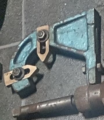

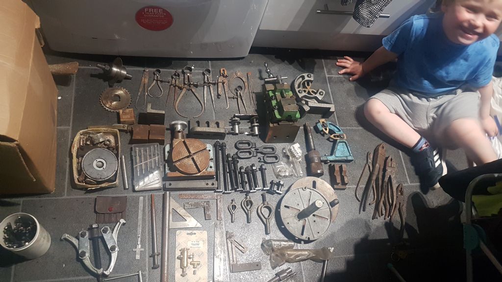

        Hello, I recently bought a job lot of rusty tools, the reason for buýing them was this lovely bunch of tools that were hidden amongst the pictures.

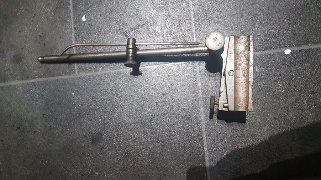

        There is also a marking out gauge which I was wondering if this was featured as a build in ME or if someone could identify the maker.

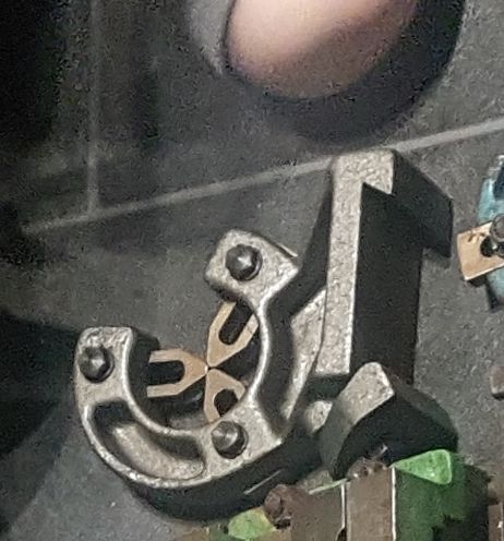

        The fixed and travelling steady are up for sale if anyone is interested. As they are for an ML10 I believe so won't fit my ML4.
        How do I go about cleaning the rust off the surface of the tooling?
        Lastly what is the other faceplate with a spigot on it, anyone used or have one of those as I've not seen anything like it before.

          There are quite a lot of threads already on here about rust. If you go to the website front page, not the forum front page and use the search box there it will come up with some. Quite a lot of options but for this light rusting ignore the brick/patio cleaner options.
          I think the spigot o the faceplate is not part of the original and just fitted for quick mounting in a 3 jaw. The faceplate itself looks like a Picador one or one from a drill powered wood lathe.

                        At first sight I thought the faceplate could be from GHT's UPT.
                            That's what I was wondering……I remember seeing pics of it before.
