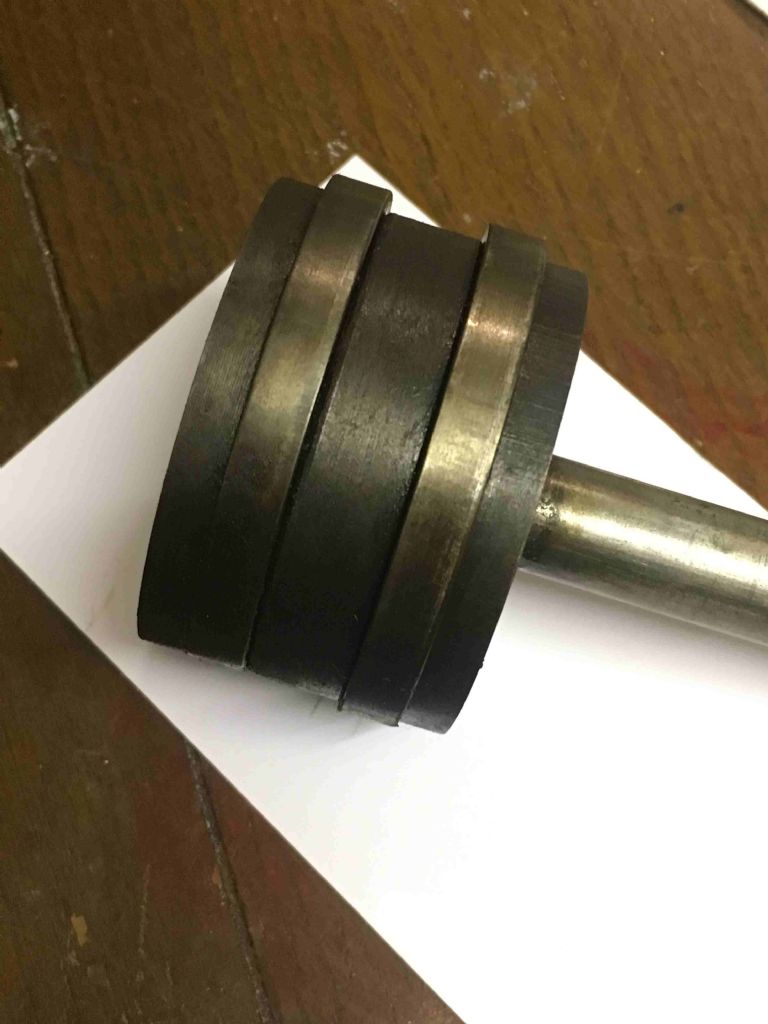

      As you do, just starting to look around the engine and doesnt seem to bad, well so far!
      Why are the piston rings so broad?
      Its got a 2" bore, the piston is 1.25" long overall but the rings are 0.236" (6mm) wide, 0.123" and very difficult to compress so I would imagine create a lot of friction?

          Tubal Cain wrote a very long article explaining that steam piston rings only need to be very light compared to those for IC engines, backed up by tests and calculations he showed that many models with rings 'to spec' were wasting a large part of their power on ring friction, presumably with extra wear. This may have helped power the shift towards using viton and teflon rings.
          Bear in mind he was an authority of diesel engine design (as Tom Walshaw) so he knew a thing or three about the subject.

            I think I would be inclined to use Graphite packing rather than rings of that section, packing can give a good seal over quite a long period. Mike
            #369607
            duncan webster 1
              @duncanwebster1
              The article in ME by Tubal Cain had lots of imsprints, but I've got a paper copy if you need it. For one of my locos (1.5" bore) I made the rings 0.045" square section to TC's instructions and they seem to work fine

                        Considering that full scale Diesel engines (around 75 Kw and upwards) use just three rings (two compression and oil control) about 3 -4mm wide, for cylinder pressures and speeds much higher than our model steam engines, it ought to be possible to use quite narrow rings on a model. In that way, friction losses should be minimised.
                        As already said, PTFE rings will reduce friction, compared to metallic rings, and temperatures are not going to be high enough to risk the PTFE degrading.

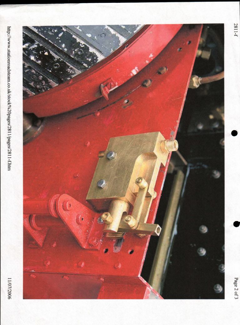

                                The blurb from Winstons mentioned a hand pump but nothing fitted or found with the box of bits that came with it, does your have one?
                                Would certainly like to fit one but not sure of size or if drawings or even casting are available. Saw this very neat neat pump on another engine of a similar size. Never had any dealing with small steam engines so lots of learning!
                                Peter

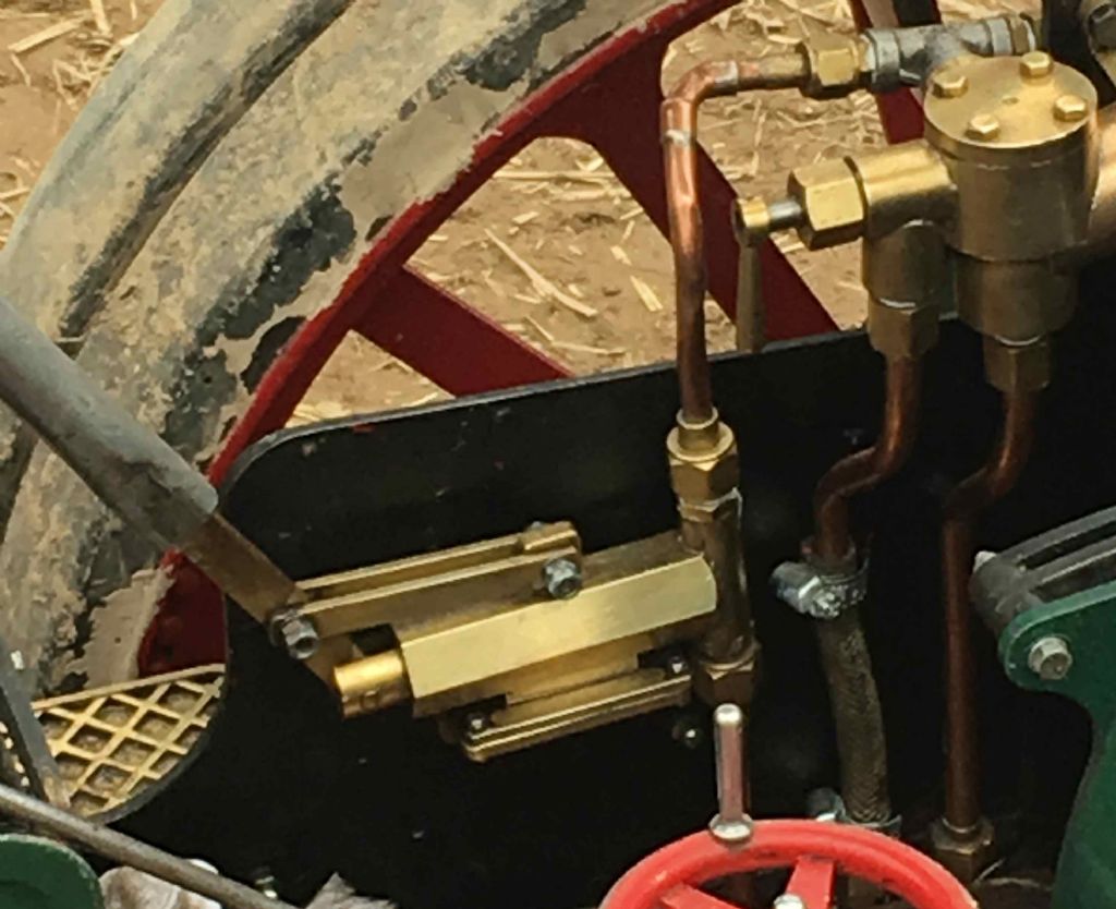

                                  As to a hand pump……… Yes I have one fitted, it is mounted within the water space of the tender under the coal space. I have an aluminium 'box' that sits in the coal space to hold coal with a rubber sheet glued to the underside of the box forming a seal against dirt falling into the water space through the slot for the pump handle. The bypass for the crank pump is routed to the same position so I can see if I wish too that the pump is operating. The hand pump is teed into the crank pump delivery pipe downstream of the bypass valve so to use it the bypass must be closed.
                                  Is it any good? Well that's subjective! My opinion is it is only really useful for filling the boiler from cold or for pressure testing it. I have never been in the position where either the crank pump or the injector have both let me down but from the rate of delivery of the hand pump I would say it's worse than useless for normal running and only any good as a last resort get you home emergency measure! The pump itself I would say is original Winson as like most things they did it is carved out of a solid block! It's a tee shape if I remember correct probably an inch thick slab, milled down in places, about half inch bore and probably about 3/4" stroke. I will have another look another time and see if I have any pictures of it. You don't need a casting to make one though if you want to fit one, you could follow Winsons lead and mill from a solid block or silver solder fabricate. The Winson drawings I have show it bolted to the outside of the tender behind the LH rear wheel (dreadful idea if you want the engine to look reasonable!). I am now building a 6" engine and not bothering with a hand pump at all on that!

                                    Peter,
                                    Found this picture of the hand pump mounted as per Winson plans. This is my engine / pump but from a previous owner before I rebuilt it and put the pump inside the tender. I think the picture is a print from Station Road Steam info according to the info at the side of the page, it came to me as hard copy print with the engine so I hope there are no copyright issues!
                                    Hand pump
                                    Paul.

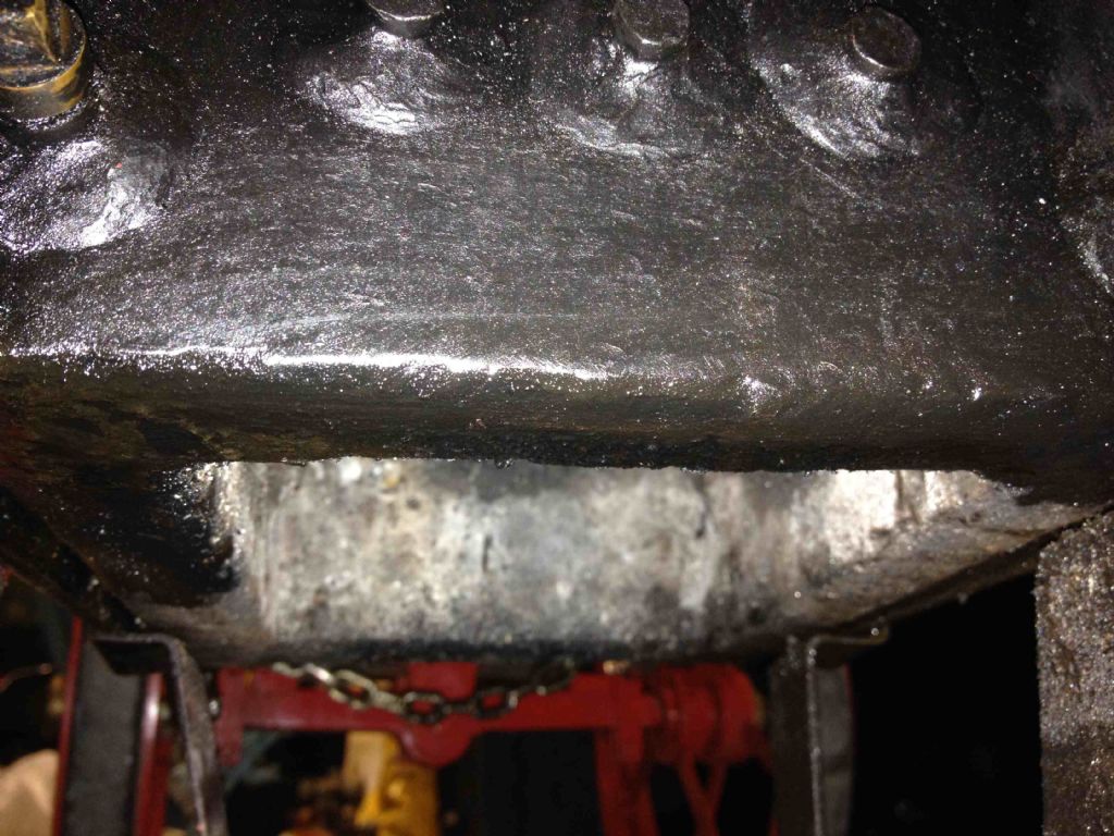

                                      Paul,
                                      That's brilliant, thanks! Can just about make your stampings out.
                                      Looked at the back of mine again but no numbers as per yours, so the hunt continues, see pic. I suppose all will be revealed when we dismantle and remove the boiler to get it tested.
                                      I have had a suitable lump of brass that would do for a pump laying around for years so could copy without needing to silver solder/fabricate. It just feels so helpless not being able to top up the cold boiler easily. Ours has complicated looking bypass valve mounted where the pump could go so expect we will need to alter the plumbing to suit.
                                      Sounds like you've really got the bug if a 6" is on the stocks!
                                      Peter
