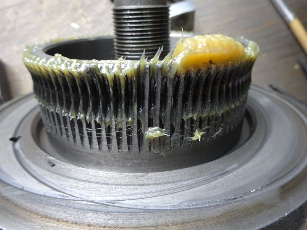

      My 6" rotary table was made by Yuasa, not one of the cheap clones and the worm gear wheel was damaged while doing a rotary cut.
      A replacement worm wheel was ordered from Yuasa in America for $195.
      The rotary table performed as new after the new wheel was replaced but has broken again while doing a rotary cut with an 8mm dia cutter on a 75mm radius using light cuts to reduce the load. Care was taken to ensure that the worm and wheel were fully engaged.
      I have been advised by the technical department at Yuasa, USA that:-
      "this unit is not able to make curved cuts it cannot make curved or circular cuts it must be locked down completely".
      Many of the cheaper clone brands are made with a similar construction and therefore should also be completely locked down and only used when stationary.

          Posted by Paul Lousick on 10/08/2016 00:01:58:
          'Gobsmacked' is the only expression that immediately comes to mind!
          Am I missing something about RTs? Something that I don't know? (Well, there's a lot that I don't know, but…)

            I had never heard that a Rotary Table couldn't make a curved or circular cut. I often do that on mine, and so far without trouble. It is some time since I checked the worm gear on mine, but the worm gear looked fine then. After looking at your RT it makes me wonder what kind of material it made from.

              Climb milling or conventional? I might just understand the failure, if the former.
              Doesn't look like a very wide contact area for those wheel teeth (only a small diameter worm?). It strikes me that perhaps the worm is fully hardened and rough, while the wheel is in a softened state?
              Not a lot of point for a rotary table if it must always be locked down – might just as well use a simple dividing plate?

                  John Stevenson 1
                    @johnstevenson1
                    Don't care what they say that's just pure bad design.
                    OK you expect this from Chinese and Indian tables built to a price but a helical gear in cast iron making point contact is crap.
                    At one time if you paid your money you could get RT's with bronze wheels of an enveloping design, designed to take the load.
                    If this is what Yuasa is now turning out you are better just buying Chinese or Indian and saving your money. There is no difference in design.
                    When I used to to the shows with ARC demonstrating the CNC we used to run for 5 whole days with one machine on 4th axis work all that time.
                    Usually 8mm cutters in steel

                              Comparing the pictures Jason's and the OP, the OP photograph shows serious lack of lubricant with much CI wear particles and bent teeth on the wormwheel. Just a trace of grease on the extremities of some teeth (lower right).
                              Did OP remove the surplus grease before the photograph? The teeth appear to be seriously overloaded and bent.

                                            I wonder if the teeth are as deep as they should be because they look rather shallow cut compared to jasons, the typical radial relief to the center seems to be absent too, it should be able to handle this kind of wear and still work.
                                            What shocks me the most is just how much has been scraped off. The cutting must have been really hard going to dig into the table that much. Is this machined grey cast? I wonder if it should be steel.
