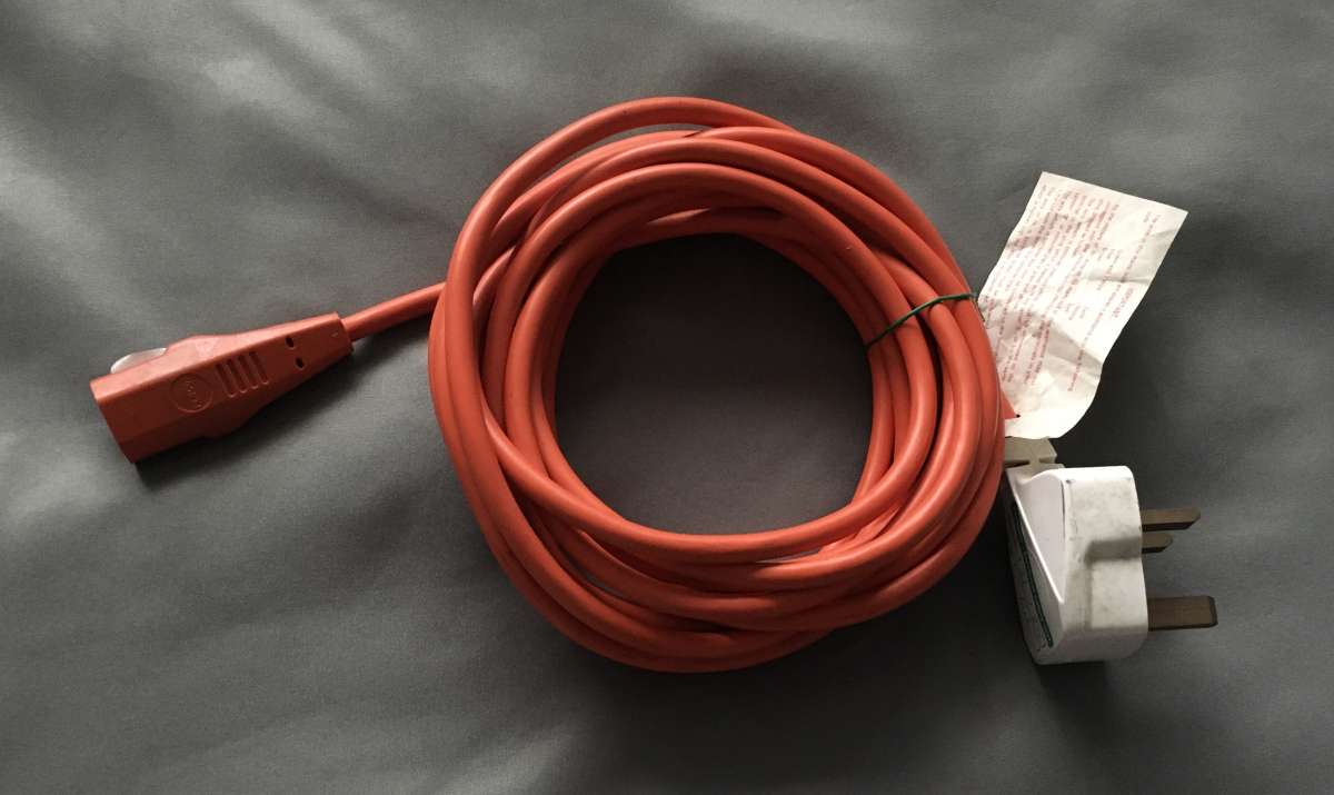

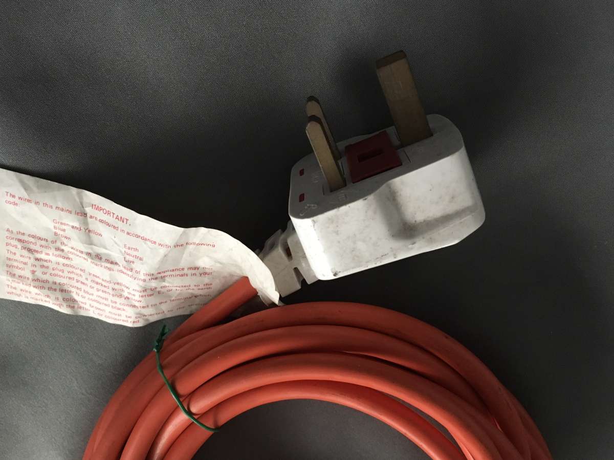

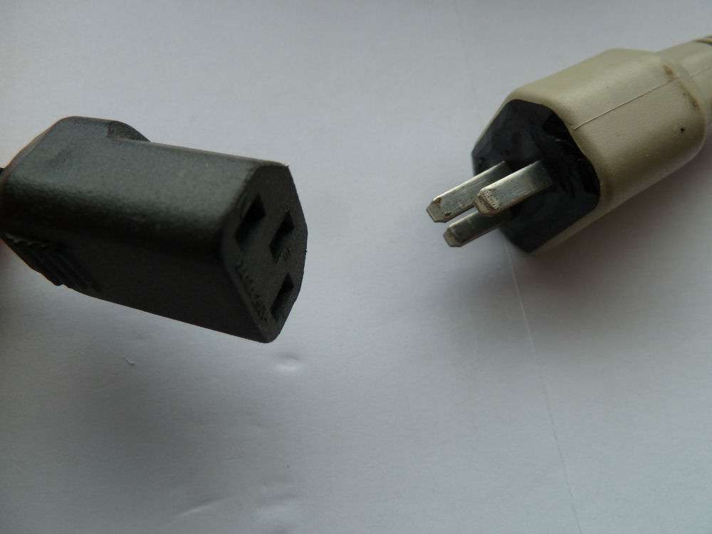

      I bought a rather nice, and usefully long ‘kettle lead’ today … from the Charity Shop
      Resplendent  in Orange, and complete with a recent PAT sticker.
      Having made it very clear to the shop assistant that I was happy to purchase said item … I then explained to her why it should not have passed testing.
      The manager was called to witness this, and the offending item was duly photographed for discussion with the testing-chap.
      The fault was that the Live and Neutral pins on the 13A plug were full Brass.
      … Two ladies educated, and perhaps a life saved.

        Not sure how long the previous spec for all brass pins, being the only approved spec for a 13 amp plug. Maybe 60 years or more?
        Now that type of plug is regarded as being highly dangerous. Took an inordinate time to realise this!

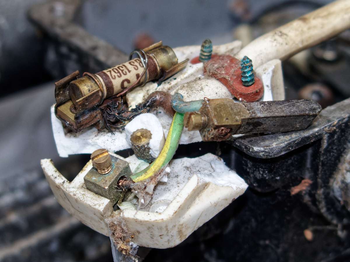

            This was one attached to something I bought a couple of years ago, assured it was working fine and PAT tested.
            I had to use a Warrington screwdriver to access the “fuse”

                Hi, to say plugs with non-insulated live and neutral pins are dangerous, is not strictly true, they are considered to be unsafe for use by children and people with slim fingers, as it is possible for them to be able to touch both live and neutral pins upon inserting and withdrawing these plugs, when the pins are still in contact with the electrical supply. If they are used in a socket that has a switch on the live side, the risk is almost eliminated, as long as the switch is used  for disconnection the live side, before inserting or withdrawing the plug, and I would think they are more unsafe for use in unswitched sockets.
                If you have anything with these plugs fitted before the regulation was changed, there is no obligation for you to change them, and there is nothing to say you can’t fit one to your own appliance that you use, but if you sell or give it away with one on, you may find you are breaking the law. You may also find yourself in trouble if others in your household, suffer injury or death while using these plugs. Sockets with switch or not, can still be unsafe to children and adults, as they can have a screwdriver of something similar, poked into the earth slot, to open the shutter to the live slots, which would allow other objects to be poked into the live slots, so these in themselves are not 1009% safe.

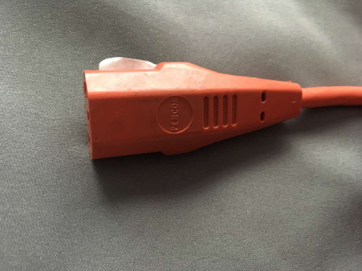

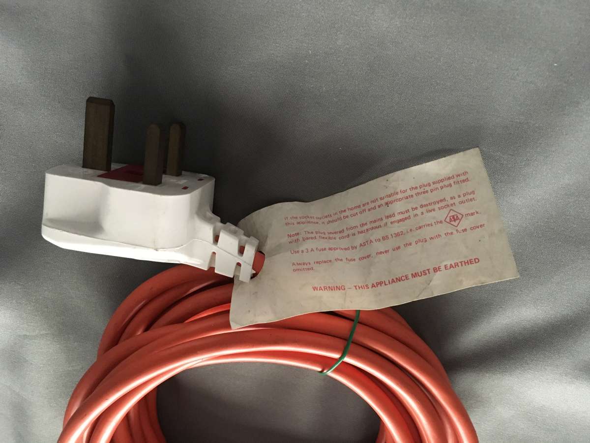

                              As promised:
                              IMG_0570
                              IMG_0572IMG_0573IMG_0571

                                Not correct Nick,
                                It’s not primarally about small finges touching pins, it about conductive objects touching the pins and a person or two pins causing a short. Metallic objects include jewelery like chains and believe it or not table knives (people trying to remove tight plugs). And in direct context to our hobby SWARF
                                It is illegal to fit a unsleeved plug as a replacement part even for you own use. It beggers belief that you would even consider doing this. Why would you? To save a pound or two buying a new plug?
                                It is illegal to sell or give away an item with an unsleeved mains plug.
                                Well done Michael for dealing with this. If anyone wants some training on this (now called Inspection and Testing of Electrical Equipment” (ITEE)” not PAT) there is an online course here :www.onlinepattestingcourse.co.uk/pat-testing-course/
                                It needs an email address (you can put a rubbish one they don’t confirm it) and concentrates on their tester but is otherwise OK.
                                The visual part of the check is most important.
