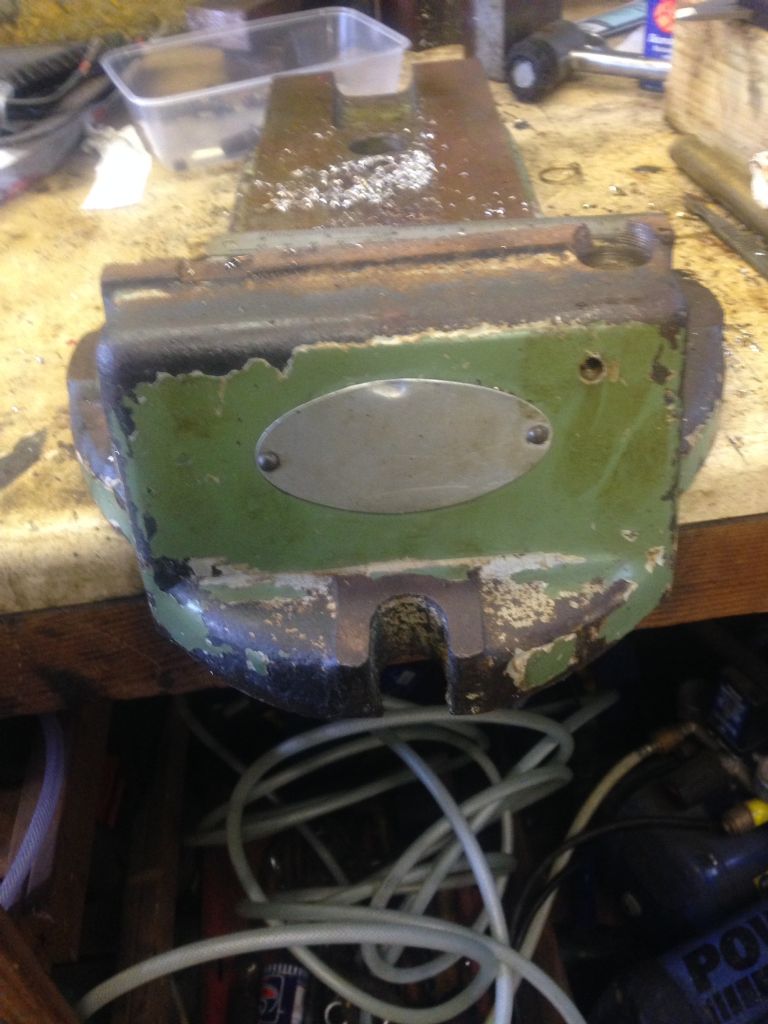

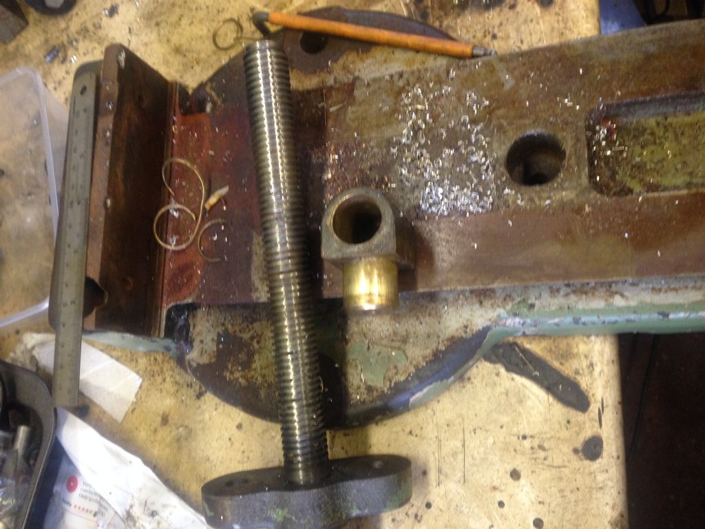

      image.jpegimage.jpegHi
      I have been given a broken milling vice as I do not have one. It is 6inches and although a bit on the big size for my 8inch by 32 table ( amadeal AMA30 ) it's seems to be a good solid piece of kit. However, the threaded nut inside has stripped. I'm looking at options. One is to buy a chunk of brass? Bronze? Leaded bronze? And make /cut the thread I need. ( as well as the boss etc)This seems quite a daunting task to be honest. Could I just buy a suitable nut and then just modify/ make the boss? I then saw on eBay trapezoidal rod and nuts. Maybe I could replace the whole rod, modify the nut so it sits at the right height and go that route. I am trying to tread a path between a beginner trying to push his skills (a bit ), a new hobbyist who wants to just get on with some milling, and someone who has run out of money to throw at his workshop for a while! ( so don't say just buy a new one! Any wise words will be gratefully received. Maybe some one will recognise the vice if I can manage to post the photos.
      Thanks in advance

        jason udall
          @jasonudall57142
          Trapezoidal thread isn’t magic..it is basically a truncated ‘standard’ thread…
          ..infact many cheap G clamps use metric threads.
          For a one off taps and dies for what are called acme threads (closer to square section than trapezoidal) are probably a waste.
          Frankly using metric ( or whitworh or unc or….) conventional screw threads will suffice until you feel they don’t
          #228869
          jason udall
            @jasonudall57142
            What I am basically saying is get some studding as big as fits..make nut to couple with slide..
            ..then as time/skill/tooling/frustration( with less than gold standard job)/pride dictate replace with nicer /better job

            Keith Matheson
              @keithmatheson47708
              Wow, thanks Jason, what a great idea. Eminently doable and as you say I can easily go back at a later date and do a more elegant job when time and skills allow. This way I can have a working milling vice by the weekend!

              John Reese
                @johnreese12848
                1. Use a bearing bronze. Brass will not last.
                2. Single point the threads on the lathe. Not that difficult and good experrience. Tooling cost is negligible.
                3. Make a short lead in diameter that matches the OD of the screw. When the point of the tool just marks that diameter it is time to start testing the fit using the screw as a gauge.
                Years ago on my first day working in a machine shop, the nut for the top slide stripped out on the lathe I was using. As I recall it took about 4 hr. to reverse engineer the nut, scrounge for material, and finally make the part.
                To save time you might try silver soldering a bronze sleeve into the existing nut, then threading it.
