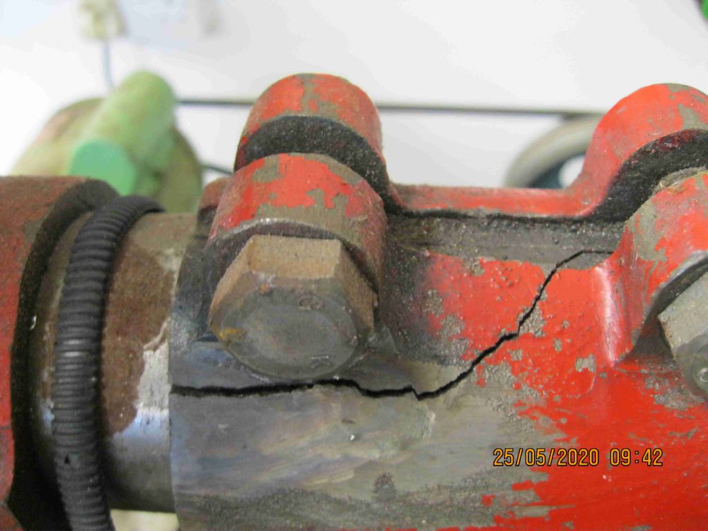

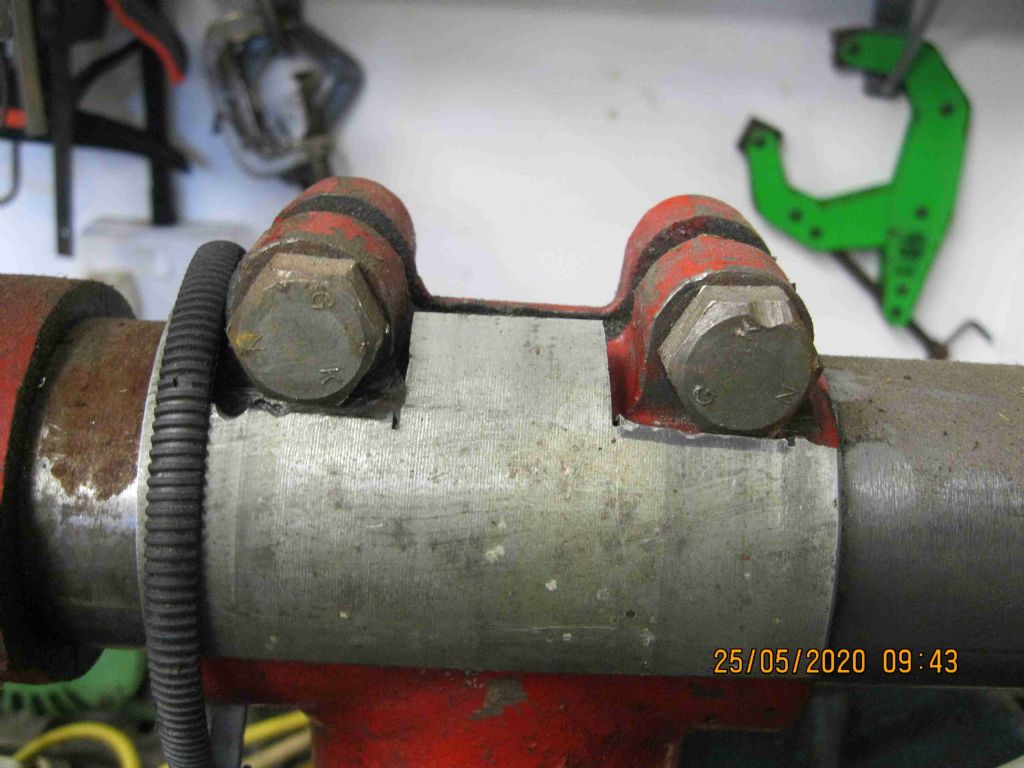

        As shown in the photos below, my D-W has developed a crack in the motor/head tube support. 'The Gods' were with me, in that I had a steel tube of a very close matching inside diameter which I have mangled into approximate shape.
        Question is – which is the best/most 'do-able' fixing method. I have 2 stick welders and a Lidl's mig jobby, but have never welded anything! 2 part epoxy used to be touted as suitable to repair diesel crankcases and screw attachment would be limited by the thin underlying structure.
        Suggestions gratefully received.
        TIA

          Plenty of joint area there which helps.
          I've done satisfactory repairs to cast iron with ordinary stick welder rods using the old fashioned, field expedient, puddling approach. The basic process is to create a nice wide Vee in the joint area for easy access and lay down multiple, thin layers of weld metal using a thin rod at the lowest practical current. During cool down the weld area should be aggressively peened with the chipping hammer. Once you have a reasonable build of weld metal you can finish off with a more usual, but still small, size rod and current. Still can't do it in one hit, two or three layers on a joint like yours I'd say, and aggressive peening during cooldown remains essential.
          My practice is to do the small rod build up bit first then leave for an hour or so to ensure its all properly cooled down.
          Theory is that the initial multiple thin layers pretty much isolate the joint proper from any carbon migration and associated brittleness. Aggressive peening stretches the weld surface minimising stresses due to contraction.
          All goes much better with a good inverter welder than with a buzz box because you can reliably operate at lower currents. I'd have just Vee'd out the original crack and stuck it together. But I've done it before a time or three and my little Fronius welder is really good.
          If you have a choice use the most ductile breed of ordinary rod you can find. Never, ten thousand times never, use "proper" cast iron welding rods. These must be used on preheated castings and the instructions followed exactly. I recall a friend being given a couple of such rods which he used with disastrous results. Stuck together OK but massive lumps everywhere and harder than a woodpeckers beak. An angle grinder would barely touch the stuff. Knowing him he'd got hold of something really exotic for super-strength repairs.

                      I had an old-style Myford countershaft unit that had completely cracked across one arm. I took into college and the welding instructor SIF bronzed it – producing a very strong (but not exactly pretty) repair. As I think I've related before – he did swear a great deal during this process (which was something he did a good deal of anyway) but I gathered it didn't go that smoothly at first and that possibly I wasn't his favourite student either…
                      From what I recall – it was a two part process – he first heated the part up to red-heat, let it cool somewhat and then reheated and brazed it – all using Oxy/A of course. A highly skilled man.

                        The inherent tendency to crack under cooling stresses due to material brittleness, made worse by carbon migration, inevitably makes cast iron repair rather tricky. Especially when taking into account oil absorption, cast iron tends to be slightly porous, on older items of machinery. Not to mention free carbon in really old or really cheap samples.
                        But for minor repairs there is a tendency to overthink things. The professionals use pre heat and special rods, or sif bronze, to get a good reliable result fast. They have the experience and skills to get it right too.
                        If you take your time and work carefully the puddling technique works fine providing the job isn't too big and you don't have ambitions for high tensile loads. Personally I avoid anything likely to take significant tension by design. If the one piece part broke then odds are a weld won't do better, maybe not as well. Do remember that back in the day puddling was an officially approved technique. But its dog slow and has some limitations of application. So if you have preheat and slow cool facilities its not viable.
                        Darned if I can recall what the first job was but the second attempt was a similar fracture to yours on the banjo pinch bolt of a SouthBend Heavy 10 many, many years ago. Worked just fine. Still in one peice when I sold the lathe 10 years later.

                              Your Dore may have had the clamp made too slack for the tube, hence the over tightening.
                              The thing with cast iron rods is there are several types, all have a percentage of nickel between 90% and 99.5%. The lower % makes them cheaper but the resultant weld goes very hard. Weather preheating would stop that I cant say.
                              I've found cast iron welding easier (less sticky) than normal rod welding and once you get a good layer of nickel rod on both sides you can get away with a switch to steel rods.
                              Use 99% plus.
                              Personally I would carefully consider remaking the clamp in the correct size from steel tube and weld new ears on it.

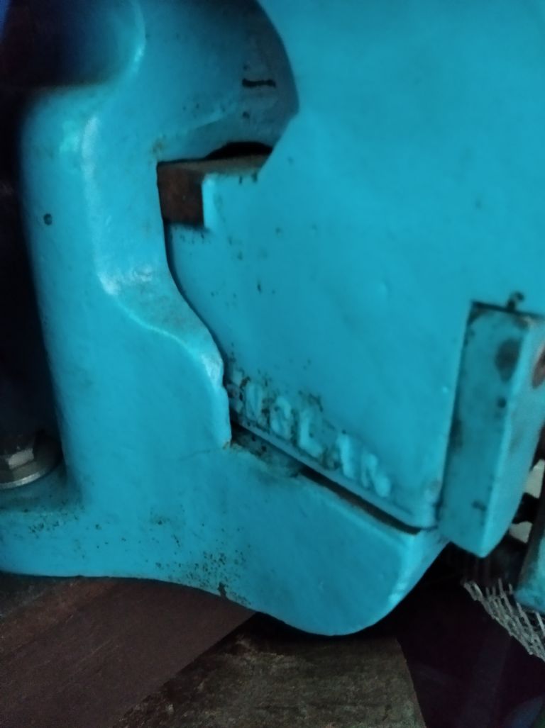

                                              I welded this vice, if you look where it says England, going diagonally up to the machined surface, the whole front of the vice snapped off (not me, I pulled it out the skip at work) it was a nightmare, I wouldn't do it again for love nor money.
                                              I think brazing is the way to go.

                                                Thank you Pete. If I thought that I could produce a result half as good as that I would be a very happy bunny – sadly, I see it as very unlikely. Still waiting for a reply from Araldite but I get the sense that the adhesive companies (for obvious reasons) will be more concerned with commercial enquiries.
                                                rgds

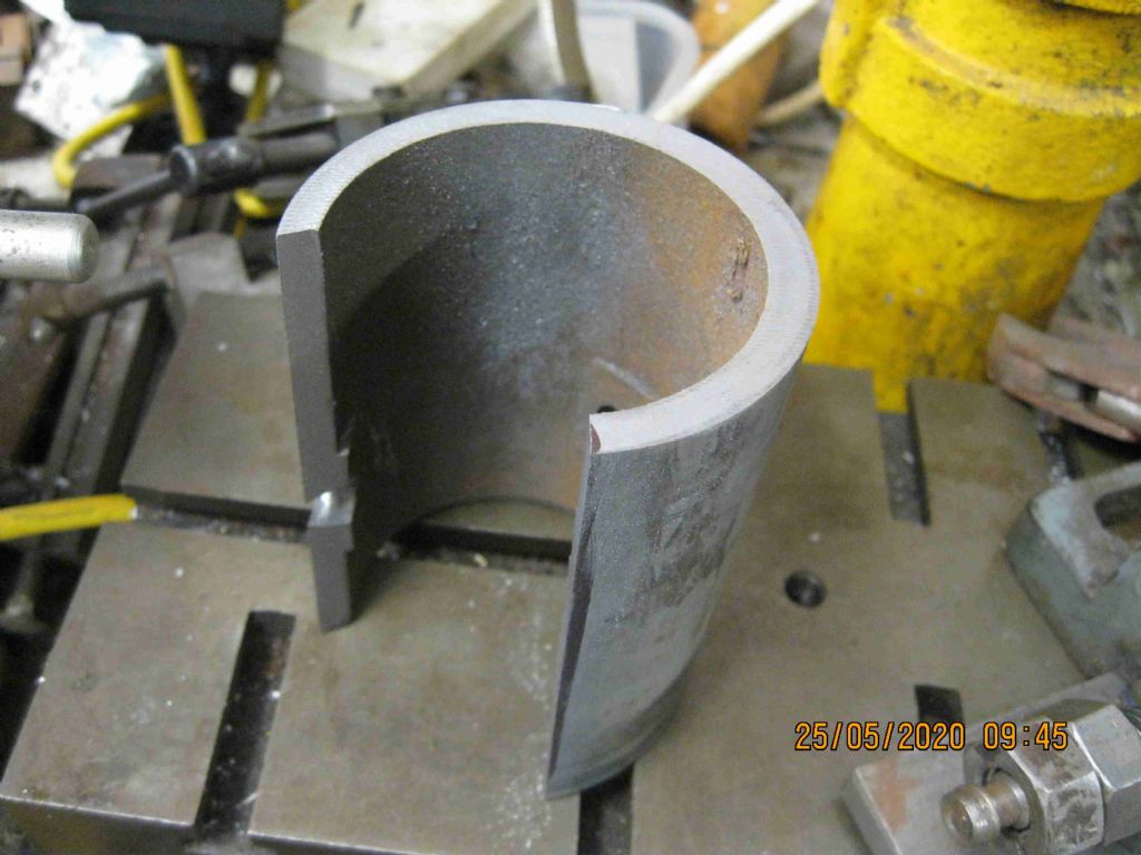

                                                  The casting cracked because of an excessive tensile load at that point.
                                                  Will an adhesive have a greater tensile strength?
                                                  If you have a lathe with a large enough capacity, you could possibly make a replacement from a block of steel.
                                                  A flycutter will mill the faces that need to be flat. A boring bar will produce the bore. A slitting saw on an arbor, between centres, with the job held on the Cross Slide or Toolpost, will produce the split. A similar set up of the job will allow the drillings to be made.
                                                  Not necessarily an easy or quick job, but not impossible.
                                                  And being steel, less likely to crack in the future.
                                                    Howard
                                                    If the item is a stand alone collar + necessary clearance/capacity the no reason it can't be made from two pieces of rectangular bar and bolted top and bottom…no need for slitting saws or milled faces.. Function over aesthetics…just bored and drilled.
