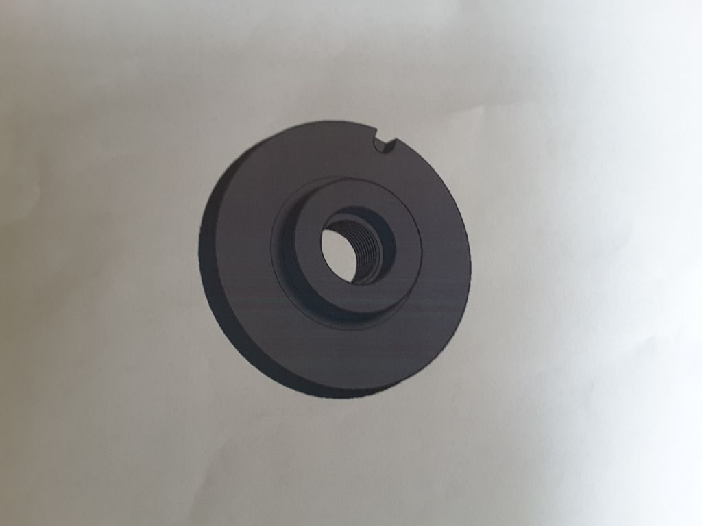

                          On my lathe I have a notch for a C spanner which if hit with a small mallet removes the Chuck. As it is in the back plate it dosn't alter the chuck which a spanner on a jaw or on a piece of hex bar can if as like my chuck it is screwed on with 6mm screws. No load on the screws just directly on to back plate and less leverage on the spindle. Do not in any way use the back gear as the gears will be damaged. Just hold the spindle pully etc and a sharp tap on the C spanner will get it free.

                                                  FWIW here are some pics of my Myford ML7 spindle lock spanner, cut from a piece of 6mm aluminium plate. Can't remember if I drilled and tapped the bull wheel and threaded the pin I added to it, or if it is a light press fit and a drop of Loctite.
                                                  No that's not a crack from the hole in the bullwheel, it's scriber marks from laying out for drilling. Gave me a heart attack when I first saw it!
