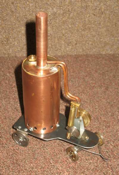

        David George 1
          @davidgeorge1
          You could try a simple steam engine from Steve's workshop.
          http://www.steves-workshop.co.uk/steammodels/simpleoscil/simpleoscil.htm
          I made it a while ago and if is a good project.
          David

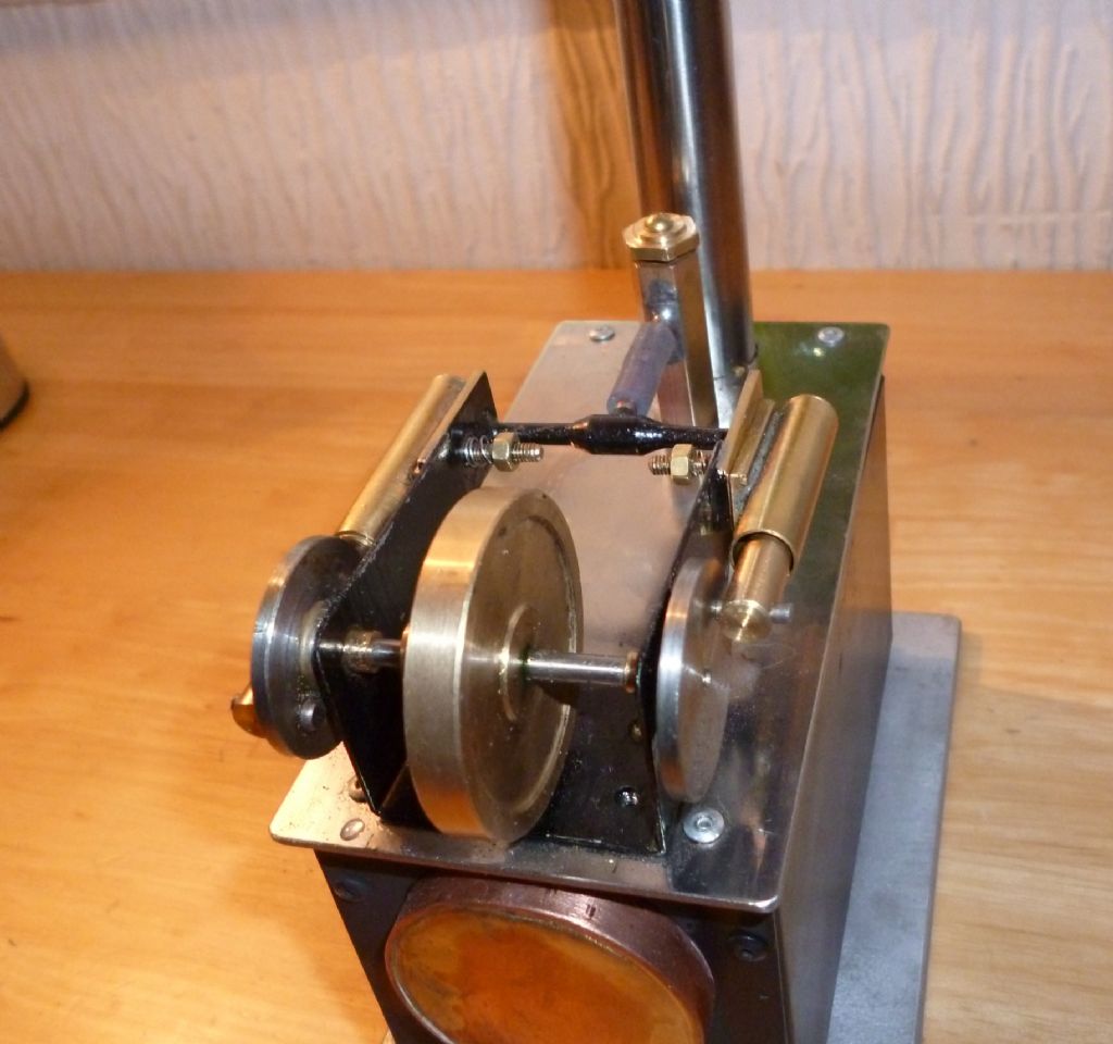

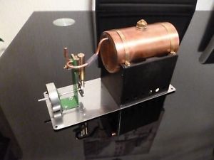

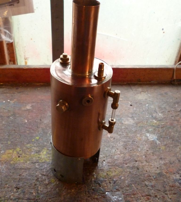

              #525610
              Hubert Imright
                @hubertimright59493
                #525611
                Hubert Imright
                  @hubertimright59493
                  #525612
                  Hubert Imright
                    @hubertimright59493
                    #525613
                    Hubert Imright
                      @hubertimright59493
                      #525614
                      Hubert Imright
                        @hubertimright59493
