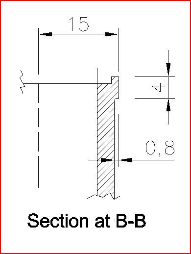

        A member has raised a number of points about the drawing of the crankcase shown on page 159 issue 4474. Most can just be put down to drafting standards, several I saw the drawing a different way and explained to the member how I read them.
        The one main item is what has happened to section B-B, this does contain two dimensions that can't be deduced from whats in Fig 2. I know it was on Ramon's original drawings so did it get lost between Greece and MTM towers?

        #145864
          Ramon has provided the section that was missing from the magazine, here it is.

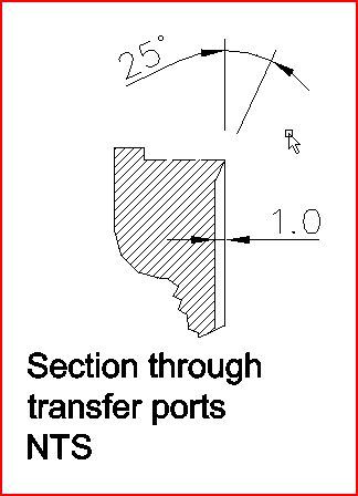

          And I've also included a larger section A-A to show that the 25deg angle runs out to the edge of teh liner bore top edge.

            Hi there,
            Following an email from Jason, I've just become aware of this post and the omisssion on the drawing.
            This appears to have been an error on my part – the original drawing has it but somehow it has removed itself from the drawing submitted to ME. Though I checked and treble checked the drawings before sending them off my apologies for not spotting it. I'm not making excuses but noticing your own mistakes is difficult especially after long hours at the computrer staring at the same thing over and over. I make no apologies however for the fact that I'm more a machinist than a writer .

              Hi Ramon/Jason
              Thanks for clearing this up when Jason first posted the query I went back into my records and had a good head scratch, I'm not familiar with the working of this type of engine so failed to pick it up when I checked things through, so I guess I contributed to it somewhat.

                Ah! can I assume from that you were the proof reader Stew wink
                Having checked through the drawings published so far I see I have omitted a dimension on the rotor disc.
                The angle between the drive hole and trailng edge of the cut out should be 40 degrees …..

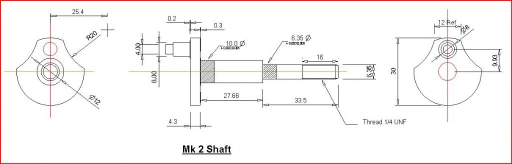

                  Just to pre-empt anyone asking in part 4 of the series the Mk1 prop driver shown in Fig 6 should show an overall length of 15.8mm. The 19mm and 24mm ends can be assumed to have a 1.2mm length before joining the curved part.
                  The crankshaft for the Mk2 shown in Fig7, ignore the 16mm radius line shown on te rear of teh web as that relates to another version of these engines

                    I think the 2 micron (0.002mm) fit limit for the crankshaft bearings is a bit ambitious. I would have a job to turn to that limit let alone measure it.
                    #147070
                      I think we should all be grateful that Ramon has given us some tollerances to aim for as that is something that is seldom seen on ME drawings as confirmed in a recent thread.
                      Where are you seeing the 0.002mm, I can only see 0.003-0.005 shown?

                        0.003 to 0.005 is 0.002 is it not?
                        Don't get me wrong i think his motors are brilliant and i may have ago at sometime. I was just thinking it must be a drawing error for a tolerance that tight which would be very difficult to machine too or am I missing something.

                          0.002mm? That's several wavelengths of light, you should be able to SEE the difference
                          #147119
                            Got you now Paul, I thought you were looking at +0.002 written on the drawing not taking the difference between the two. Yes its quite a narrow range and a bit tighter than most ISO limits which would be say 0.006mm to 0.01mm between the max and min on a shaft of that size.

                              Hi Jason, Paul et al,
                              Despite that best will in the world errors, ommissions and downright mistakes can and do get made. I put my hands up – I'm not infallible!
                              I have updated the crankhaft drawing and emailed it to Jason who will hopefully post it here later.
                              Regarding the tolerances on the crankshaft – Yes I agree they would be too much to expect to be able to turn to – they are after all more realistically a grinding allowance but they are on the drawing as a guide to the kind of fit required for the bearings. If you check the text you will see reference is made to 'polishing' the diameters down in the areas shown so as to give a light hand push fit. The bearings do not want to be over tight on the shaft as this can lead to brinelling and ruined races. I do not have access to cylindrical grinding – all the machining of the engines made so far has been carried out on a Super7 lathe and my quite old Linley milling machine and all this kind of work is done by hand using nothing more than wet and dry carborundum paper stuck to a flat surface (a parallel) with double sided sticky tape. By having the paper stuck to something flat a far greater degree of control is able to be exercised and using parafin as a lubricant prevents the paper loading up though it can lead to the sticky tape gradualy releasing.
                              Where measuring is concerned I use nothing more than a Mitutoyo 0-25mm mic which reads to 0.001mm on it's vernier scale. Whilst that is somewhat variable at such fine measurement it does never the less give you some indication as to where you are at such fine limits – the rest is then down to 'try and see'.
                              As Jason says these engines do require close limits particularly as above and as said on the piston and liner fit but all are achievable using basic kit with a degree of forethought and careful approach.
                              Once again, I hope that's useful, allays some fears and gives a degree of confidence for any prospective builder of these small type of engines if not specifically the Eta's. If I can be be of assistance to anyone then please do PM through this forum or MEM

                                Thanks for the insight Ramon and here is the revised Mk2 Crankshaft drawing, click for a larger view.
