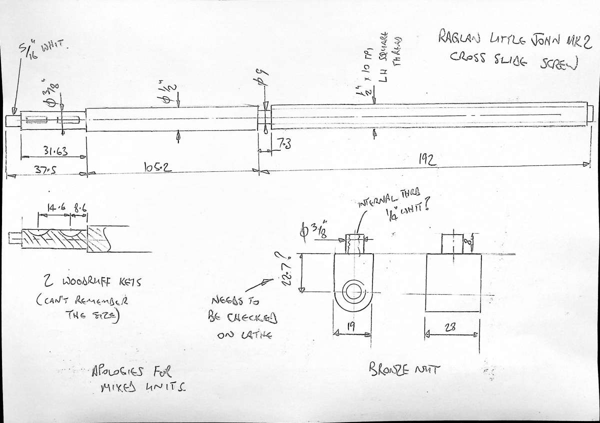

      Hi I been asked to make a feed screw and nut for little john lathe so I am looking for a drawing for Ragland little john feed screw and nut as I would like to make one as the original one is missing so I have no pattern to make it from
      thanks in advance for any help
      Kim

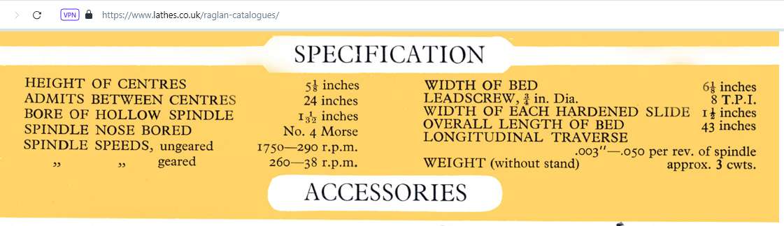

        peak4
          @peak4
          From Tony’s site about the leadscrew, but I’m not sure if you mean the cross slide screw or the top slide one
          image_2024-07-16_172720103
          Hard to tell from the photos, but it looks like it’s a RH thread
          image_2024-07-16_173031381
          The half nuts might be a bit more tricky if they are completely missing
          image_2024-07-16_173216621
          Bill

          Howard Lewis
            @howardlewis46836
            Atre we talking Feedscrews (for Cross and/or Top Slide) or Leadscrew?
            If Leadscrew then the diameter (3/4″) and thread pitch (8 tpi) is on Tony’s Lathes website, as posted above.
            What will then need to be ascertained is Right or Left hand? and the thread form.
            My guess would be Left Hand, possibly square.
            Since the original post said “nut” that sounds like a Feedscrew.
            A Leadscrew would need half nuts.
            Howard

                Kim Garnett
                  @kimgarnett94824
                  Thanks for the replies the lathe in question is a little john not sure if mark 1 or 2 its the main cross slide which is left hand thread 1/2″ x 10 tpi not the top slide. The thread is a square thread which is no bother to cut for the screw or the nut but the information I need is the rest of the dimensions ie O/L length, diameters shoulder lengths gear fixing any keyway dimensions etc hope this helps
                  Kim

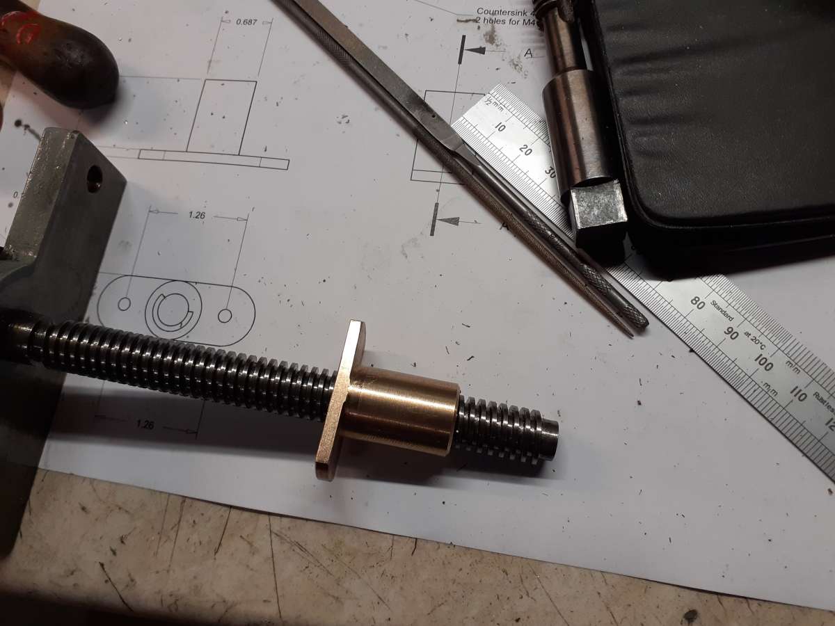

                    Most lathes of this syle should be square thread 10 TPI RH. I use silver steel for my lathe a M Type Myford lathe with same size thread. If it had a LH thread you would have to turn the handwheel in the wrong direction to every other lathe. For the nut I use phosphour bronze which I screw cut to size and then use a tap I made to just run through to check size.

                    #741845
                    David Senior
                      @davidsenior29320

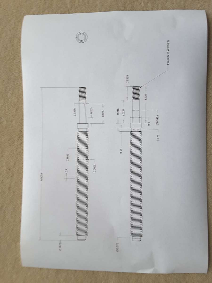

                      A quick sketch of the cross slide screw and nut for a LJ Mk2
                      This is assembled from my notes from when I was replacing mine some years ago.
                      The distance from the centre of the thread to the mounting face for the nut needs to be checked on the job.
                      Hope you can read it and it is useful

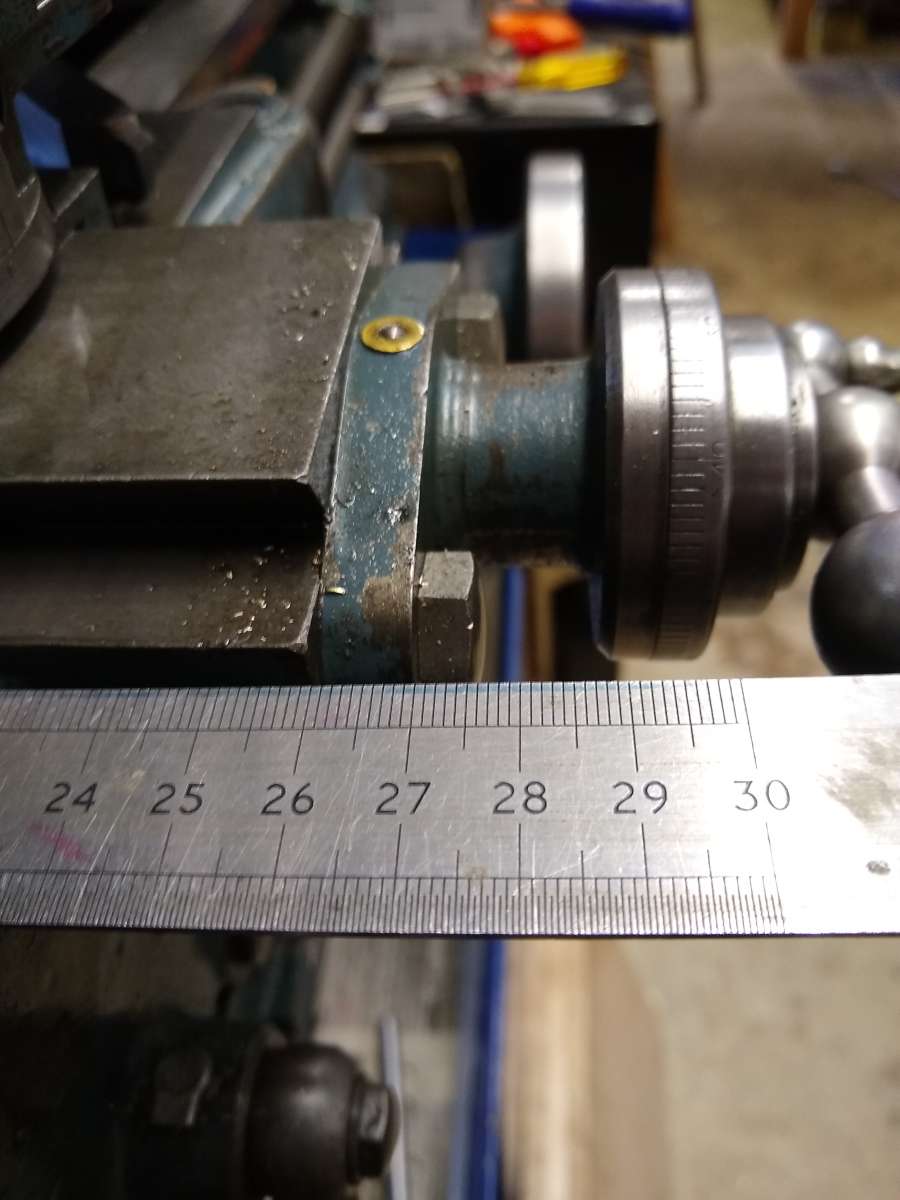

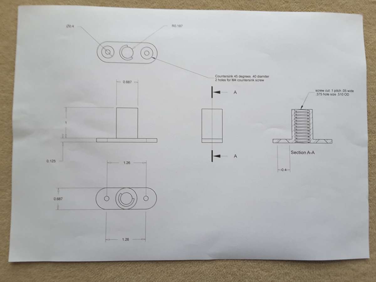

                      Mark Easingwood
                        @markeasingwood33578

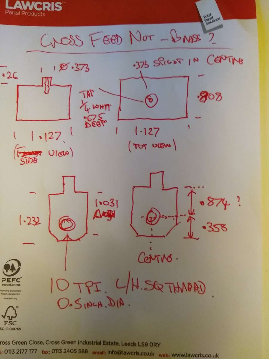

                        Hello,
                        A rough sketch of the nut on my MK11, taken a few years ago.
                        IMG_20240717_205822535

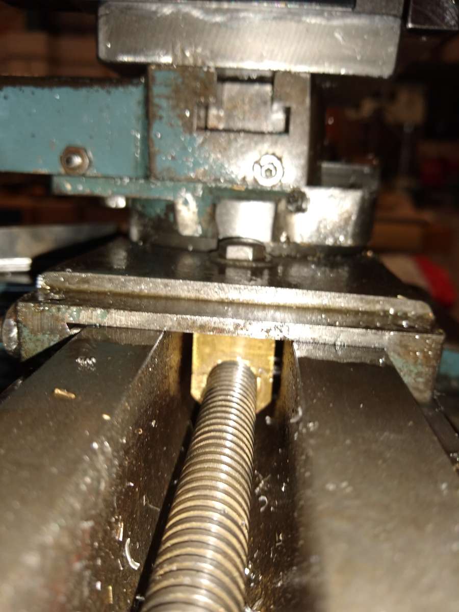

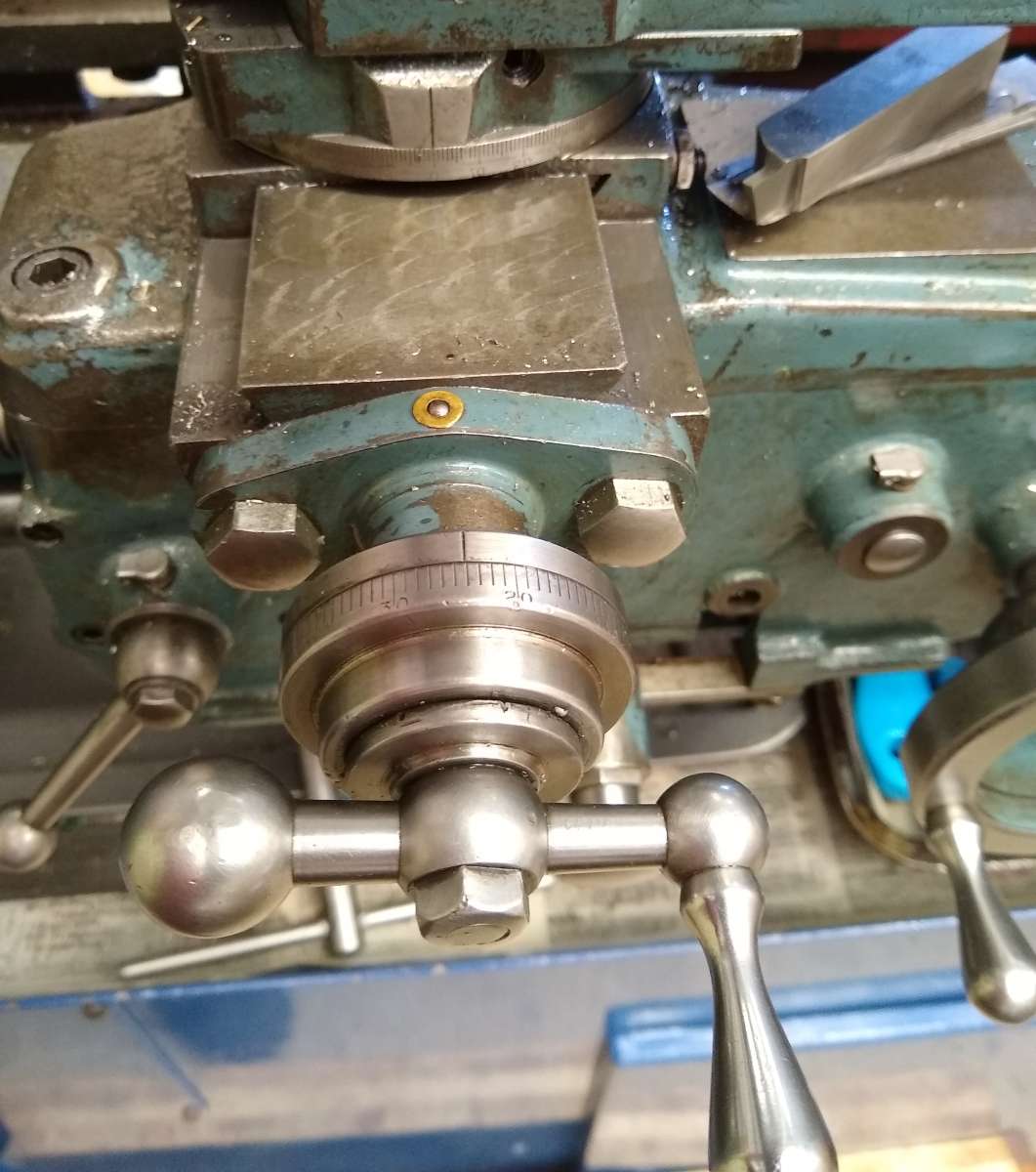

                        As said above the distance of the threaded hole to bottom of crosslide is the only important measurement required, the body of the nut just needs to be free in the channel. I haven’t measured the screw, but the length doesn’t matter much, as the channel in the carriage is open ended. 10 tpi. 0.5 in dia, sq thread Left Hand.
                        Some pictures, IMG_20240717_155439630
                        IMG_20240717_155057737
                        My Lathe has the short crosslide, some lathes have a long crosslide.
                        I am in East Yorks, if you want to come and look for yourself, you are welcome.
                        Mark.

                        Mark Easingwood

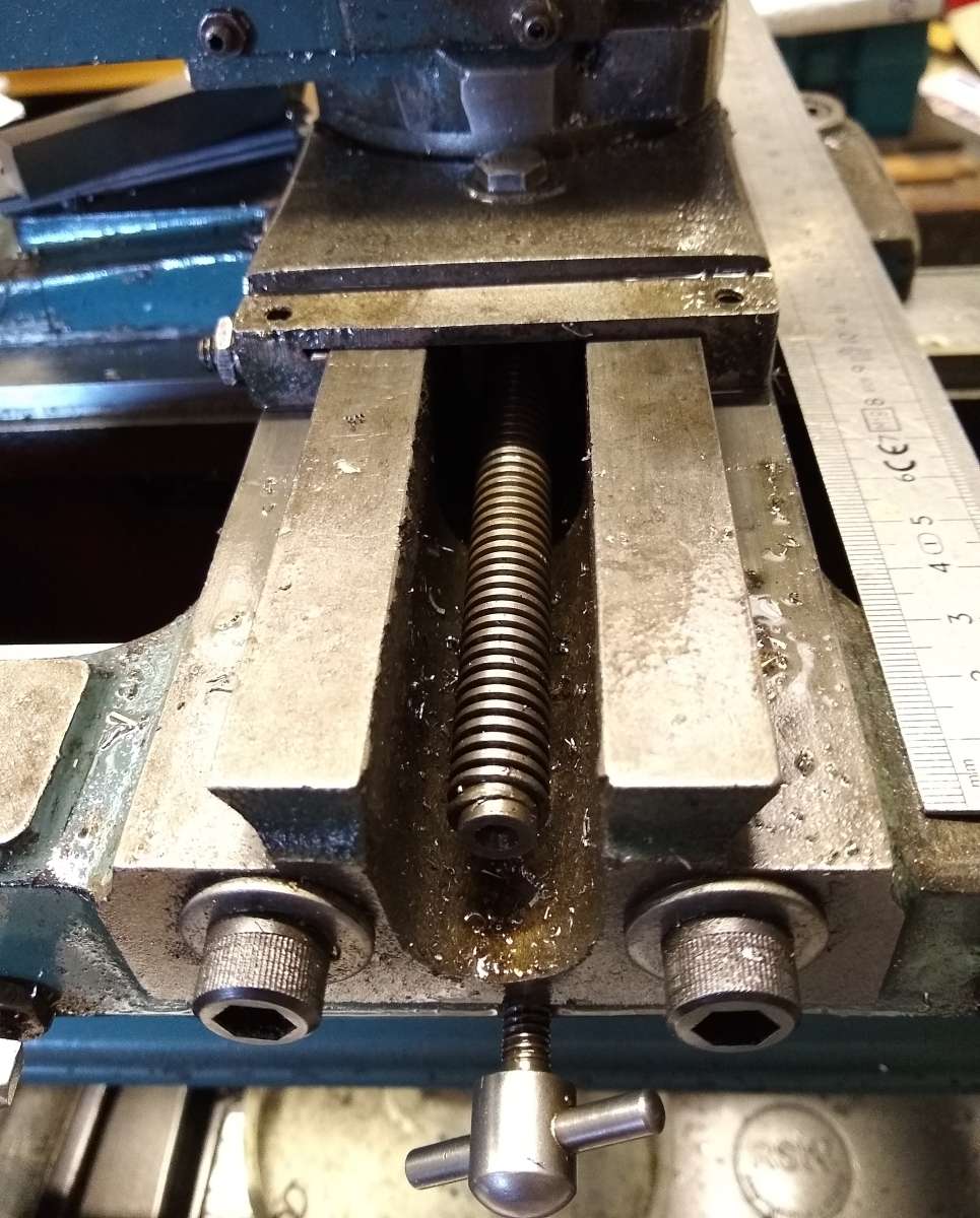

                          A couple more pictures, they refused to load earlier!!
                          IMG_20240717_154640858
                          IMG_20240717_155153909
