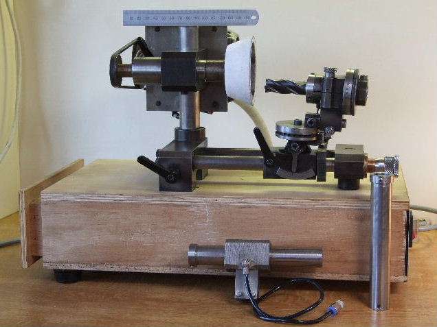

        I posted my example of a Quorn recently on another topic.
        It is a scaled down version where 1 mm equals a 1/16″ on the original. It still uses the same motor but the wheels are attached using the Unimat 3 Spindle Nose dimensions, i.e. M14x1 thread.
        Scale model of a Quorn tool and cutter grinder
        I have in recent years done away with the swivelling action around the front bar. I now have two linear guideways to traverse the tool in front of the wheel. I have also added an ER 25 spindle so that I can use collets. The item in the foreground is an air bearing for doing the flutes of cutters.
        Hope this helps.

            Graham Meek
              @grahammeek88282
              Hi Baz,

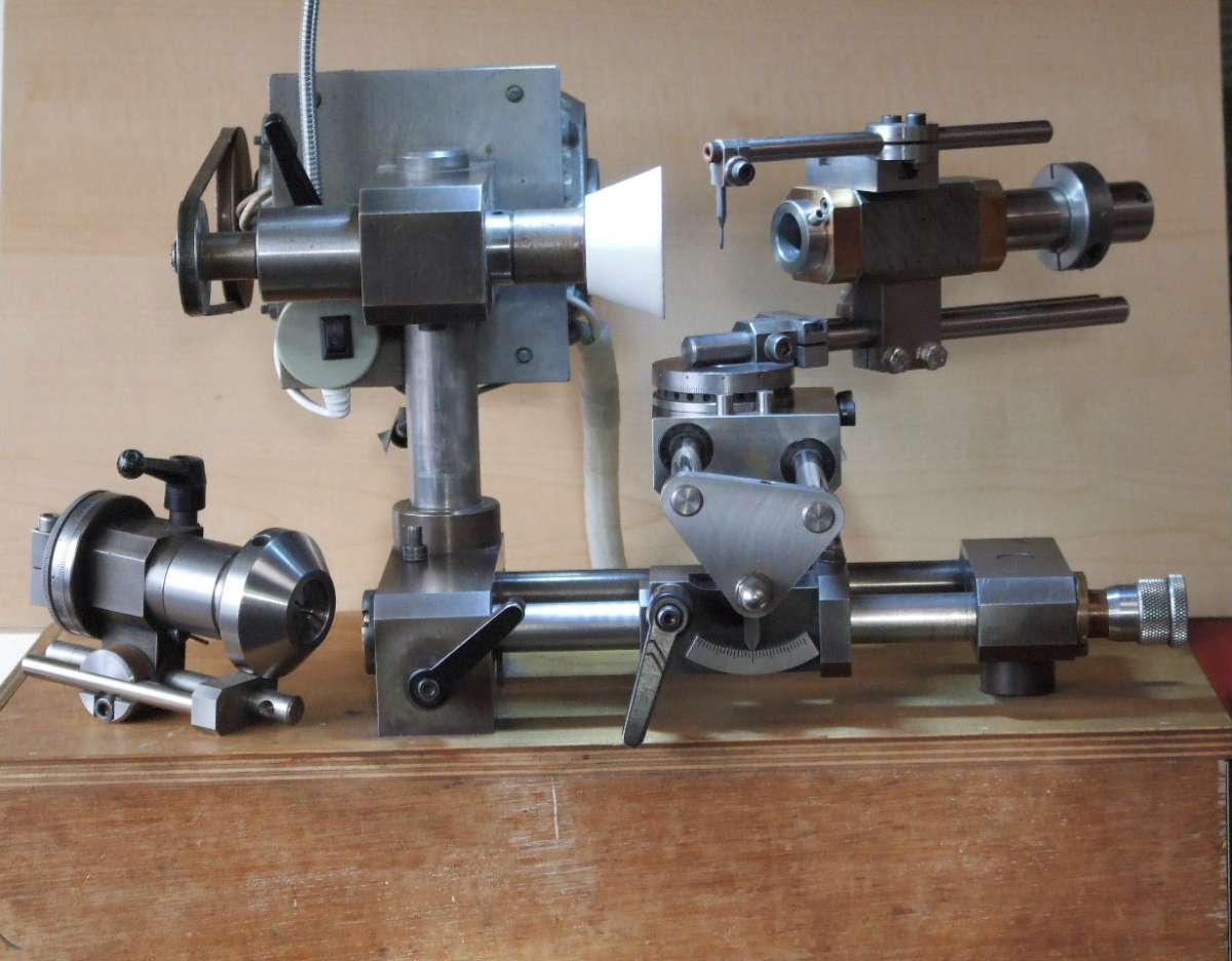

              For once the Sun is shining and I have managed to take a couple of up to date photographs.
              Quorn Mk4
              The Work Heads now have an additional guide rail so that the setting is not lost should the work head need to be moved to or fro.
              Quorn Mk 4A
              The two work heads are held with a single M5 cap screw. Which re-aligns the work head so no settings are lost. This also shows how the additional guide rail works. The guide rails can if needs be, be removed in seconds
              The Air Bearing has a annular clearance of about 0,025 mm or 0.001″. The design of this was based on an article which appeared in Home Shop Machinist. I think the author was Philip Duclos, but I am not sure on that.
              In its original state shown in the first photograph the air consumption was too great for my workshop compressor. To slow down the loss I added two Phos Bronze end pieces. These have an annular clearance of 0.001 mm about 0.0004″ and they also have a Labyrinth Seal incorporated in them. This is now run through a regulator at 40 PSI and the compressor hardly cuts in during a grinding session. The loss of drag when the air is on is very noticeable.

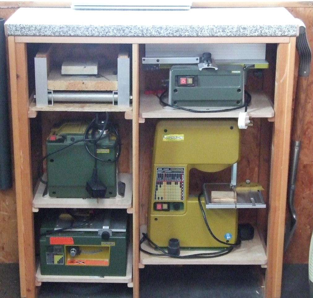

                                  Thank you for your kind words and appreciation of my work. Having been friends with George, and lucky enough to have him as a Mentor. I know first hand what he was capable of. For myself I do not consider to be in the same league as George, but I thank you all the same.
                                  As regards my future hobbies they will revolve around Woodwork and another recently acquired gift from an old friend of a No 10 Meccano Set. Woodworking was my first hobby and has always been in the background. Meccano started my interest in Engineering, so I guess you can say I have now gone full circle. This latter hobby allows me to stay indoors during the cold months. This is something I have come to realise I need to do health wise. Plus I want to add Radio control to my work, something I have had nothing to do with in the past.
                                  Woodworking Shop storage
                                  Apologies for hijacking the post.
