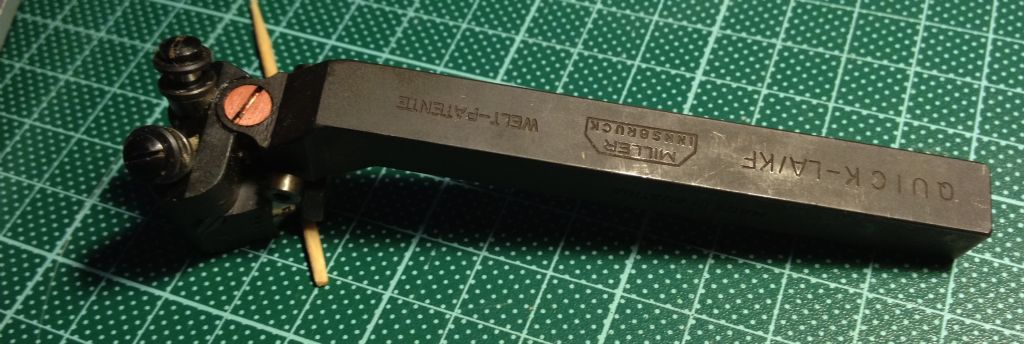

      I have scored a quick LA/KF knurling tool from the bay.
      http://www.brw.ch/shop/produkte/index.html
      here it is at enormous cost. I need some rollers. Can anyone direct me to the type for a bog standard diamond knurl. I may be doing titanium so I thought
      these
      http://www.brw.ch/shop/produkte/detail/index.html?t_ProduktNr=475240
      not sure about the division or the version tho.
      Tips on how to use it would be good too.
      quick LA/KF

        Ian S C
          @iansc
          Just been looking on google,quite a bit there, had a look through a catalogue, very interesting. The rolls are made from poweder metalurgical high speed steel, they require special bushes and side cheeks, and that tool of yours will knurl fron 1.5 to 12 mm dia, the pitches are; 0.3/ 0.4/ 0.5/ 0.6/ 0.8/ 1 mm. The rollers are 8.9 mm dia. Ian S C

              Terryd
                @terryd72465
                From your photograph the side cheeks and rollers appear to be there. The 'Knurl Rollers' on the site appear to be priced each (I presume you have clicked on to the English translation of the page) without any additional parts.
                BTW the prices are in Swiss Francs not Euros and as Switzerland is non EU, UK VAT would have to be added to the prices. So a pair of knurls from the manufacturer would be around £46 +VAT.

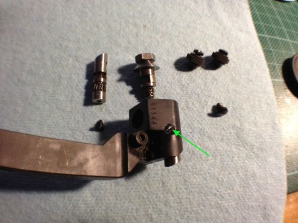

                    #104636
                    capnahab
                      @capnahab
                      At last I have sourced the knurling wheels. In putting them on I have upset the (very complicated) set up for adjusting the wheels.
                      the instructions for use are here
                      http://industrieprodukte.swarovskioptik.com/en/gb2_infos-news-information
                      But there are no isntructions for setting it up.
                      I have two problems , the screw in the side of the main body (arrowed) is stuck and has a narrow shallow slot.
                      once I get it out I am not sure how to reassemble it so the rotating the adjuster nut works with the cams on the knurling wheel sleeve.voila_capture708.jpg

                          #104656
                          John Stevenson 1
                            @johnstevenson1
                            Why did you strip it ?
                            The wheels just fit on the ends of the axles.
                            It's a bitch of a job to get these back together and timed up, as you feed the worm shaft in it rotated the axles so you have to set them 5 teeth advanced to start with.
                            #104695
                            capnahab
                              @capnahab
                              Thanks John , I know
                              I didn't purposefully strip it , – the adjustment was jammed .
