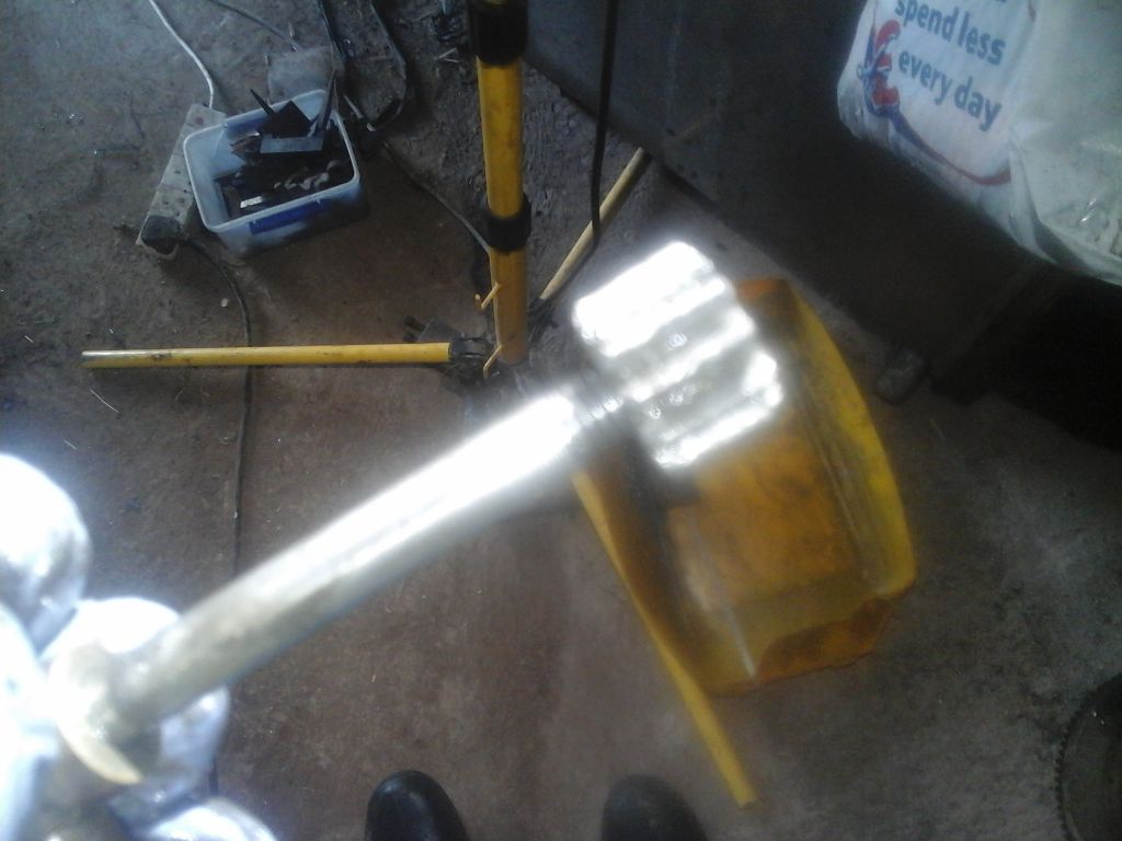

      I recently bought an old myford ML4 lathe that has stood neglected for a few years. My idea was to get it into decent running condition and learn how to use it with a view to perhaps buying a'better' lathe in the future if i manage to master this one. I've done a fair bit of fabrication and metal work in the past but have never used a lathe before in my life, though i do have an idea of the basic principles.
      The first problem i found was when i took of the guard on the bull wheel.
      i'm half way to solving that problem as i mentioned it elsewhere and Brian Wood has supplied me with a new bullwheel which has now arrived, all i need to do is fit it, i'll need some guidance on how to do that but i believe there's some info on dismantling the headstock elsewhere on the forum so i'll look that up.
      some other probably daft questions, the wheel for moving the apron along the bed doesn't seem to work properly, the lttle cog just threads onto the end of the handle spindle,
      so when you turn the wheel it just undoes the nut or tightens it until it binds, is there supposed to be some kind of slim locknut or something?
      secondly the tool post, the original clamp is still in the bock of rusty bits that came with the lathe, but it has a more modern square tool post about 47mm square with the bottom of the slot for the toll about 10mm from the base, i bought some cheap import 10mm tooling to get started with and found that in this post even 10mm tools are above the centre height by a couple of mm at least. i wondered if one of the mini lathe quick change tool posts you can get on ebay with adjustment on would solve this issue?

          Hi,
          Have you disengaged the leadscrew nut before trying to use the rack traverse? Does the slike move at all?
          I also note the headstock beaings appear to have screwdown greasers fitted. The bearings need oil, not grease. If there is grease in the the lubricators it will need to be stripped and cleaned out.

            With response to your query about the handle for traversing the Saddle, yes you need a locknut. Having adjusted the end float to the minimum, consistent with ease of movement, the locknut then locks the handle to shaft in that position. Needless to say it will be BSF or BSW, so you may end up making your own!

                There should be a locknut of some kind to hold the small gear on the shaft, but you can probably get away with a thread locking fluid, at least temporarily.

                  On the subject of some guidance in helping you fit the new bullwheel to your ML4 [i'm glad to hear it arrived by the way] I wrote a pretty detailed description for Luke Mitchell very recently on this forum. Go back one page, you will find it under Myford ML4 restoration–headstock bearings and spindle removal to save me the effort of repeating it all again here.
                  Tool size Dad's lathe came with a full set of tooling he ordered to go with it. These were 3/8 inch square shank, the moderm equivalent will of course be 10 mm square. With some bits and pieces of sheet metal packing, he did all his work that way.
                  The traverse gear and spindle. It is now a long time ago since I examined that sort of detail, but from memory I seem to recall that the gear and shaft were made as one item, the outer handle was fitted and locked onto the external thread. In you case with the gear threaded on, you could try drilling down the joint face and locking them together with a small grub screw.
                  And YES, throw away the grease cups as Robert Atkinson tells you to do, oil is the proper spindle bearing lubricant, never grease.

                    The gear on the apron, it does screw on, behind it is a small 1/4" split washer, before it goes into the apron, if yours keeps unscrewing then firstly turn it around so that the unused section of the gear is facing the lathe bed when installed this will help to lower some backlash on the traverse. Remove the gear and clean down/degrease. put a little threadlock on the thread (just a drop) before screwing the gear home flush with the end of the spindle. On the other end of the apron there should be a washer and a locknut to adjust the tension a then the handle screws on up against the handle to secure the assembly.

                      Thanks very much for the input everyone. WRT the lubricators on top of the bearing cases they are two brass pots with push fit tops and a small hole in the bottom, i assumed they were intended to be filled with oil rather than grease, I've not seen anything similar before but they look similar to the ones on this rebuilt lathe
                      **LINK**
                      the thread on the apron wheel is 7/16 BSF, i do actually have some BSF nuts having bought this lot at auction last year
                      **LINK**
                      I have several lifetime's supply of whitworth and BSF cap screws etc so if anyone ever needs any, let me know. I filed a nut down to half it's original thickness to use as a locknut but with that on as well the gear was too close to the casting of the bed and was binding, but I'll see how i get on with the suggestions here. I was having trouble with the half nuts not engaging as well but I've stripped all that down and cleaned everything and it di manage on pass from right to left before refusing to work at all, taking it apart again one of the pegs that engage the half nuts had sheared off in the brass of the nut, I'd seen a spare on in the box of bits but when i got it out it had suffered a similar fate plus a cack handed attempt to drill out the broken stud. to my surprise i managed to drill out the one that broke on me and re tap it. by luck i had some 3/16 bsf bolts that were just the right length with the heads cut off to make new studs from, they also had longer threads, the original studs only went into the threaded hole half way, which was probably why they were failing. the half nuts seem to be working ok now.
                      Brian, the gear has indeed arrived, many thanks it's very well made, i will look again at Lukes' thread for the details of stripping the headstock down.
                      Jon, I'll have a look for the serial number and let you know what it is, i think you're correct that this is one of the later ML4s
