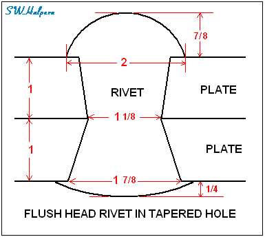

                      I remember that at college we were taught how to calculate the shear force on rivets, but were then told that was largely academic, as the contraction of the rivet meant that friction between the plates would mean that such shear forces would not occur.  Tensile failure of the rivet was more likely, although whether this would be true if the hull was ripped open by an iceberg is a moot point.

                                  Tricky question, because it bears on the state of metallurgy and the ship-building methods applied by Harland and Wolfe in 1908.
                                  Metallurgy was far from perfect!  Contemporary magazines like ‘Engineering’ contain many complaints of poor steel quality, such as ‘plates that shatter like glass’.   The Bessemer Process revolutionised mild-steel production, but the product was inferior to modern steels because the purifying blast was done with compressed air, nearly 80% Nitrogen, which didn’t clean fully, and left Nitrides behind in the steel causing brittleness.  Cured later by blowing with pure Oxygen and by eliminating impurities by detecting and removing them chemically, a process that took decades.   But in 1908 steel quality varied mysteriously because the raw materials weren’t pure and the chemistry wasn’t fully understood.  Further, the science of the day had only touched on the effect of low temperatures on metals, which turned out to be significant.
                                  And in 1908 shipbuilding was dominated by riveting plates to girders and columns.  This type of structure is rather weak and excessively heavy, difficult to keep watertight, and the rivets are weak in shear.   Shear strength matters when a plate is struck a sideways blow, or the rivet head is over stressed upwards,  as might happen when a plate is dished by hitting a rock.  It’s possible for seams to break completely open, or for a blow to cause multiple small leaks by popping or stretching rivets during a collision.
                                  Mostly likely cause of the Titanic sinking was about a third of the submerged hull being scraped at high-speed along an iceberg weighing much more than the ship!   Didn’t create a single massive hole, rather a line of serious leaks that bypassed 5 or 6 bulkheads and couldn’t be controlled.   Then it didn’t help that the bulkheads were open at the top, allowing flooding to spread into undamaged compartments as the bow sank.

                                              John doubt’s are probably because his training and experience are too modern!  Later rivets were almost always made of mild-steel, not least because Wrought Iron went rapidly out of production once mild-steel improved.    But the Titanic was built starting in 1908, a slightly old-fashioned design, at a time when Wrought-Iron rivets were still common.
                                              Not much room for doubt: the evidence in favour of Wrought-Iron is pretty solid.  First, Harland and Wolff’s riveting plan specifies Wrought-Iron, and that’s what examples retrieved from the wreck are made off.
                                              Had mild-steel been used instead, the rivets might not have suffered from cold-brittleness, but we don’t know that!  As the Victory Ship failures show, mild-steel can also become brittle!    There’s a suggestion the Titanic’s plate-work also have suffered brittle failures, but we can’t prove that – the plates are too corroded to tell.
