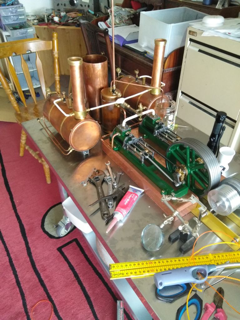

  • #432034
    nigel jones 5
      @nigeljones5
      A customer of mine has the set up below, two 5" boilers set up running a Victoria powering a dynamo. He asks: as the boilers cool they suck in water via the clacks – if there were no clacks could they implode? Now we know they dont, and blowing down isnt mandatory so how much negative pressure is there? I have never experienced this but its worth asking you folks. img_20191006_090424.jpg
      #9884

          #432072
            Crush rather than implode maybe. A completely sealed boiler left to cool would create a partial vacuum inside potentially squeezing the outside at full atmospheric pressure – 100kPA, or 14psi. However a complete seal is unlikely and even a small leak would tend to equalise the pressure. Also, any water inside the boiler would reduce the effect to less than 14psi.
            Putting a cupful of boiling water into a tin container and screwing the cap tight before swirling will crush the can effectively. But tin cans are weak compared with a model sized copper boiler. I don't know if anyone's tested one. As pressure vessels are much stronger in tension than compression, I suppose it's possible a model boiler might buckle, but it's far more likely to happen to a full-size because they have large surface areas.
            #432074
              A lot will depend on how much water is in the boiler when the heat is turned off as the water itself won't contract much but any space taken up by steam will. Certainly remember at school the teacher boiling a small amount of water in a can and then sealing it up and watching it collapse as things cooled down.
              #432075

                #432076
                Robert Atkinson 2
                  @robertatkinson2
                  As Dave says, maximum differential is less than 15 PSI (higer at sealevel on a nice day)
                  Tanks can implode see https://www.youtube.com/watch?v=Zz95_VvTxZM Anyone wo has see an old, non-protected TV tube smashed will testify to the forces involved with larker volumes.
                  Robert G8RPI.

                            Trevor Drabble 1
                              @trevordrabble1
                              Fizzy , In principle , l agree with you , assuming the boilers are designed and tested for a working pressure above 30 psi . Such pressure reversals is how both our porous load and instrument sterilisers worked every day . I would also wish to offer the following constructive comments ,
                              1) The end caps on the boilers are wrong . They should at least be flat ( depending on design calcs ) , or preferably convex , but certainly not concave as shown .
                              2) The steam header is wrong for effective balance . Rather than having a single central take off , there should be two teed take offs , each preferably spaced one third of the length along the header with each tee feeding a smaller short header , and then a single centrally placed teed feed to the engines .
                              Trevor

                                #432089
                                Nick Clarke 3
                                  @nickclarke3
                                  Jason's video –
