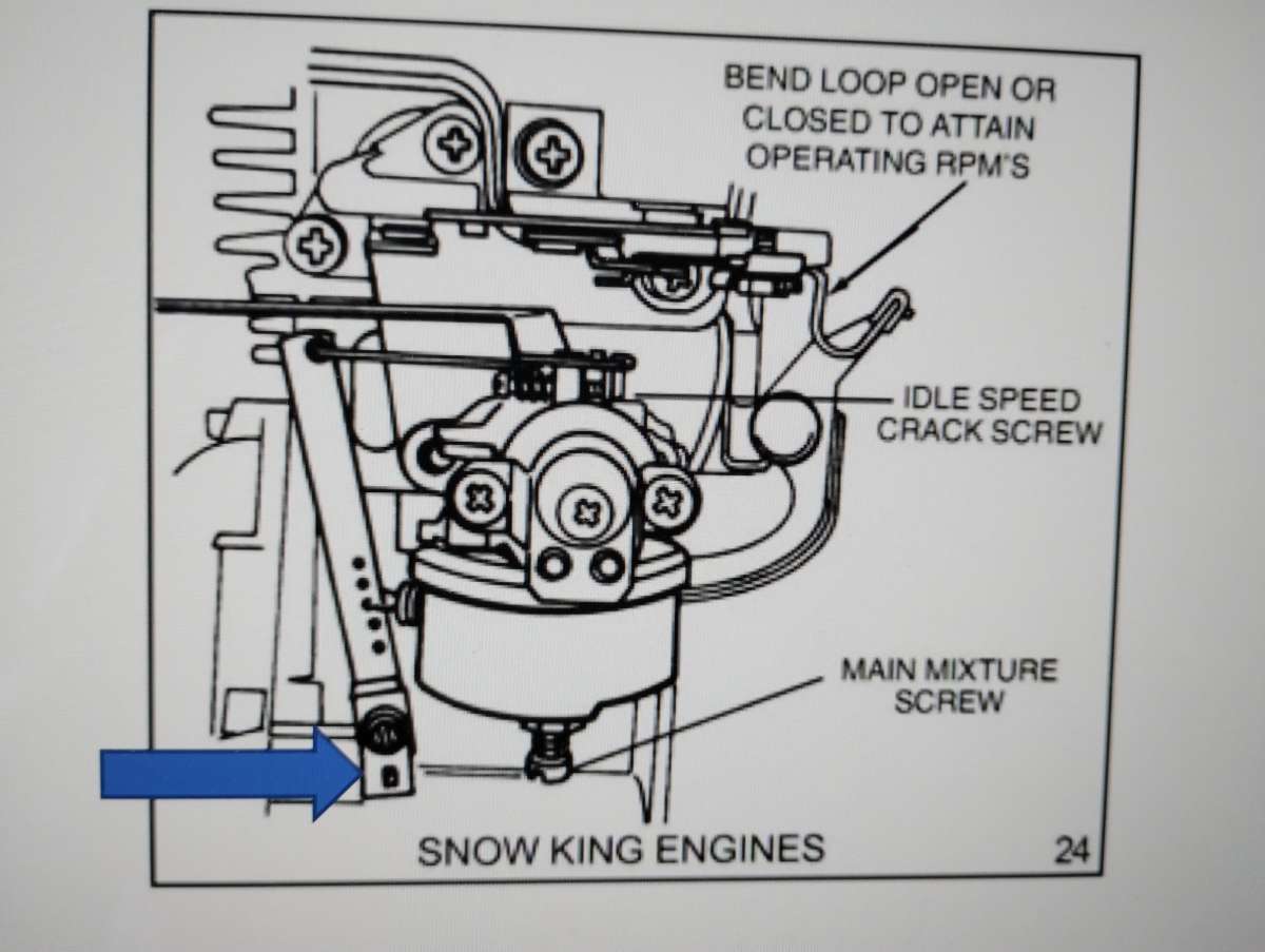

      Hi All
      I am in the process of reassembling the carburetor linkage on a 250 / 125 volt generator driven by an Italian Aspera engine.  The engine is a Tecumseh design licensed to Aspera – Vintage 1970’s or thereabouts.
      The carburetor linkage is very similar to that shown on this diagram, and it is the lower part of the linkage my query relates to.  Please see arrow in diagram below ……….  well I hope it is still there when uploaded.
      IMG_linkage diagram

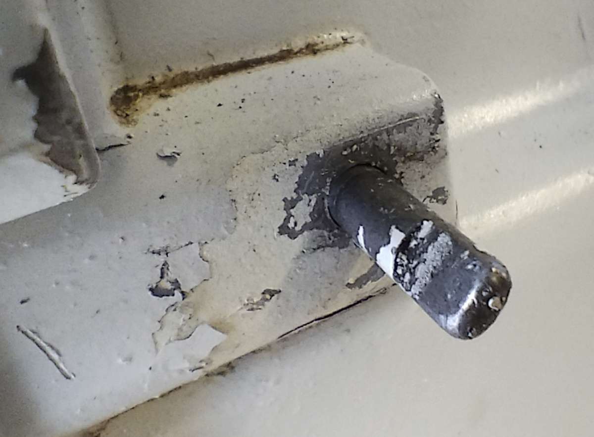

      The lower part of the linkage locates on a pivot shaft with a flattened end.  It protrudes through the main body casting from the inside.  See picture of pivot shaft below,
      IMG_Jenny 4
      The shaft is rotatable through an angle of approximately 235 degrees and has some form of internal stop at either end.  The flattened end is nominally vertical in its ‘normal’ working position (this is an assumption) and is only able be vertical once in its total movement.

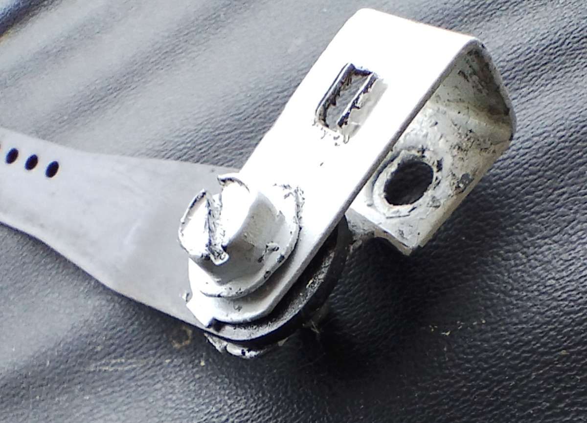

      The carburetor linkage (see photo below) is placed over the shaft diameter and is held in place by means of an rectangular integral spring clip arrangement that is a push fit on the flattened shaft end.
      IMG_Jenny 3
      However when I tried to refit this linkage this shaft disappeared ‘flush’ inside the engine casting.  I have managed to retrieve it, using a strong magnet, but this is obviously not how it was meant to be.  So I am hoping there is someone who is able, and willing, to answer my questions.
      These are:
      1.     What is the function of this shaft, beyond being a pivot.  It does not appear to have any resistance to rotation other than the ‘hard stops’ at each end. Is that correct?
      2.     Should there be something inside the engine that stops the shaft disappearing inside.
      3.     Does anyone have any alternative suggestions, for a workable solution, so I don’t have to take the engine apart – as I don’t think I will be able to separate the generator drive shaft from the engine output shaft.
      Additional information / progress – when trying to refit the original linkage, the spring clip feature fractured – so is no longer usable.  I have managed to manufacture an alternative that secures to the shaft and flats using opposing grub screws.  So I no longer have to forcibly ‘push’ the linkage on the shaft …….. which is some progress.
      I am very tempted to run the engine anyway with the alternative linkage, but it seems sensible to ask the above questions first.Any comments would be very much appreciated.

        It is part of the throttle governor – the has a 90° bend inside the engine and runs against a ‘thimble’ which has pivoted bob weights on it.  As engine runs faster the linkage try to close the throttle.
        No- not usually anything inside the stop the shaft being pushed in.
        You can probably find Aspera or Tecumseh parts manuals on line which show everything.
        You have to adjust the angle where the screw is to get required performance – I used to do these routinely many years ago.

          As said it is the governor shaft, it’s many years since I’ve had one apart . It bears against the governor weight carrier and needs to be in the right position when fitted it may only be possible to assemble in one way. I can’t remember. The Haynes manual on lawn mowers may be able to help. Noel
          PS the drawing shows a mixture screw in the bottom of the carb bowl. In the UK such engines as I saw had a carb drain in the bottom so that in the winter the carb could be drained to prevent water Etc causing corrosion, it was NOT a mixture screw !
