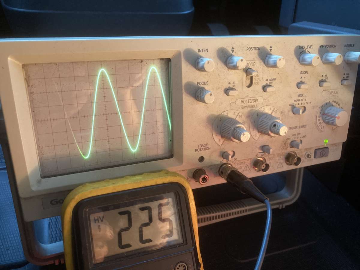

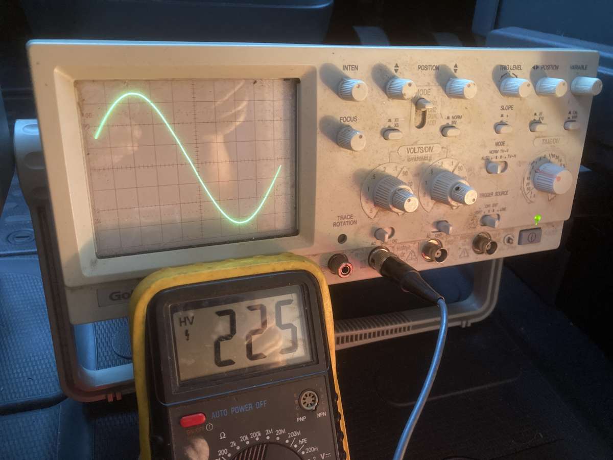

      Here you are:
      IMG_7809IMG_7810
      Both of the above are with a 60W load on the inverter. The no-load waveforms are the same.
      The multimeter is reading the output voltage of the inverter. (Don’t read anything into the X calibration on the scope as I had to turn the gain down on the X axis to fit the waveform on the screen.)
      Photographing the scope was trickier than expected, but the biggest challenge was finding something with an incandescent lamp in to act as a load.
      Switching things on and off etc:
      I was impressed by the cleanliness of the waveform and the lack of transients on startup / load changes.
      I hope that’s of some use.
      Andy

        As you know a “pure-sinewave” inverter in modern parlance menas a PWM inverter. Not really a sinewave but close enough. “modified sinewave” would be better called modified squarewave. These typically use two steps per half cycle. Better than a squarewave but not great for some applications. Both neeed careful design and filtering to meet EMC requirements. Cheap ones don’t have this. Victron are excellent, I’ve used them professionally but they are not cheap.
        Depending on application you may not even need AC. Most modern electronic equipment uses switch mode powersupplies. The fist thing these do is turn the AC into DC. These supplies and equipment will run fine of about 300V DC. Non speed controlled brushed motors (drills etc) will also run fine on DC.
        Robert.

          As I said previously I’ve used Victron Inverters. Yes they are heavy. You are correct, this is because they do have “real” iron cored transformers. Toriodials to be precise.
          Having investigated (taken apart) a couple I was surprised to find that they don’t use the usual architecture of  LV DC in, high frequency AC inverter with ferrite transformer, rectifier and filtering to HV DC, PWM HV DC to 50Hz AC with a bit of filtering.
          The Victrons I’ve seen take LV DC, PWM swith it to a iron core toroid that steps up to mains voltage and some filtering on the output.
          For the units that also charge batteries from the mains the same transformer is used to step down the voltage for the charging circuit.
          At first it looks “old fashioned” but it works well and has good very good EMC and overload performance.

              Excellent, thank you Andy

                      Looks as good as one could possibly hope for !
                      Thanks again
