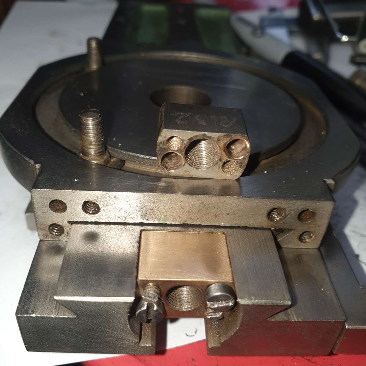

          I have tried the home made nuts on the original screws and they seem a big improvement without any back lash , wiggle or back and forth movement. Same goes for the nuts on the homemade screws. So i dont really see the problem ,i dont intend altering any of the original parts, so if im not happy i can just put them back on and try to sort out the wear particularly on the cross slide .
          The original  nuts on the original screws wiggle like mad and have a lot of back and forth movement which i can easily feel in my hand.

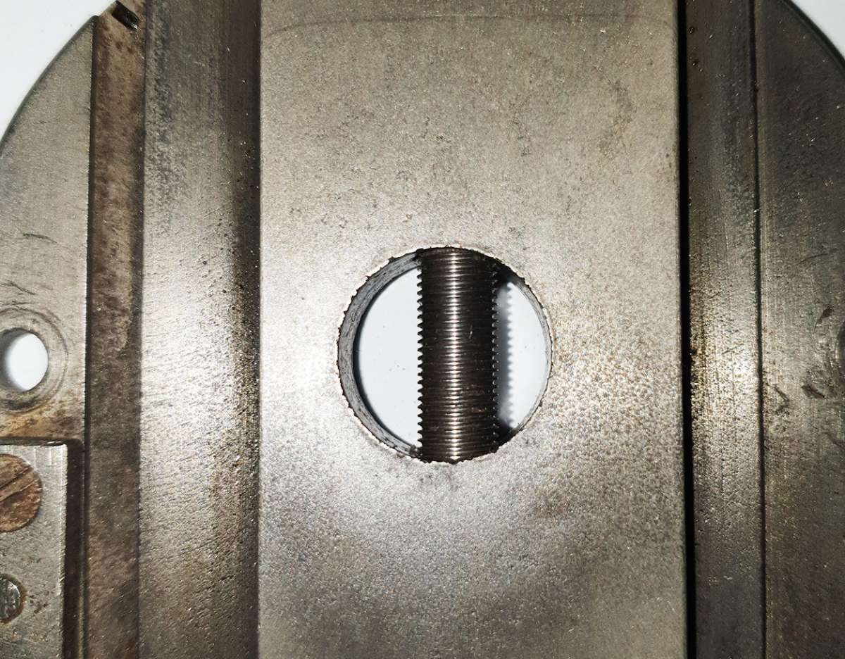

                Dave8, managed to drill a hole in one of the nuts for the cross slide, looked dead on centre . Tried it and it almost immediately  locked up. A bit of head scratching and examined the original .
                Turns out the original is a mile off centre ,as is the hole going through the casting !!!! I wasnt expecting that. So the hole right through the casting is centralised at the front and gradually wavers off towards the back.

                  You could try using the casting as a drill guide. Clamp a new nut in the hole (with a thin washer to maintain clearance) Using a long drill should give you a replica. You may need to make a thin-walled sleeve for the drill, to . match the hole. Ideally, tap it while still clamped.

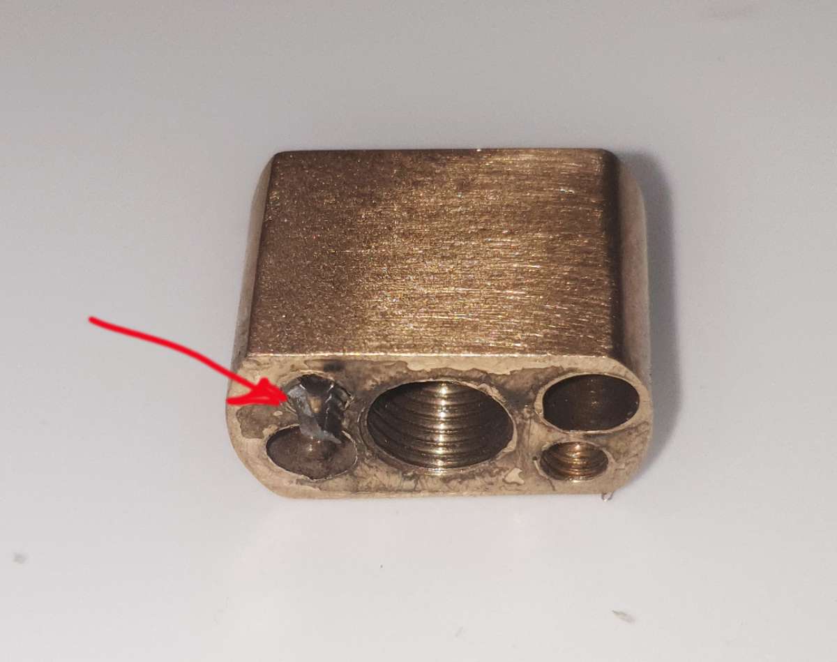

                      Ive had a rethink , ive carefully examined the screws,turns out they are the same diameter all along ,doesnt appear to be any real wear to the screws, So all the wear is in the nuts.  This seems to be the opposite of what most people say that the bronze nut wears the steel screw ,partyicularly in the most used section..
                      I have the compound sorted with one replacement nut .
                      The cross slide i thought i had it sorted but after the second attempt making a new   anti backlash nut  for the front,(which i had tried and it worked perfectly ) but when tapping the  second hole for the two tiny grub screws ive broke the tap. Any tips how to get this small 6 BA tap out??

                      Peter Cook 6
                        @petercook6
                        Dissolve it out in a warm alum solution. That’s the way clockmakers get steel out of brass.

                          Thanks i’ll have to give it a try . How long does it take? Does it definitely not attack the bronze?

                            Bronze is notoriously sticky, especially for small taps. Use a tapping drill at least one size larger than the usual.
                            dave8

                              Yes it is, i got almost all the way through ,then it  suddenly broke.

                                Good luck with the alum. If it doesn’t work, here’ a desperate measure that might – although it doesn’t need splitting into 2 pieces,as discussed earlier, if you split it with a jewellers saw by hand, you could turn one half off the tap. leaving enough of the tap to get a grip on for the other half. You may need to sacrifice a blade or two sawing round the tap. Then clean up the sawn surfaces.

                                    I have used Alum to dissolve steel , the solution must be very strong and preferably warm but it’s not a quick job and it will not affect the brass or bronze.

                                      Well, the part has been sitting in alum in a jam jar ,in an old baby bottle warmer for hours,lots of bubbling but not much has dissolved yet .
                                      In the mean time i decided to make another outer backlash nut, ,temporarily glued the original onto the new one so i could quite accurately get the four outer holes lined up . ,this time the two tapped holes went well with a slightly oversized tapping drill.  fitted it and its great  no movement in cross slide and smooth movement with the hand dials . Compound also works great . Overall a big improvement over what they were like before.
                                      I’ll still leave the other part in the alum to see how long it takes and whether it damages the lead screw thread .
                                      Just noticed the two alignment pins at the end of the casting for the handle bracket are missing on the cross slide.

                                          Don’t expect a quick result.  The bubbles suggest the right Alum is being used – the wrong one will either not work or be very slow.  The reaction will also be slowed down by any oil on the tap.
                                          Another possibility is that the remedy dates to back to well before HSS was invented, and you have an HSS tap. Carbon tool steel taps are probably more reactive than HSS, which contains corrosion resistant elements like Tungsten and Chromium.  Should still work, but even slower than usual.
                                          As far as I know, no-one has tested Alum performance on different steels, or what happens when the wrong Alum is used.
                                          There was a device that put 3 steel prongs into the grooves so broken taps could be unscrewed.  My homemade version wasnt strong enough, and I suspect the commercial version was too weak also.  Anyone know?
                                          For fast removal, all that’s needed is a spark eroder.
