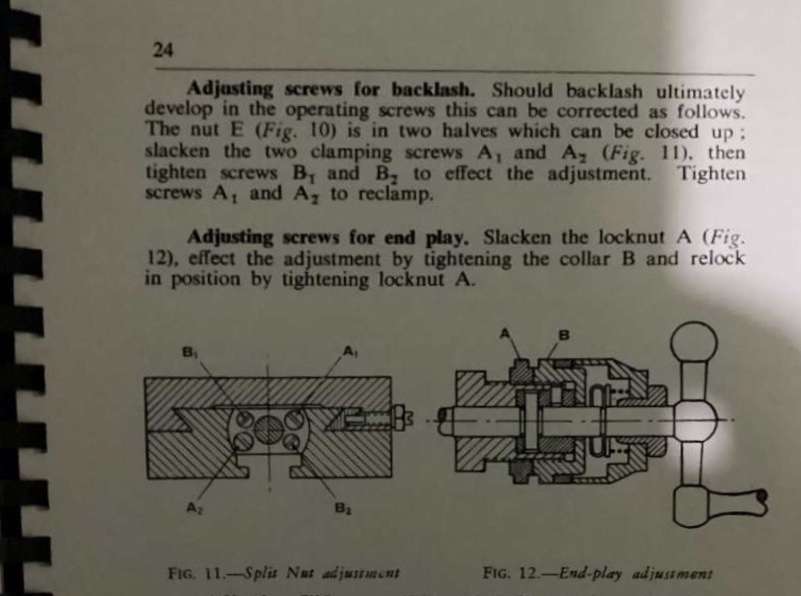

              I agree whole-heartedly, Dave … constantly chasing zero backlash is self-defeating, especially as many adjustment mechanisms work by introducing some tilt into the contact-patch.
              I have taken the liberty of ‘quoting’ Pultra’s statement [thanks, Dell], in the hope that it will be more widely understood.
              Note: __ that word ultimately is significant !
              IMG_0203

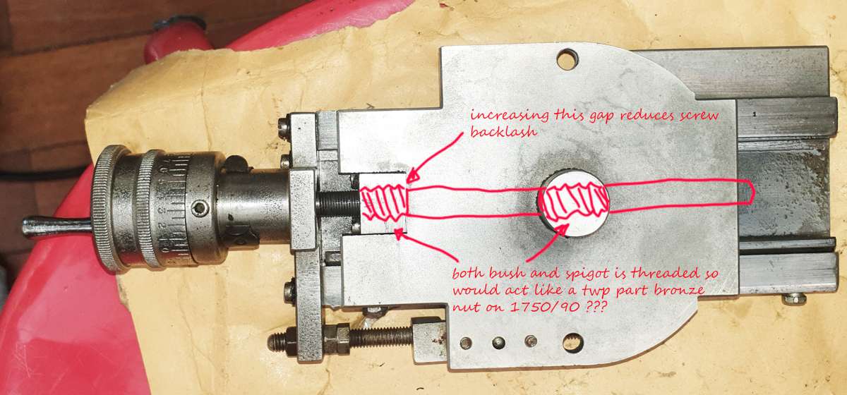

                I don’t think there is such a thing as Zero backlash as anything that tight would be difficult to turn, I think the goal is just to reduce it and anyway don’t we all take backlash into account when we are using out lathes and mills .

                        On the Pultra model P , the nut is one piece  but there is also the spigot  which is around 2″ away from it but also threaded for the leadscrew. How common is this arrangement ? Is it a good design? My southbend 9A just has one nut  similar to the spigot.
                        20241018_094754cc

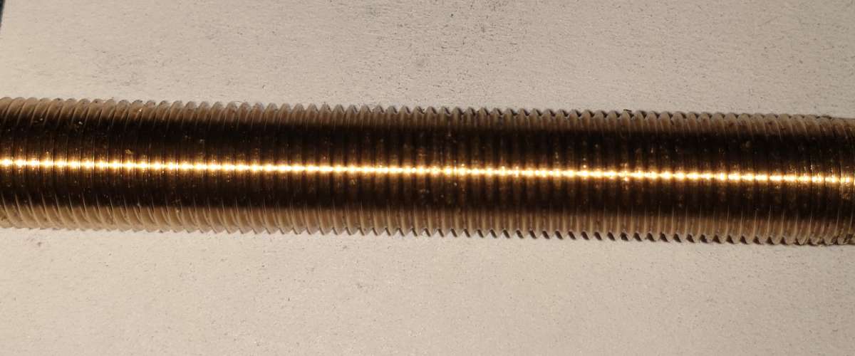

                          Would  this thread form be suitable for a pultra leadscrew?
                          I have the idea of making new screws and nut when i find time using an old  die and tap i have . Its UNS 1/4″ x 40.
                          I tested the split die out on a piece of 1/4 brass bar to see how clean it cuts. 60 degrees i think.
                          20241021_141225

                            <p style=”text-align: left;”>Split die won’t give consistent pitch. If that matters to you either screwcut (difficult if you only have one lathe) or buy from a reputable source.</p>
                            #760523
                            mark smith 20
                              @marksmith20
                              why wont it give a consistant pitch? Ive read they are adjustable to give high precision to match the male thread.
                              #760525
                              duncan webster 1
                                @duncanwebster1
                                They never do, don’t know why.

                                  If the pitch is inconsistent, I doubt you will notice it in a practical sense. Anyway, if it matters, get a DRO, as S.O.D. suggested. Far too many theoretical objections are thrown in the way of what is,to most of us, a practical hobby.

                                          Dave 8 , it looks pretty consistant to me , so im not worried about it.  Duncan mentioned it but i can find no other  mention of inconsistant pitch anywhere using a split die on google .
                                          But back to my question ,is there any reason not to use the UNS thread form for a lead screw if i already have the tap and die?

                                            Mark, no reason at all. I once did a similar thing on a ww lathe using (from memory) a UNF lh tap and die , courtesy of a suggestion by Tracy Tools.

                                                    Though a plunge type with digital display would be an option and at least the zero will always be the right way up.
                                                    Mention was made earlier that split dies may give a change of pitch but no actual figures given. I’m inclined to think that any errors would be quite small maybe 1% of pitch at the most, not sure what tolerances some people need to work to but that is not a lot.
                                                    lets say you want to turn a piece of nominal 3/8″ bar down to 1/4″ that is going to be around 0.125″ to come off. Now if I were doing that I would touch the tool against the work and zero my handwheel (Pultra you may just nee dto note the reading). As it is a light machine lets say you then take four cuts of half a turn of the handwheel reducing the diameter by 25thou each time. Then a lighter cut of say 7thou on the wheel or another 14 thou off diameter.
                                                    Now take a measure ment which should be in the region of 0.261″ so another 11thou to come off so wind the handwheel 5 1/2″ thou and take your final cut.
                                                    If the handwheel and thread is perfect you hit your 0.250″. If there were 1% pitch error then:
                                                    1% of 25thou pitch is 0.00025″ and 5.5/25 of that is 0.000055″ that is half a tenth of a thou or 0.0014 mm which is 1 1/2 microns. Wish I was able to measure that let alone work to it and it would change buy the time I bought it in from the workshop.
                                                    As to replacing the screw as your Pultra won’t screwcut and if that sort of error matters to your work then think about getting a spare screw for an imperial Sheline and modifying that to suit. I’m assuming you still want to work in imperial, if not then why not source or make a metric screw.
