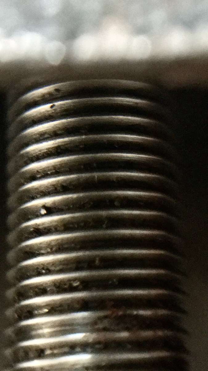

          With apologies for the filthy state of it … this is a short section of lead-screw on a Pultra vertical slide that I have for restoration.
          IMG_0194
          It has a negligible level of wear, and I don’t think there can be much doubt that this is a Whitworth form thread.

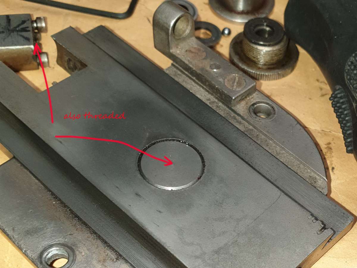

            Talking of split anti backlash nuts in later 1750/ 1780 pultras.  i just relised that this must work in a similar way as if you look at the photo the central mounting boss is also threaded for the leadscrew ,so by adjusting the bronze nut in or out must take up any slack. I didnt realise both were threaded. Is the central mounting boss threaded on later pultras? There wouldnt be any need if the nut was split.
            20241017_142405
            #759788
            mark smith 20
              @marksmith20
              Ive just fiddled about on the compund slide  with the setting of the bronze nut so that any slack was gone  which strangely just involved loosening off the grub screws on the nut and tightening the two machine screws down. ( i would have thought i would have had to tighten in the grub screws so bronze nut and the thread in the central boss were pulling against each other ,very odd). I then reassembled it ,there was bad end float ,as the round nut with two holes in it (inside the dial assembly ) that requires a special tool to tighten was not tightened sufficiently .
              So now even though i know the screw and nut are quite badly worn there is now no play at all. There is no back lash when rotating the dials and no  back and forth movement in the dovetail slide . very pleased.

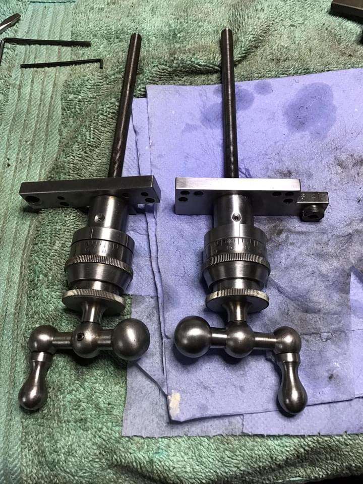

                #759813
                Dell
                  @dell
                  IMG_3111

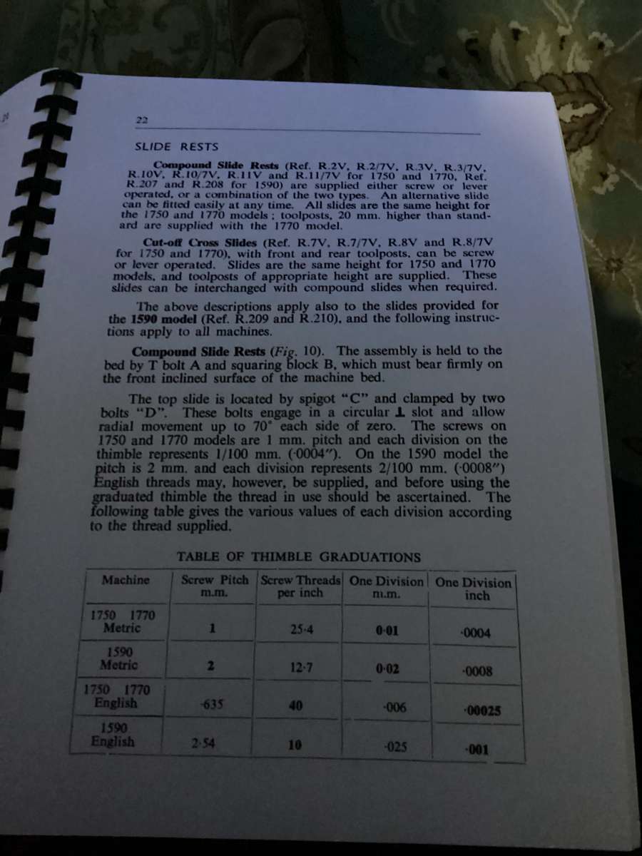

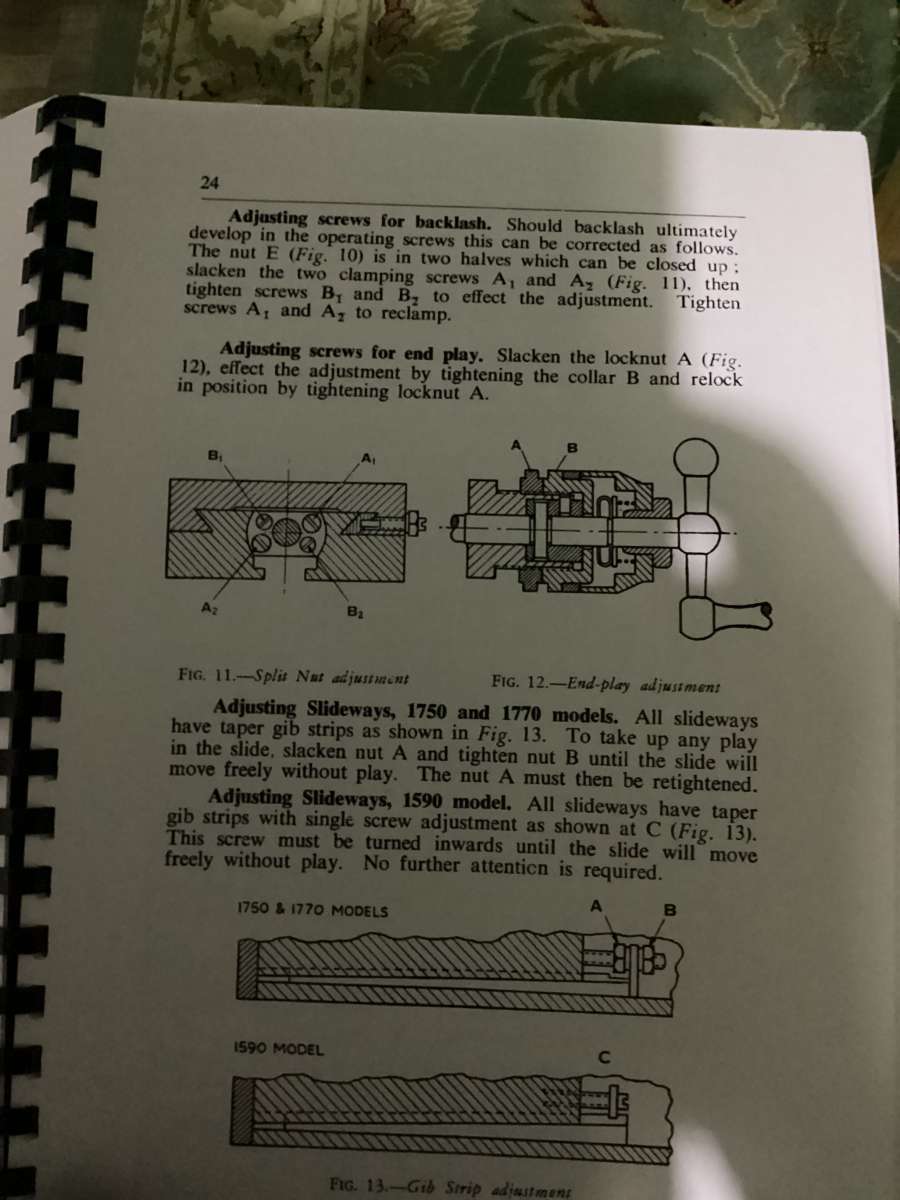

                    Thanks for the info, but doesnt the threaded boss or spigot ( same as spigot C on your pages above ) on the model P compound slide act the same as a split nut only a couple of inches apart?
                    Is the spigot C on your pages threaded for the lead screw or does the leadscrew just freely pass through it?
                    #759863
                    Dell
                      @dell
                      C is totally different that is for the 15/90 a much larger lathe, fig 11 is adjustment to reduce leadscrew backlash, fig 12 is to reduce leadscrew endplay.

                        Dell i think theres some confusion as to what im trying to ask ? Im saying that on the model P both the one piece bronze nut and the spigot is threaded for the leadscrew. Is the spigot on the 1750 if it has one just a clearance hole for the screw unlike this on the model P. This image is the top slide /compound slide. So it acts like a two piece /split nut?  thanks
                        p.s if i am right then if you were replacing the nut /bushing or rethreading it ,wouldnt you have to deal with the threaded spigot as well?

                        #759920
                        Dell
                          @dell
                          20241018_094754

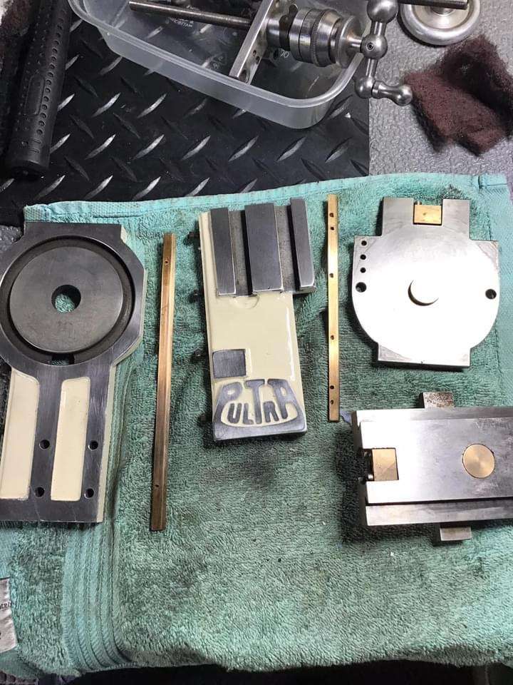

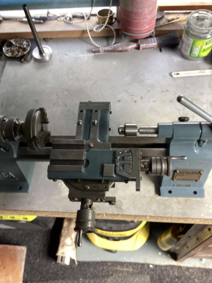

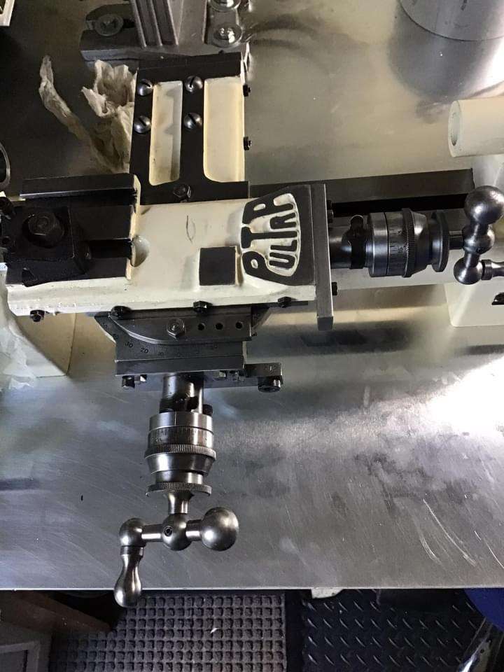

                          Both the P type and the 17/50 & 17/70 are more or less identical apart from the handles & dials although both can be used on either, I now have a crosslide off a 17 series on my Pultra & both the leadscrew & nut are threaded can’t remember if the spigot is or not but I think it was , in the original post I bushed the nuts and tapped them but since then I have made some new ones for another crosslide, also I have seen both one & two piece nuts so logic would say the two piece nut wouldn’t have a threaded spigot but don’t know for certain, the pictures of my crosslide may help .
                          The last picture has the different although usual handlesIMG_3117IMG_3116IMG_3118IMG_3119IMG_3114

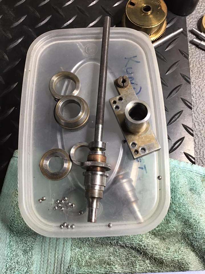

                              Yes just sits in the hole , when you take it apart watch for the ball bearings as the first one I did I thought I had lost some because there are only 9 but easily room for 10 but the manual lists 9 very odd.
                              #759937
                              mark smith 20
                                @marksmith20
                                Yes i thought there was one ball bearing missing as well have 9 but as you say room for ten.

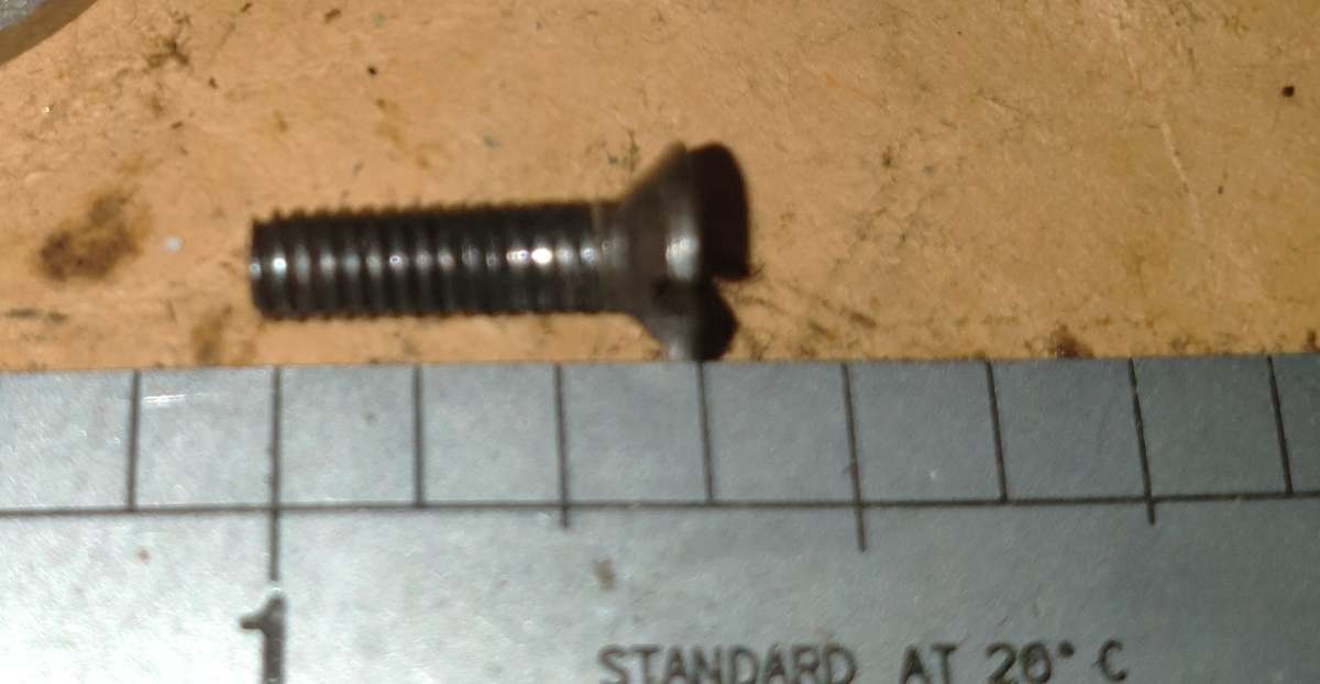

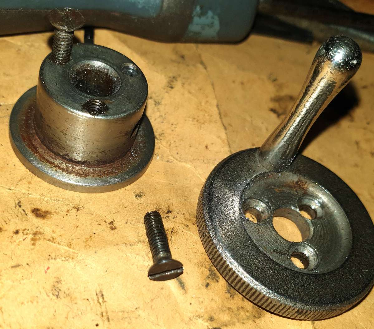

                                Cross slide is proving more troublesome with  one of the the 3 slot head machine screws holding the hand wheel on ,the slot  is mangled and cant get it unscrewed at all.
                                #759939
                                mark smith 20
                                  @marksmith20
                                  I had to use a screw extractor to try to remove the screw , it removed the head ,so ive drill out the middle of the screw, any idea what these screws are ,they are 0.104 ” diameter . Seems to be 12 threadsover 1/4 ” so possibly 48 TPI

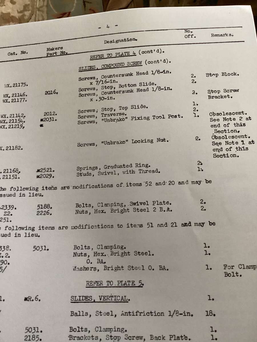

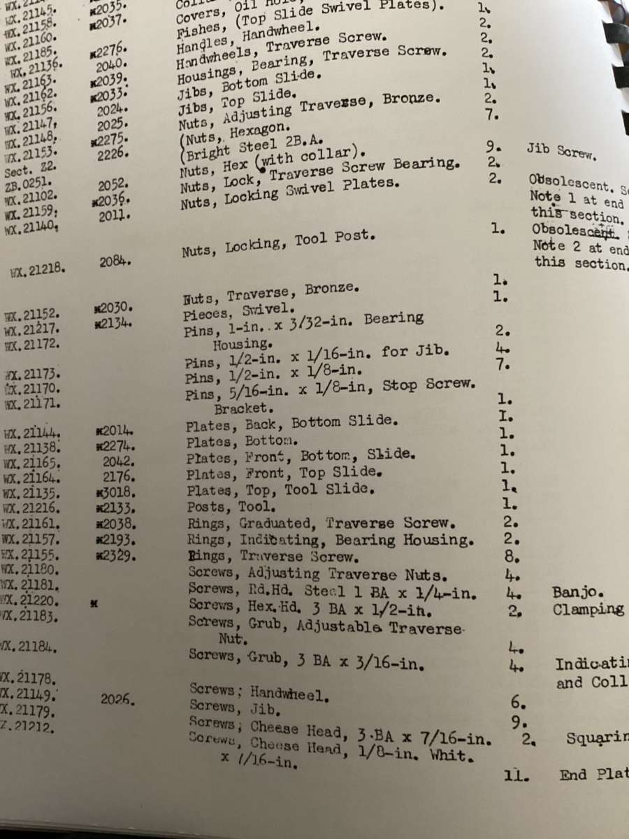

                                  Dell
                                    @dell
                                    I thought The screws were BA  but maybe not all the book has is screws hand wheel 6 .IMG_3121IMG_3120
                                    #759957
                                    mark smith 20
                                      @marksmith20
                                      Possibly 6 BA  or BSW 3/32 x48  ?

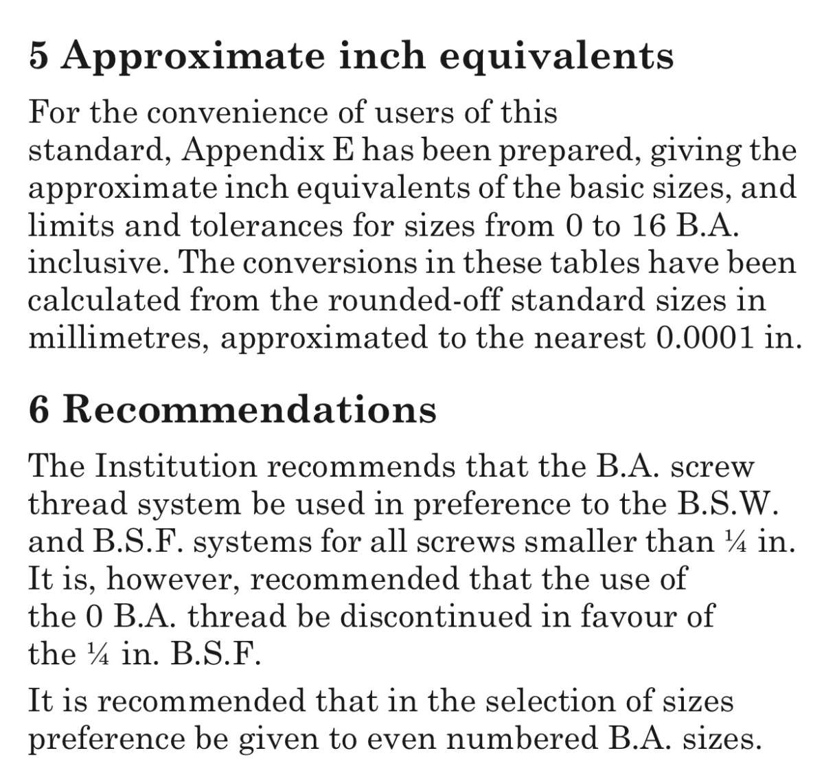

                                            It doesn’t guarantee anything … but do be aware that BSI ‘deprecated’ the use of the very small Whitworth threads, and recommended that BA be used for most fixings under 1/4”
                                            #760088
                                              In the hope that this comes within the scope of ‘fair use’ quotation
                                              here is the text from BS 93:1951

                                                    Michael G, i have a feeling they may be 7/64 x 48 ,never seen any screws of that size available now.
                                                    Ive now decided they are simply 6 BA ,i found a piece of brass 6 BA rgeaded rod  and it fits perfectly and has the same diameter of the screw..
                                                    #760201
