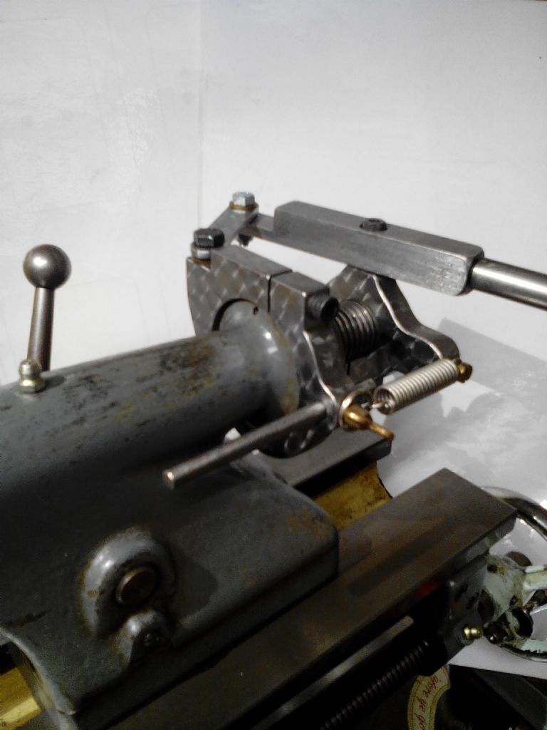

                                Any idea for a lever operated tailstock for ML7 other then original one, which one can buy for 150- 200 pounds on ebay.
                                It is easy enough to make an off-hand project of that but maybe something of particular merit is known for other members here.
                                I would be very greatful for any ideas regarding that item.
                                This hand wheel is really not good enough.

                                  Posted by Martin Dowing on 27/10/2016 11:20:47:
                                  Have a look at Gadgetbuilder's site for his lever operated tailstock chuck
                                  http://www.gadgetbuilder.com/DrillSharp.html#Lever_Drill
                                  That may give you some ideas.

                                    That would be good but unfortunately a strike of tailstock longer than 1 inch is required.
                                    Assemblies set on the rear of the barrel can give 3-4 inches of strike and something like that is what I would aim for.
                                    Of course there is nothing particularly challenging in designing one of your own but may be some clever & tested designs, perhaps resembling Myford original are available around.

                                        There are drawings and a write up of an ML7 lever feed tailstock in MEW 16 page 30.
                                        Dennis
