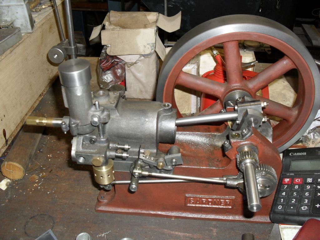

        I've got the recommended Primus 8842 burner for the hot tube on the Alyn foundry 1/2 size Gardner gas engine,
        Does anyone know what the thread in the burner is?
        Also does anyone know where I can get fittings to connect to say 1/8 copper tube ?
        Thanks,
        Richard.

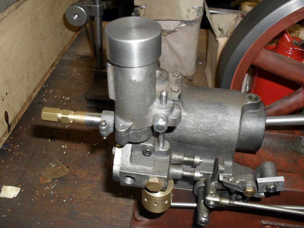

                      What I've decided to do is, screwcut a brass screw in the lathe M8 x .75 pitch, and then make a "banjo" type fitting that can be silver soldered to the 3/16" copper gas pipe, the whole lot will then attach to the Primus burner,
                      Sound like a good idea ??……………………………..Or not,
                      Richard.

                        If it were mine I'd make up a barrel union with male M8*0.75 one end to fit the burner and 5/16*32 the other so you can use conventional nuts and olives. Of course you might not have room
                        #273087
                        RICHARD GREEN 2
                          @richardgreen2
                          Hello Duncan,
                          I see what you are saying, unfortunately the burner sticks out quite a long way already as you can see in the following pictures, I would like to keep it all as short as I can, so the engine is as compact as possible, using an elbow or a banjo fitting will do that.
                          Richard.

                            lovely work! I can confirm that the thread size is M8 by 0.75 mm pitch. I used to make a Brass Banjo coupling to convert to the readily available 3/16" Copper pipe sold for brake pipe repair. This also helped because Wade made many 3/16" compression fittings.
                            Cheers Graham.
