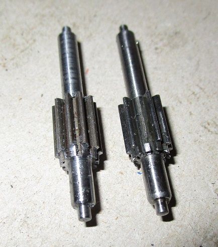

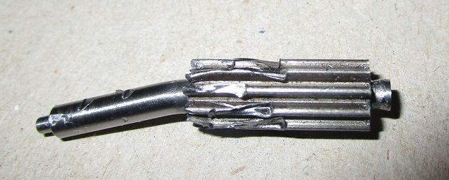

        Hi, I was working happily away on my Sherline lathe using a quality carbide right hand cutter trying to make a replacement arbour. one end completed having made the pivoy and reduced the arbour as needed I turned the stock around. First job I needed to do was create the pivot at the end and was nearly there when disaster. The tool felt like it dug in and yanked the stock out of the 3 jaw chuck decimating the work.
        OK this happens but why? what I can tell you is the angle of the cutter was correct but what could be possible causes as it is not a happy moment when this happens/

          Were you holding the part by the short shaft end in the chuck when it broke free ? did the other end have centre support ?
          Were the cutting forces towards the chuck ?

              You were holding the part by the pinion leaves in a three jaw chuck?
              #441334
                Probably easiest if you pop it back into the chuck and take another photo so we can get an idea of what you ware holding it by and how much work was sticking out.
                #441342
                  The answer is almost always either the work is not held securely enough OR the cut was too aggressive for the work in hand (DOC or feed rate too great, sometimes speed too high for DOC or more likely too low for the feed rate). The other possibility is a blunt or poor choice of tool.
                  Posted by blowlamp on 12/12/2019 12:34:09:
                  It also looks like the tool may have been used to face the work with quite a large depth of cut for such a delicate workpiece.
                  #441346
                  Pete Rimmer
                    @peterimmer30576
                    Use a split collar to grip across those splines. It'll be much more secure in the chuck. Just take a piece of ally, drill it the diameter of the splines and cut a slit in it so the chuck jaws close it onto the part.

                      Hi guys, well some of you were spot on here. I got lucky and solved it myself and thought if I couldn't I would look for your ideas. well done guys you were spot on. the issue was the pinion wire would not centre in the 3 jaw but this time I got lucky in that it just fitted the 8mm collet. I was going to make a split ring up to that point, I take it brass would be better than steel?
                      Also I tried to see if my 4 jaw independent chuck would help, never got it out of the box till today and I would appreciate any one who has any tips on setting the 4 jaw up as it seems a pain in the but.
                      More lessons learned, still more to discover.
