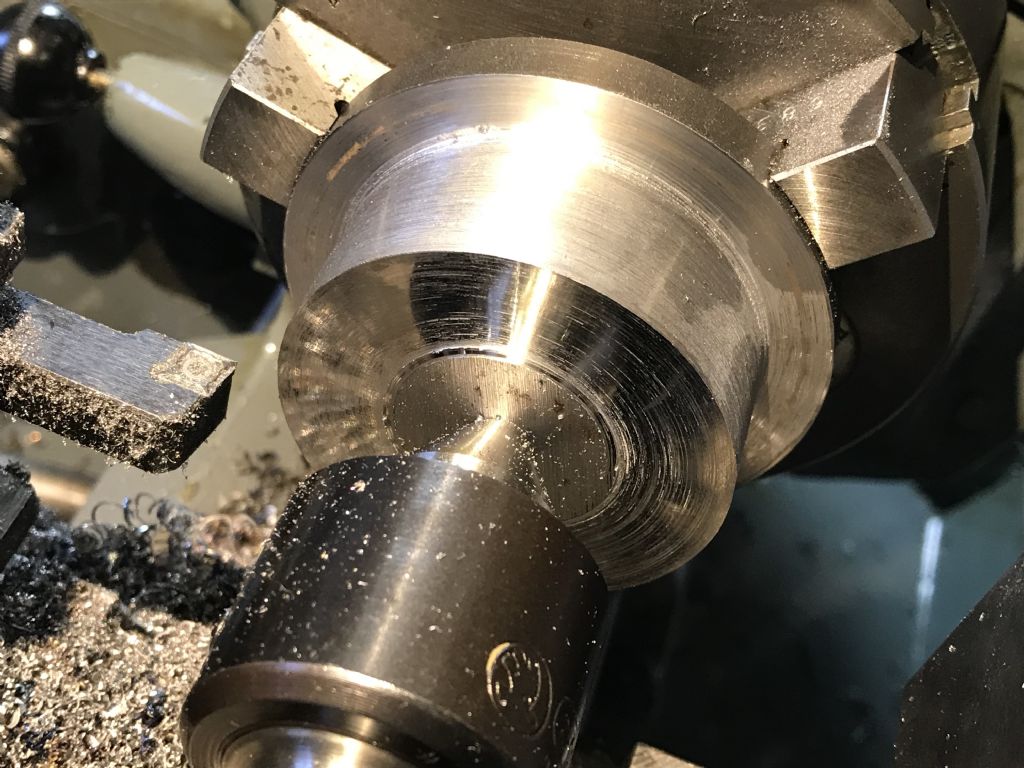

      Any advice regarding cause of poor finish when turning EN1A Freecutting steel using indexable carbide tooling?
      Using standard Greenwood type 1 general purpose inserts in a Myford Super 7B. 10mm shank in Dickson toolpost
      Cutting dry
      Turning 3" max diameter EN1A steel bar down to about 2 1/8" diameter
      Speed 290 RPM
      Feed 0.0069" per revolution seems to be getting best finish
      Cut depth between 5 and 10 thou (deeper cuts at higher feeds causing jams and belt slips)
      Checked all gibs are tight but not over tight.
      Chips coming off anything between long blued spirals and fine particles depending on cut and feed rates.
      Getting better finish on facing cuts
      (Component will be a part of a bearing cone puller for our 1914 Stanley Steam Car, so not a need for high finish – but a useful turning exercise)

            Looks like a CCMT insert from the photo , If it where me i would double the spindle speed and depth of cut.
            On my S7 with CCMT inserts the best finish is with at least a 20thou depth of cut and a fairly fast feed to get a decent chip.

              Speed is way too low, 1000 RPM would be nearer the mark.

                  Up the speed, I would be running at 600 to 850 RPM with those tips. For a good finish when only taking a small amount off consider using a carbide tip with the "GT" ground tooth style rather than the usual "MT" moulded tip general purpose style. The GT tips are sold for cutting aluminium but work well as light duty on steel.
                  The tips you have should be OK if the feed and speed are upped.

                                      That tool is stuck out way to far. Bring it back inboard till the shoulder behind the insert is level with the toolpost and have another go.

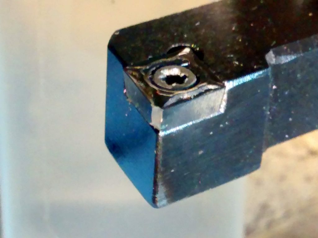

                                        Has anyone zoomed in on the insert tip ? Looks chipped to me and if it is no amount of feed rate change will make it work . I typed in greenwood type 1 insert into google and couldn’t see anything of use , in have had issues recently with cheap inserts that won’t cut anything and i put it down to dodgy inserts .
                                        If you need to do things on a tight budget stick with HSS otherwise be prepared to fork out for known quality carbide inserts – the cheap junk isn’t worth it , been there done that got burnt !
                                        #405302
                                          XD, this is the Greenwood tools type 1, they use a simplified number system for people that don't understand the code, it's a CCMT 06 02 0 (whatever radius is selected) they are not bucket quality and should work fine.
                                          Too much swarf on the htip to see if it is chipped or not

                                            To me looking at the finish and zooming in on the photos the finish looks to be tearing and the tip looks like the radius is gone – when things go awry i look at this first ,Its a simple thing to change and check .

                                                    XD 351 was right, tip chipped off by the time I took the facing cuts.
