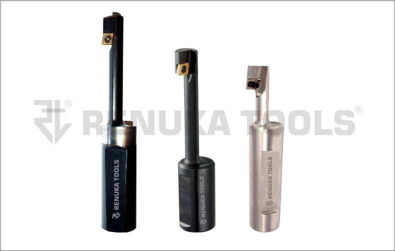

        You need a ‘back boring bar’. Easy enough to make one, to take a small HSS bit in a cross-hole (see description in books), or convert a right-angle-cranked HSS boring bar. Or forge and file/grind one from silver steel/drill rod: it will be fine for the limited amount of work it’ll have to do. Here’s a pic of inserted tipped ones – no idea who the company is, no doubt cost a small fortune. As you can see, it’s just like a conventional boring bar, but with the tip reversed.
        Strange to have such distortion. Presumably the chamber was of round cross-section, thanks to the use of a chambering reamer, used after assembly. Good luck with rifling. Perhaps you’ll tell us how you go about it.

          Classy-looking tooling, Kiwi
          … and proudly made in India
          https://www.renukatools.in/include/downloads/ECCENTRIC%20FINE%20BORING%20TOOLS%20V24.1.pdf
          … That’s trampled upon some of my preconceived notions !
