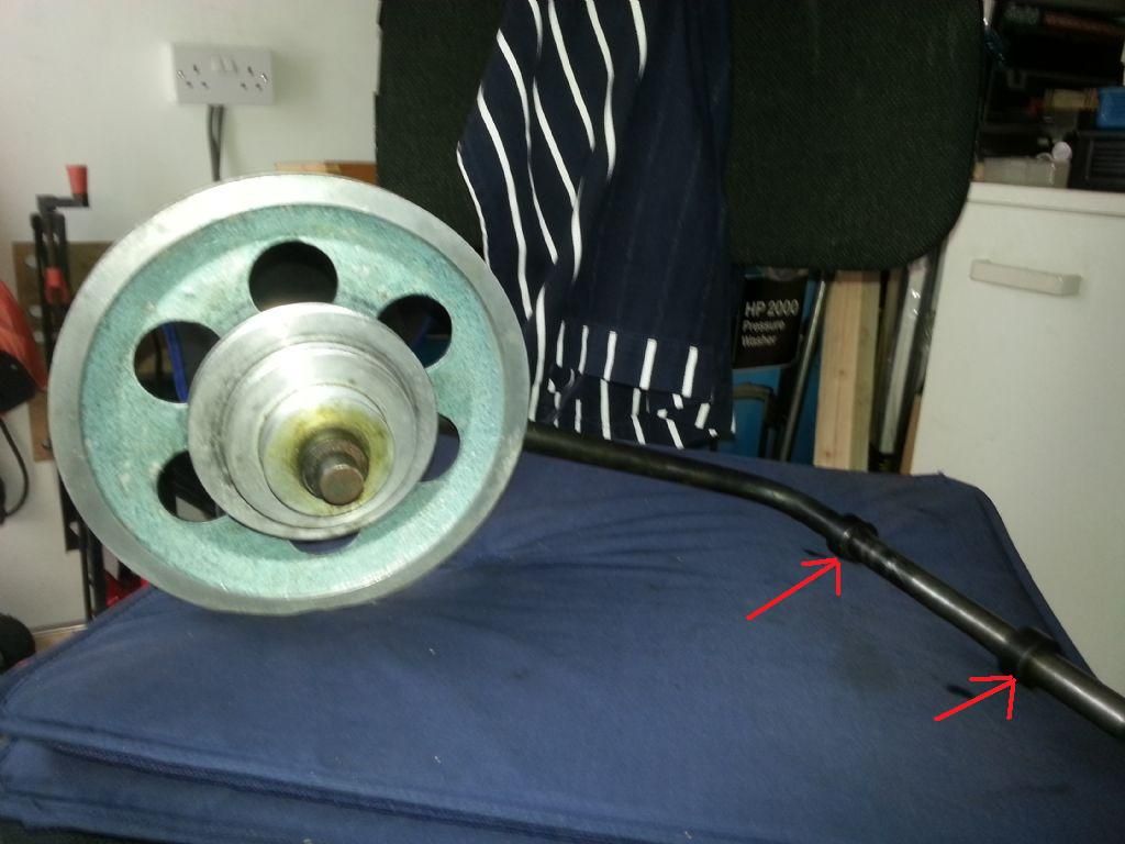

              I have a shaft that attaches to the lathe and motor that has a 90 degree bend in and a set of larger pullies, I'm thinking this is the jack shaft?
              I have looked at the photos on Lathes.co.uk but none of them show the lathe from behind or the way it all fits together.
              Thanks for advice.

                  Can you manage some photos of what you have? "motor that has a 90 degree bend " sounds like a geared motor that would not be quite right for a lathe.

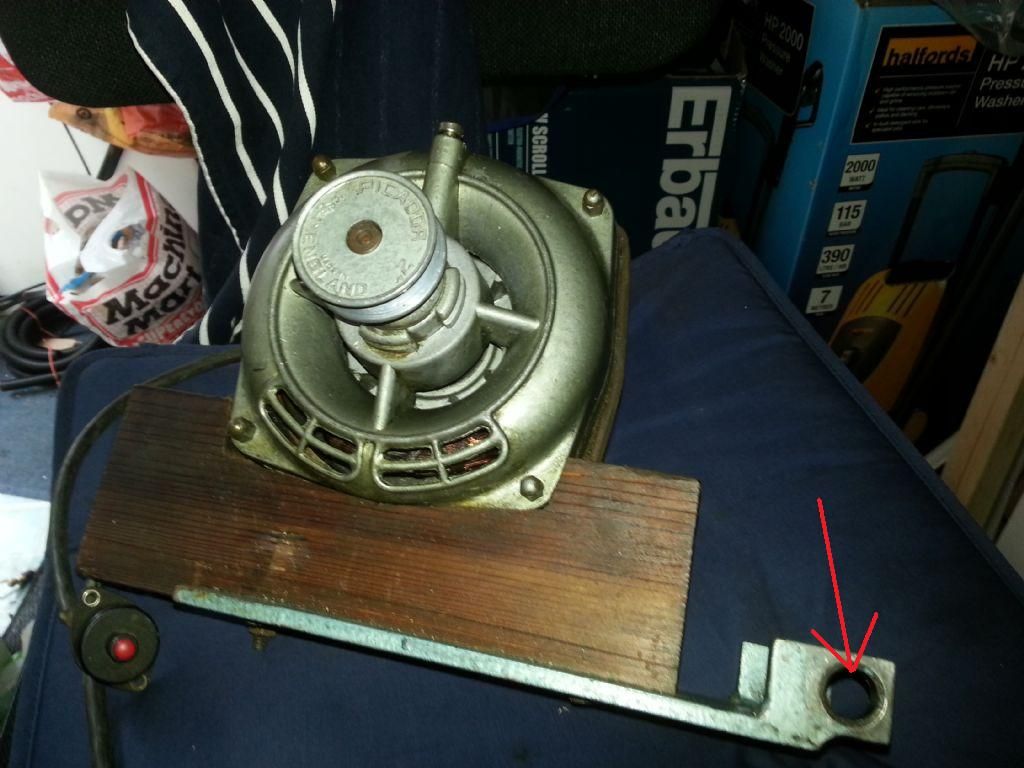

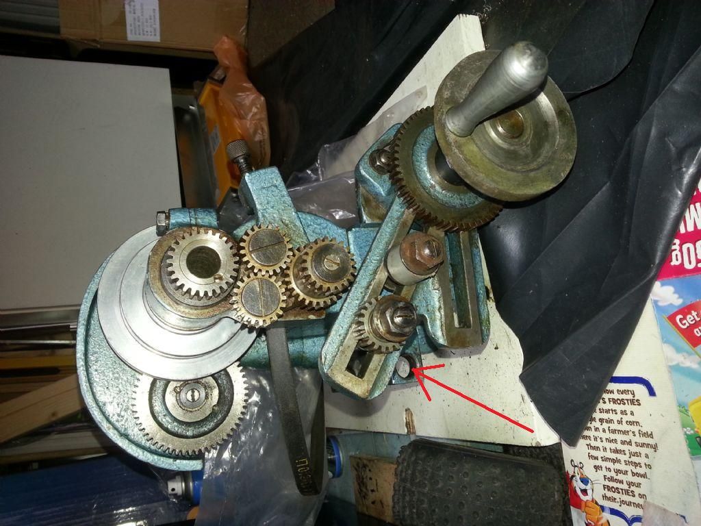

                    20130917_092331.jpg20130917_092157.jpg20130917_092126.jpg20130917_092011.jpg20130917_092002.jpg20130917_091830.jpgSorry that is my poor grammar. The shaft has 90 degree bend not the motor.
                    Some photos, anyone know what the thing that looks like a hammer is?

                      The hole at the end of the motor bracket
                      Lines up with the hole in the lathe bed
                      And the bent lay shaft acts as the pivot pin
                      So it should look like this

                        What a neat explanation! (Nice wee lathe too).
                        But what on earth is the bit that looks like a hammer?

                          Thanks Jason, so all I'm really missing is a belt.

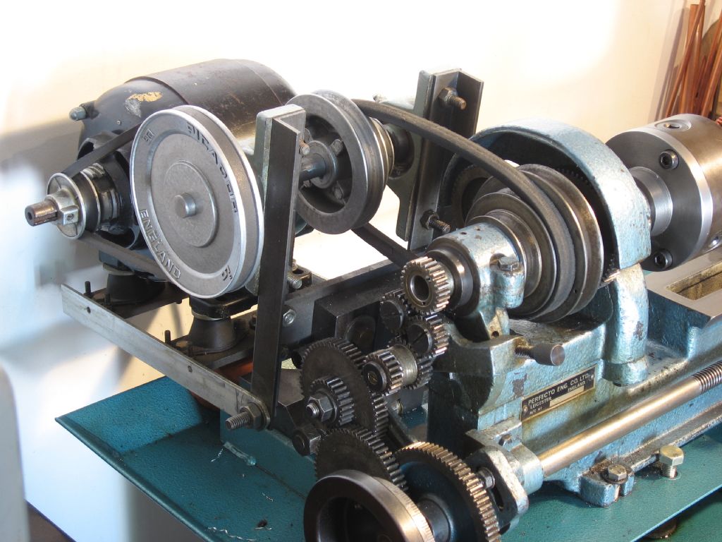

                            I attach a photo of my Perfecto lathe showing the motorization. The motor, pulleys and belts are held in a cradle made from aluminium angle. It came like this when I purchased it in the early 1980’s. I also have the leaflets etc. that came with it. There is also a useful chart of the gear ratios to the leadscrew. I can copy and send any of them if you wish. I learnt a lot about lathe work with mine and made some nice model steam engines. I hope that this is helpful.
                            Ray

                              Thanks Ray that is useful, Ihave ordered a new belt. I would be very grateful for copies of the leaflets and charts. I will message you my email and home address so you can choose your prefered method, email would be good for me.
                              I have also realised what the hammer thing is, a die holder as it has 3 grub screws in the correct position to hold them. I guess this is held by the tool holder.
