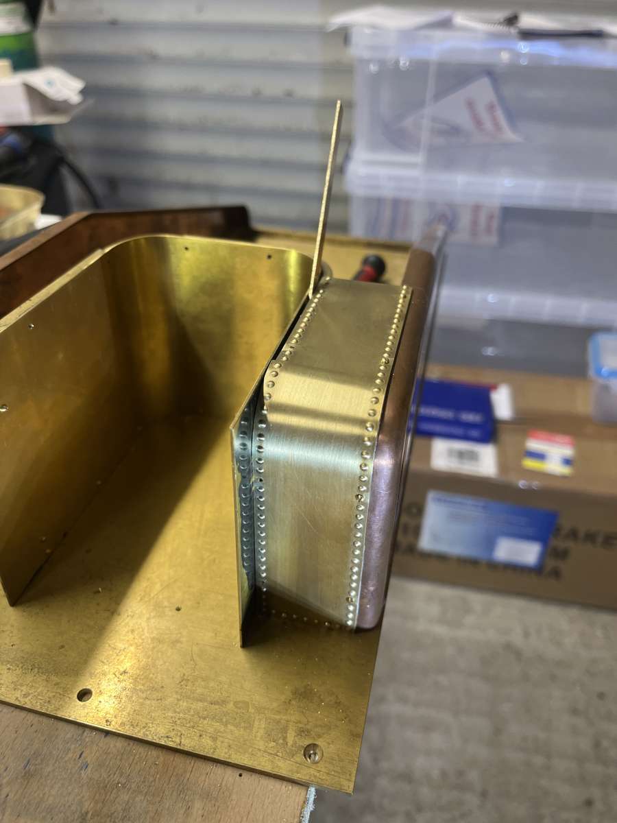

                  I have managed to get a bit more done this week, another of the parts of the build that I really wasn’t looking forward to. Embossing the rivet detail on the Tender Tank.
                  I made up the punch and die quite a while ago and hardened and tempered them.
                  I milled out a pocket in my ‘use it for everything’ jig/mini-pallet block, then made up a fence:
                  IMG_5904
                  I cut and milled a couple of lengths of 1mm brass sheet to width before cutting them to length and milling out the 1mm offset for the verge board
                  IMG_5903
                  I also spent quite a while testing exactly how much pressure was required with the punch to create a reasonable rivet. I think i may have drilled the die a little too deep, as with too much pressure on the punch, it will punch a hole in the sheet. Some of these were done before I made up the fence, some after:
                  IMG_5905

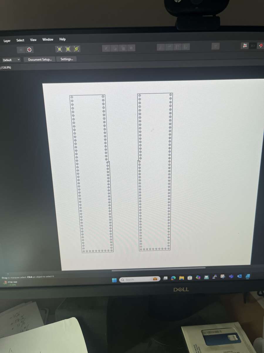

                  I also bit the bullet and bought a copy of Infinity Designer, and went through the learning curve of new software – I found the spacing on this was incorrect – they were too close together, fortunately, i used the offcuts from each side sheet as test pieces and ran through the whole process with these, to get a bit more comfortable.
                  IMG_5910
                  On to riveting…
                  IMG_5911
                  IMG_5912
                  IMG_5913

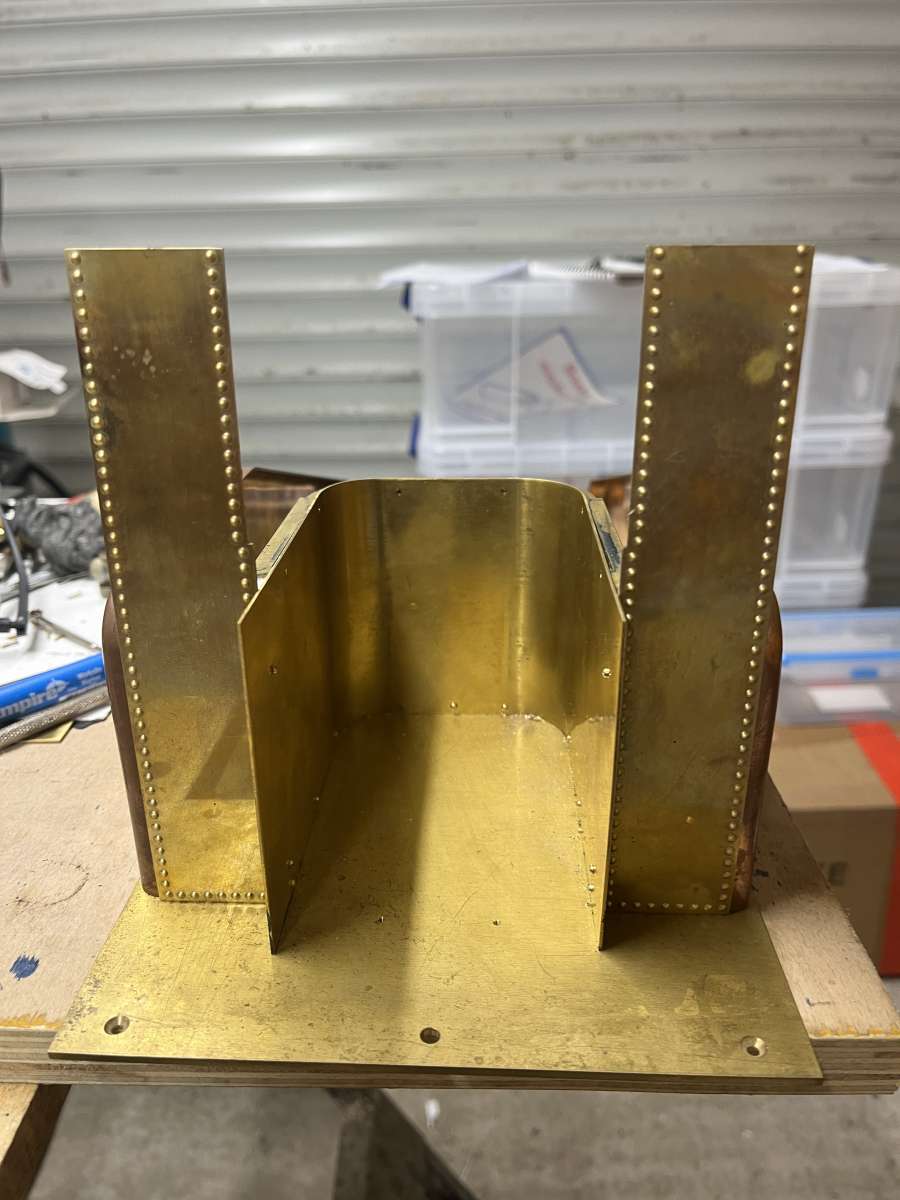

                  And this is where we are now. I need to drill out a few of those rivets for fixturing screws and bend the plates, but overall, I’m happy with how this turned out
                  IMG_5914
                  Cheers
                  Mark

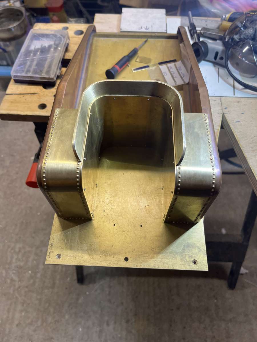

                    Lots of work in the last few days, but not much to show for it.

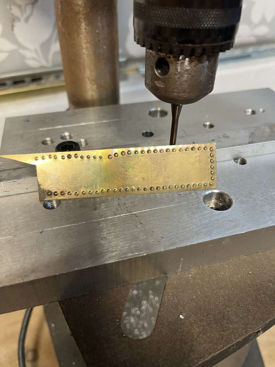

                    I filed off the dummy rivets where the fixturing screws were going:
                    IMG_5915

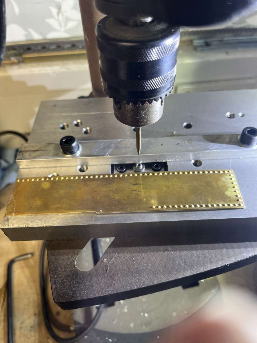

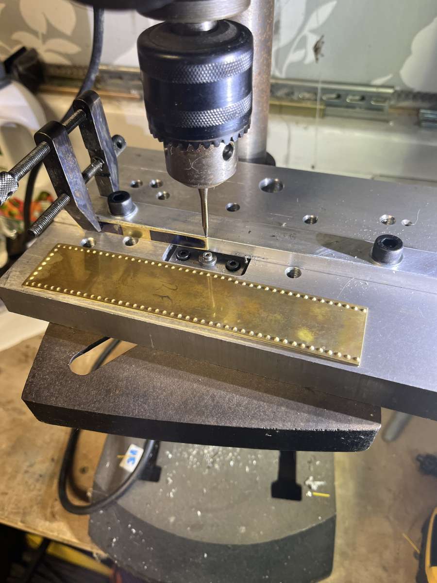

                    Then drilled out the rivet 1.1 mm, I have found that 1.05mm (the correct tap drill size for 12BA) to be really tight on the teeny tap, especially in the 6.35mm brass bars. Then drill the matching part, tap, then drill out the brass plate to 1.3mm (clearance for 12BA).
                    10 of these on each plate. Plates on, off, on, off, then all off to drill and tap out the horseshoe member.
                    IMG_5916
                    IMG_5917
                    IMG_5918

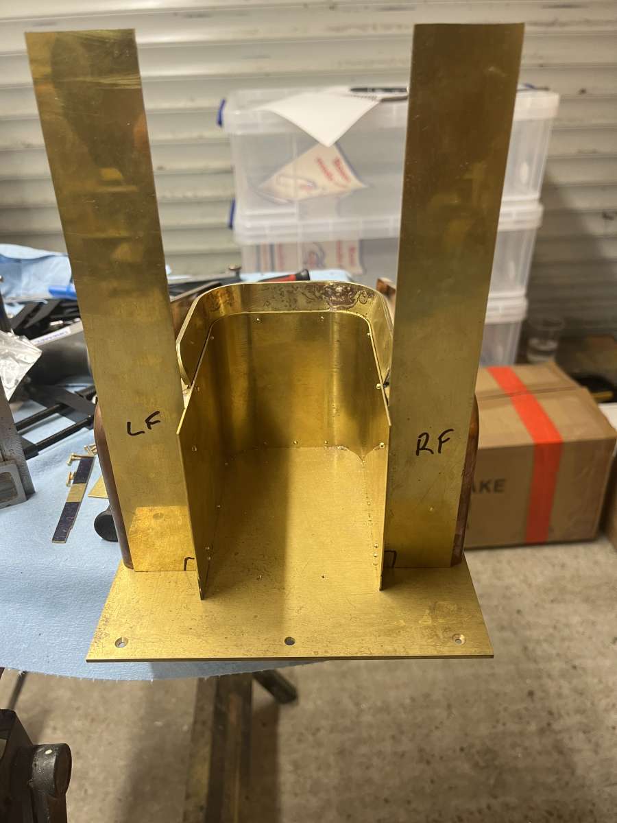

                    Then finally, i have cut down the vertical board and filed and sanded it to shape
                    IMG_5919
                    Cheers
                    Mark

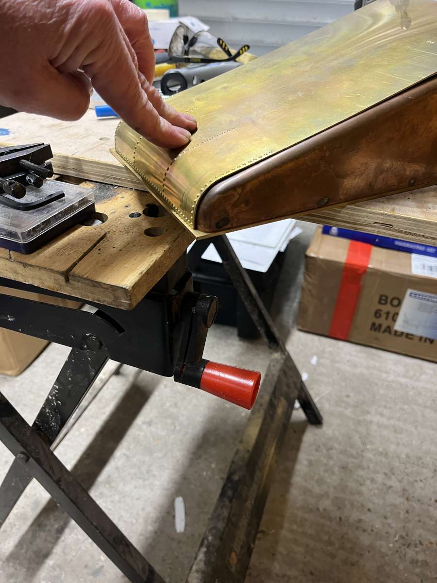

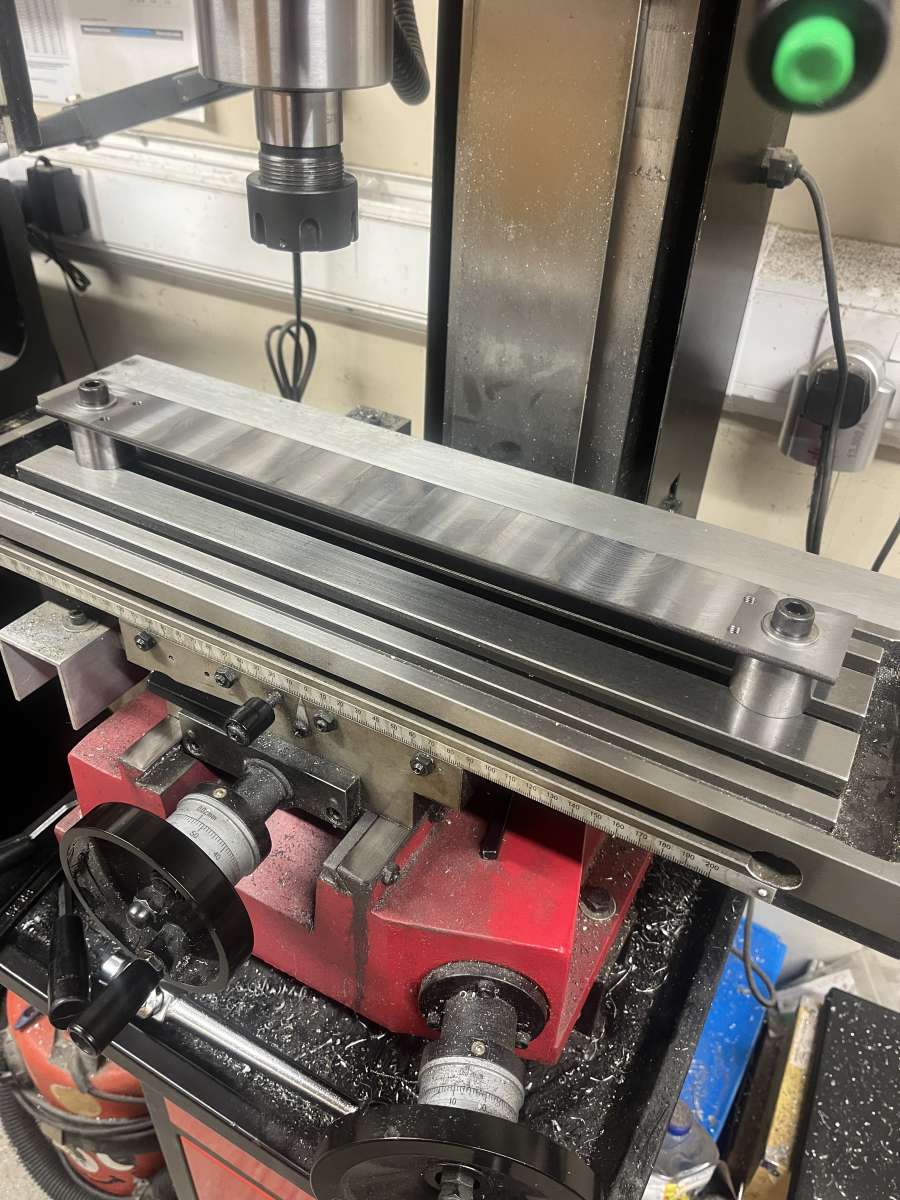

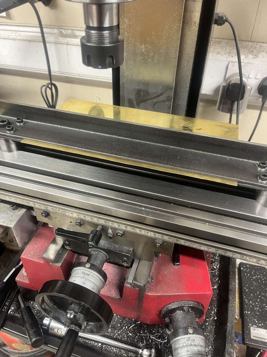

                      Bit more done.
                      Starting with squaring off the top sheet and bringing it down to dimension width wise using my Blondiehacks inspired sheet metal clamping system:
                      IMG_5926IMG_5927

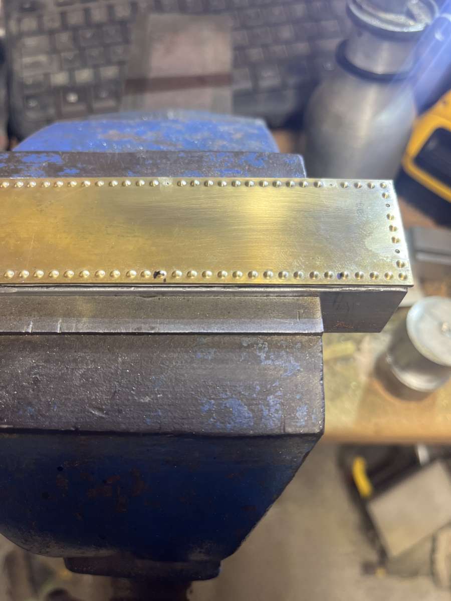

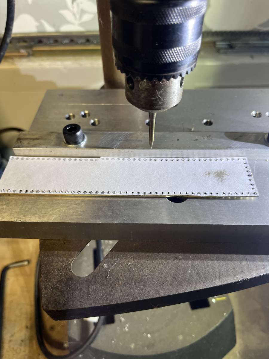

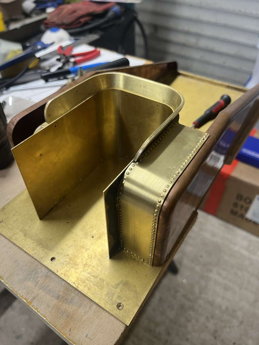

                      I then printed out a rivet spacing sheet and spray glued it to the back of the top sheet, after annealing the sheet.

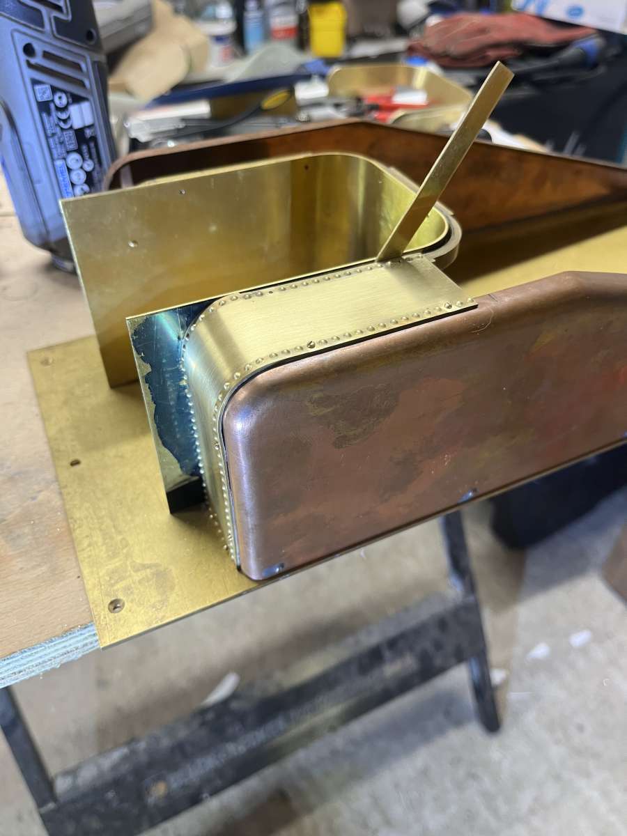

                      i did the rivets for the first 20 or so, then did the bend for the bottom:
                      IMG_5931
                      The next step is to bend the top, cut the top back to meet the sides that are already done and cut out the curved section for the horseshoe and Verge Board, then I can space the remaining rivets, so that they all meet up and look about right.
                      Cheers
