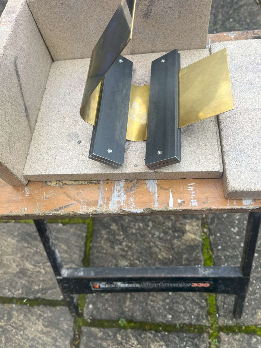

              I got a bit more done this week, starting with some woodwork. I cut out the former from a block of oak that I got from e-bay a few weeks ago. I also put in 3 registration pins along the centre line, shamlessly stolen idea from Kim's build log here: Link to Kim's Build Log
              With that made up, I started rounds of annealing and hammering using my plastic faced mallet. It didn't go too badly, just one corner that I messed up a little, after a few goes with a pair of pliers and some more annealing and hammering, I managed to get it reasonable:
              With that done, I got them separated and made up a block that fits the table on my mill to line up the top. I used the edge finder on this block to set up and square up the bottoms:
              I'm now waiting for some 5/16" square brass for the bottom fixing for these, but have got a bit more done in the meantime. I'll update later

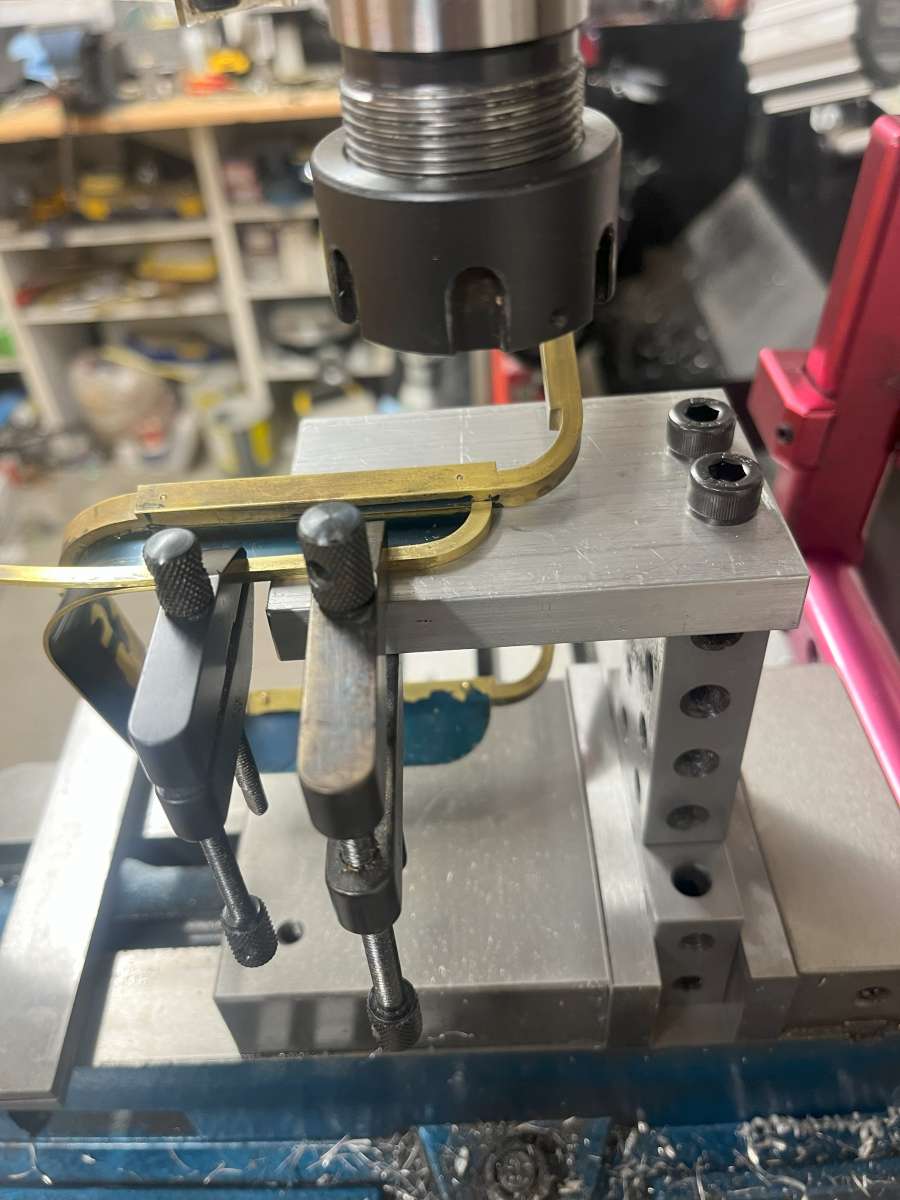

                                                  I have finally got my ‘mojo’ back on this build.

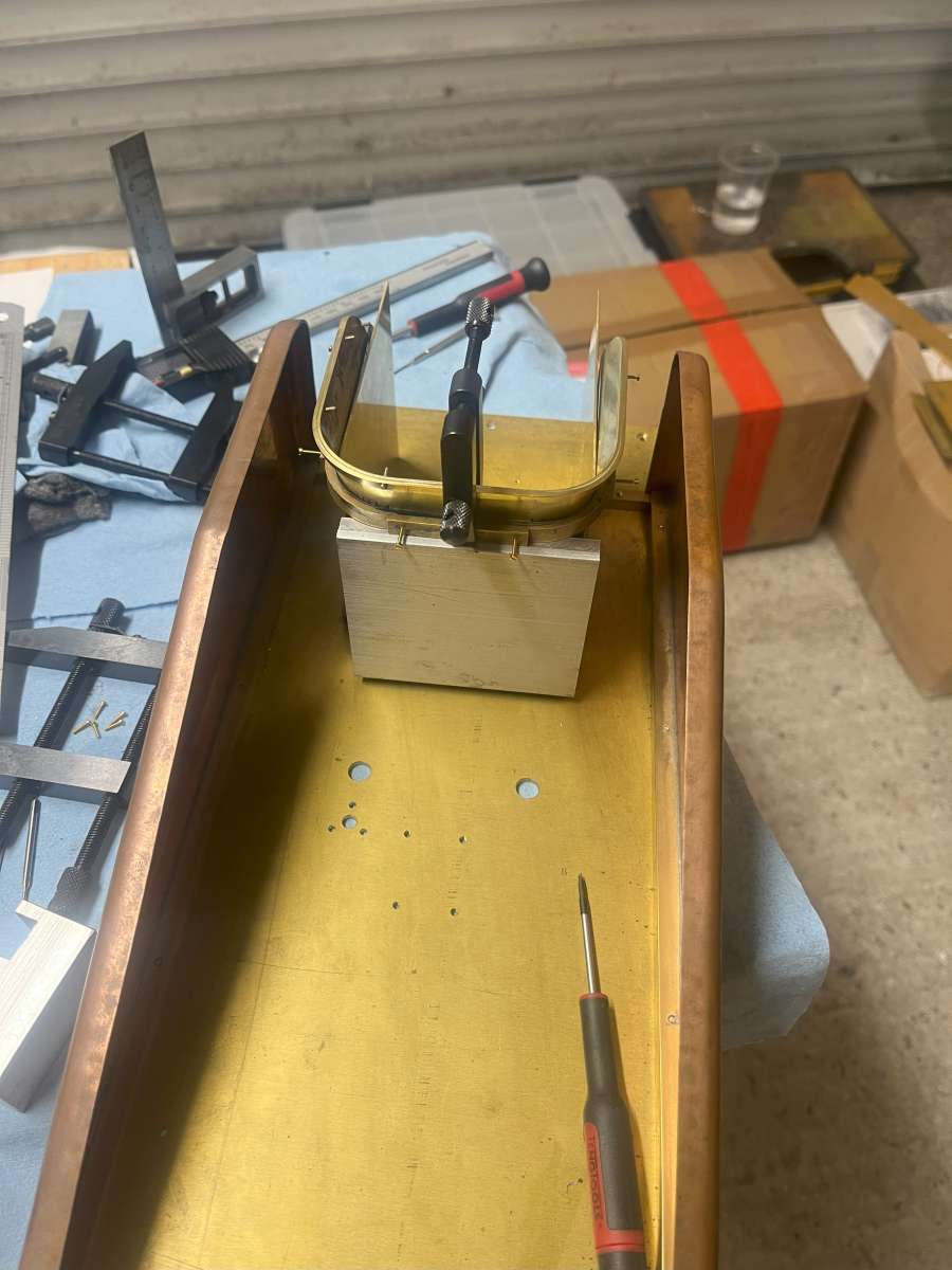

                                                  For long enough, i have been putting off the Verge Board, along with its little strip around the top, as i did not think i could do it justice.
                                                  After watching a lot of Blondihacks stuff recently, I have come to realise, that things don’t have to be perfect, they just need to be the best you can do at the time.
                                                  So, I have got on with the Verge Board and strip around the top. I kept a track of the hours on the little strip, and start to finish, there is around 12 hours in just that little bit.

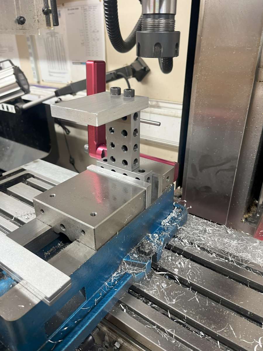

                                                  I have also learned a lot about clamping small parts, and just how handy my (metric) 1-2-3 blocks are for clamping and set up.
                                                  Here is a photo of set up to drill the 1.1mm tapping hole for a 12BA fixing screw.

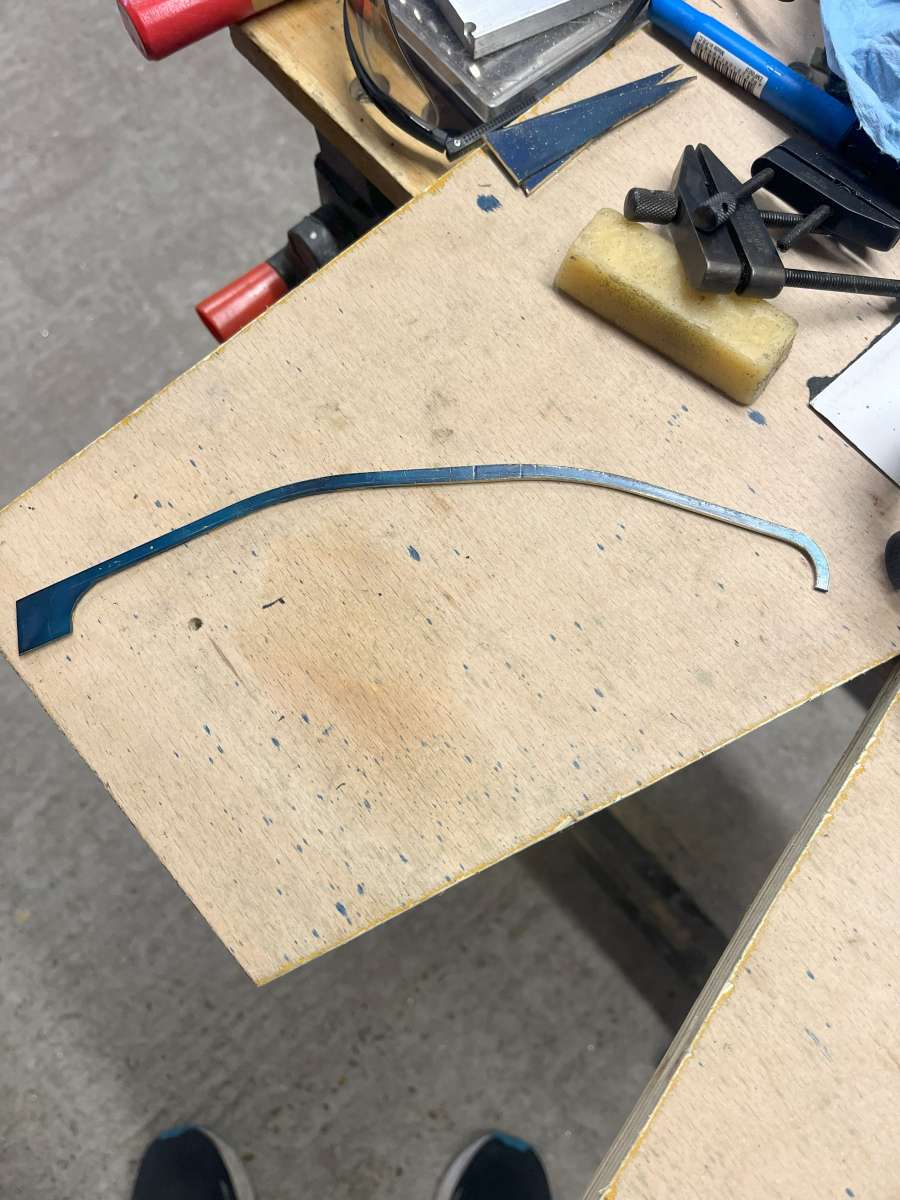

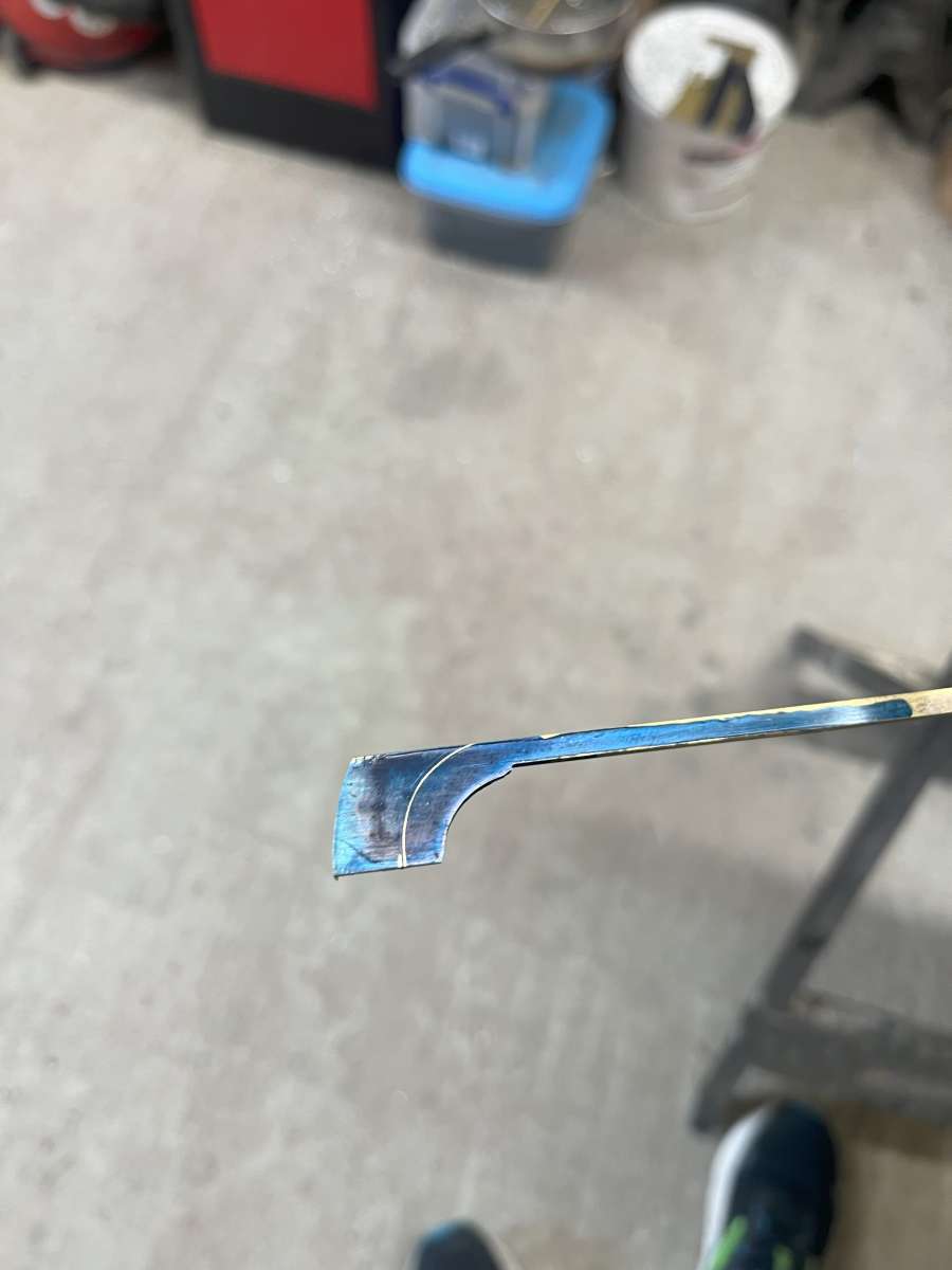

                                                  Here is the little strip, fret sawed out and still rough. I have left one end oversize, so that there is some ‘wiggle room’ on the final dimension, as Kozo does not supply dimensions for this part.
                                                  IMG_5833

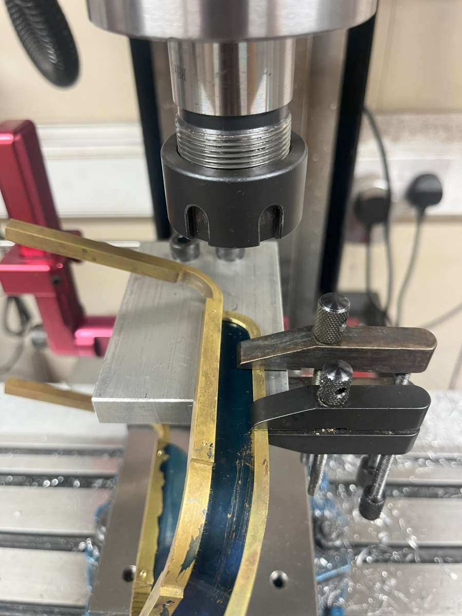

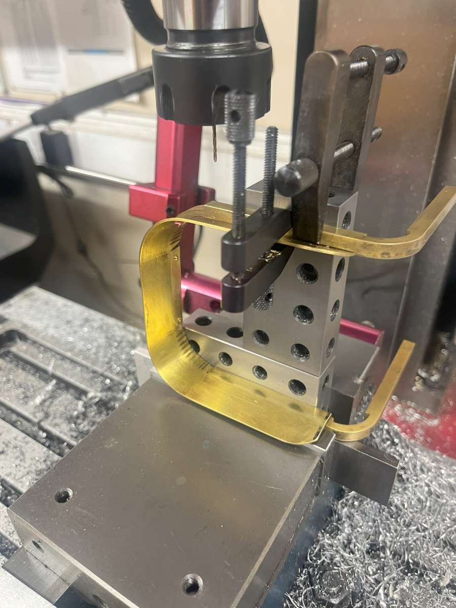

                                                  Here’s my set up for what i’m calling a ‘drilling pad’, I needed some clearance below the drill, so this is what i came up with and it worked really well. Very solid, and, because i’m just drilling 1.1mm, there isn’t much pressure on it.
                                                  IMG_5834
                                                  IMG_5837
                                                  IMG_5838

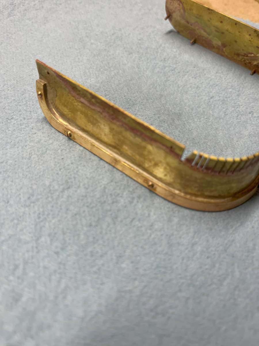

                                                  With one side positioned, drilled, tapped and the corners annealed and bent around, I could then mark up the final position of the other side and then file it to final dimensions.
                                                  IMG_5840
                                                  And this is the result after silver soldering
                                                  IMG_5845

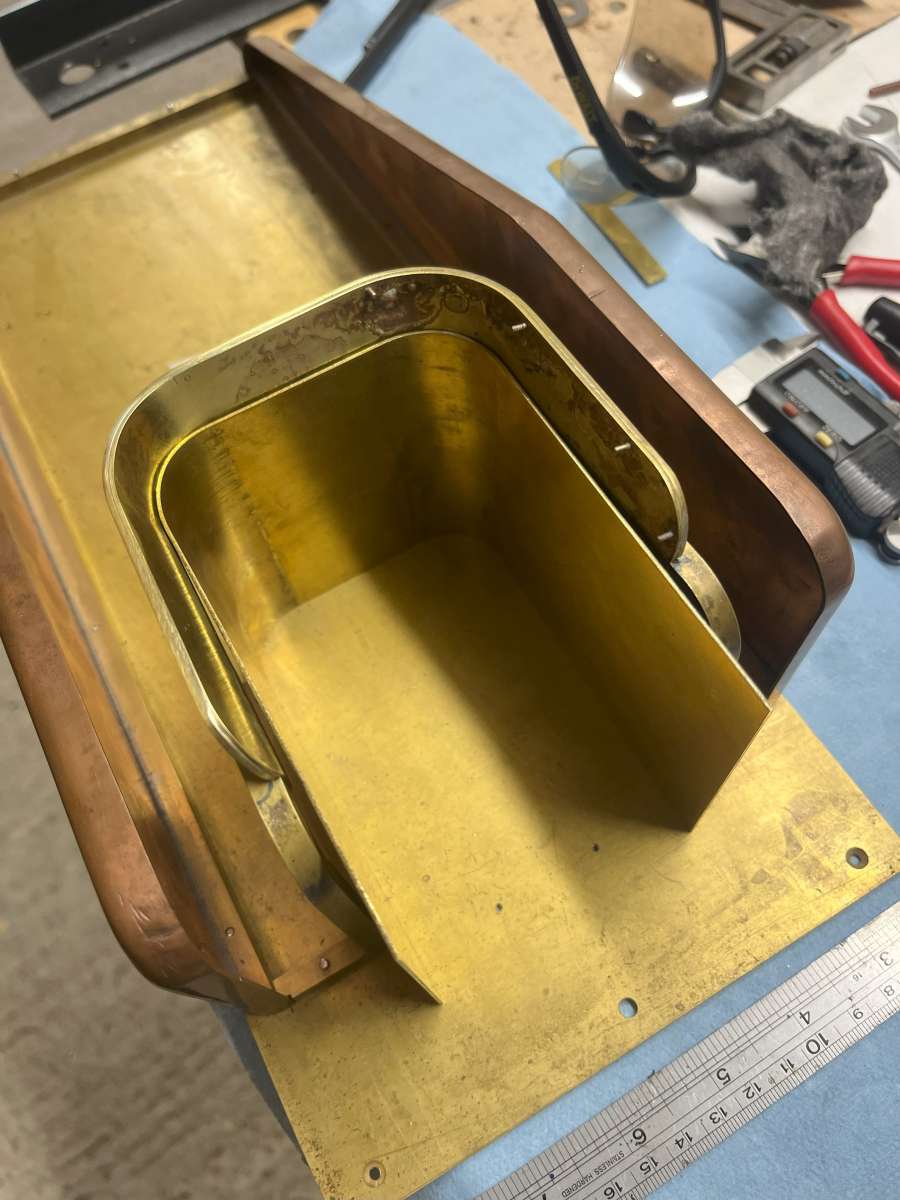

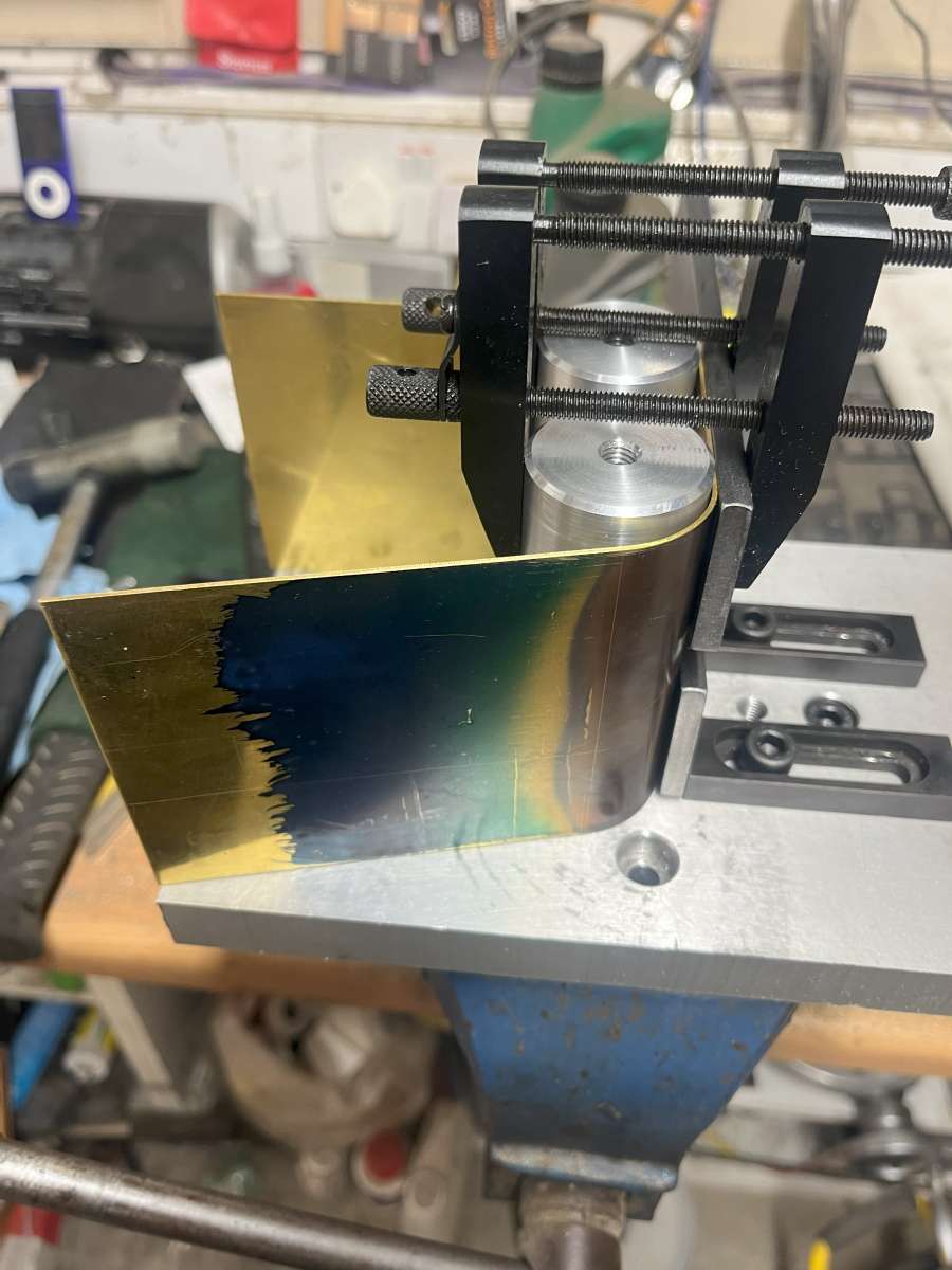

                                                    I’ll now bring this thread right up to date, with the coal bunker side sheet.
                                                    I spent quite a lot of time over Christmas on a lot of this. I made a ‘sheet metal clamping system’ pretty much to Blondihacks design, that allowed me to mill the bunker sheet to dimensions. No photos of that unfortunately. I also made up a couple of longer mandrels for my jig, and a set of sheet metal clamps as per Kozo’s recommendations. I thought I would use the clamps whilst annealing the sections of the sheet that needed bending, to stop the flat parts warping, that worked really well.
                                                    IMG_5866
                                                    IMG_5867
                                                    IMG_5868
                                                    I have left both ends long, on purpose, so that I can cut and file them to length once the front sheet is in place.
                                                    Now its just a matter of drilling and tapping a load of 12BA fixings to hold it all together.
                                                    IMG_5873
