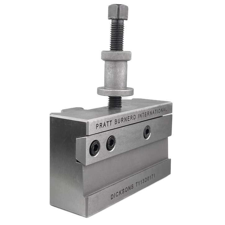

      Plus one for Graham & Howards observations, I cannot see definitively but you should also ensure the top slide is not extended.
      Personally I do not like parting tool holders of the design you are using, they de-crease rigidity due to increased overhang, a real problem on smaller machines and although yours appears to be a more robust machine it will still have an effect.   Your tool post looks to be a Dickson style in which case I would look for a parting tool holder dedicated to your tool post similar to :-

        Note that JohnF’s photo above shows the sloping side for holding a tapered blade vertically.
        Not all of the cheaper ones have that feature; some omit it intentionally.

            While the tool above is very lovely, and many of us would aspire to owning one. There comes a problem when using such tools in the home workshop. After all they are intended primarily for industry. Many of the smaller machines are of an age now where they were designed around HSS tooling. These machines will never work an insert to its capacity and in all probability the insert will suffer for this and have a short life span.
