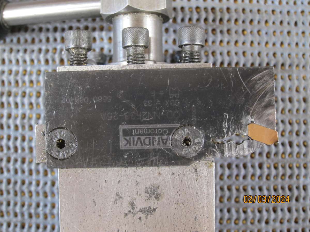

      Today arrived this parting tool from Paulimot. I never did a parting before and being such a historic event I decided to record it. It is a long and boring video except at minute 9:44 when the blade snapped. This is the first accident since I’m playing with the lathe. The workpiece is mystery steel type around 30mm in diameter. The lathe is a 800kg machine (MAS140). I used way oil and manual feed. I was careful to don’t cut too deep while avoiding to just rub the blade and make dust. The swarf color was fine. Luckily I lost only around 15mm from the blade. I hope the lathe is fine.
      I watched the video at slow speed in YouTube and I think I found the reason. At the end the diameter got smaller  and smaller and I didn’t increase the speed while keeping feed rate constant. Or was it something else?

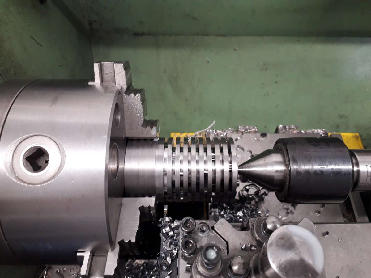

            Your tool is producing dust, it should be making good curly chips like the ones seen here

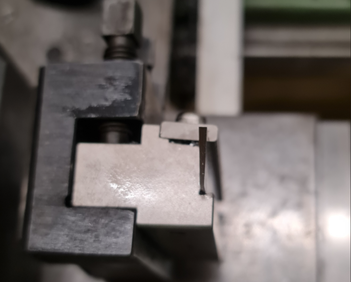

                  Thank you for advices. I made a few changes. First I noticed that the blade was cracked a lot. It shattered like tempered glass in many pieces. The material is very brittle. Maybe because of the 8% Cobalt. Almost 50mm were lost. I grinded the blade like this, to include a top rake like it was mentioned above.
                  I also noticed that there was a small play on the top slide. I hope this was not caused by the previous event. I adjusted the gib and removed it. Also I extended the blade outside the tool only as much as necessary.
                  However something doesn’t feel right. In the past I used a carbide brazed chisel type tool to make deep grooves in stainless steel. Then I could feel the material being cut and I was adjusting the feed accordingly. Bun here I have the impression that I’m using a glass blade. There is little feedback and I’m expecting the blade to snap at any moment. That is why I was cutting for a few seconds and then I was pulling back the blade a little. Or maybe the workpiece is made from a more difficult material.
                  Anyway at some point I stopped. There was little space left between the tool post and workpiece and if the blade would snap it could get stuck in between. I’ll postpone the parting until I will really need it. Until then Evolution TCT saw remains my favorite.

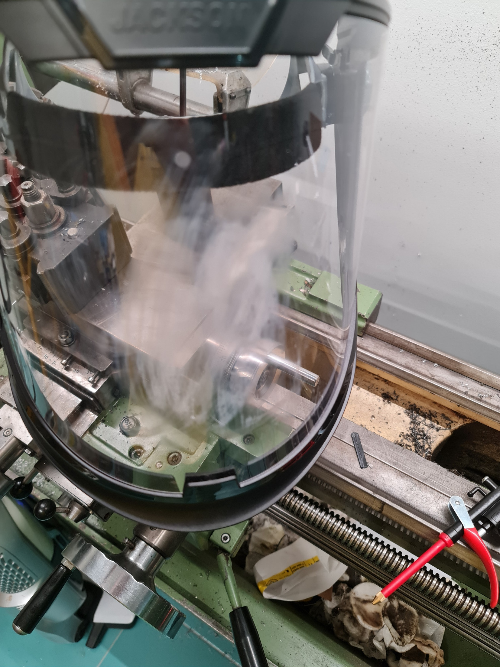

                  Before turning on the lathe I wanted to clean the face shield. I’m not sure why I used acetone. Bad idea. Outside was fine but inside it is cover with a layer that turned white. I think I’ll go to bed before causing more disasters.

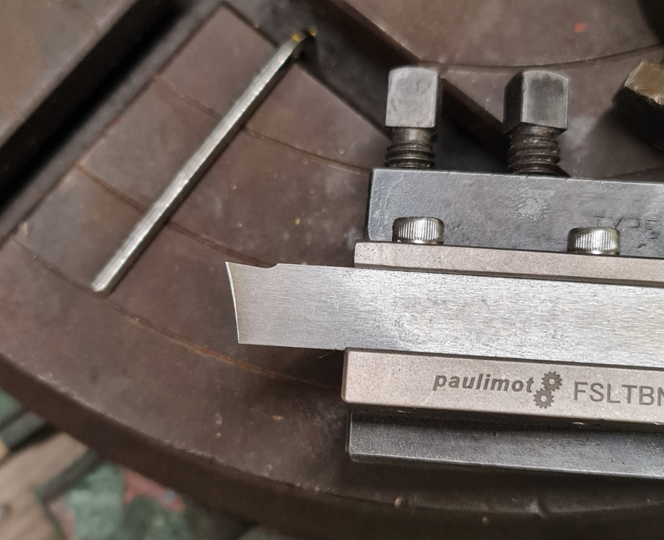

                        The blade it not T shaped but also it is not straight. I know the T shaped blades but I don’t remember where I saw them. That is why I bought the one from Paulimot. Except that it is brittle the blade is super hard. After the last attempt you can still cut yourself on the edge if not careful!

                                                  The front clearance on this tool is far too much. This is one of the key factors which produce dig-ins. I would not have this angle greater than 5 degrees.
                                                  I also do not grind the top of my parting blades. As material is ground off the front of the blade, the cutting edge gets narrower than the rest of the blade. Due to the taper of the parting blade section. This can lead to jamming once the unground portion of the blade enters the cut.
                                                  The top of my parting blade produces a chip which curls up on itself and tilts to the one side away from the cut, due to the dovetail ground on the top.

                                                    PS. The Dovetail section appears to be in the holder the wrong way around in your other photograph. If this is the case it is a disaster waiting to happen, as there is only line contact on the bottom edge of the tool.
