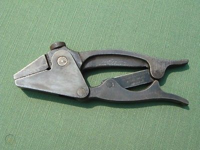

                                      Another possibility is the SPEETOG PLIER CLAMP.
                                      I don't know if they are still made but there seems to be some available on the various auction sites etc.
                                      Brian

                                        The jaws on that one doesn't seem to have parallel action though? It can be adjusted to parallel, but the jaws aren't moving in parallel.
                                        Fun piece though! There are some modern equivalents which are combinations of an adjustable spanner and a plier.
