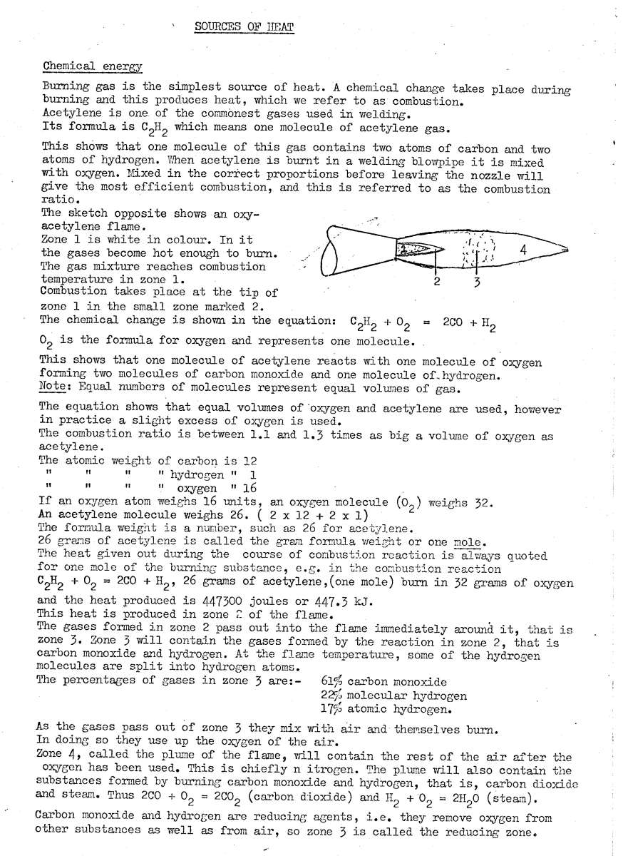

                                          Hi Brian, I can’t answer your question directly, however in theory one molecule of acetylene reacts with one molecule of oxygen, but in practice you’ll use a little more oxygen.
                                          Sources of Heat
                                          This Link may help you with the sizes of each cylinder that you need, scroll down to fuel gas cylinders and you will see their flamepak combinations.
                                          https://www.boconline.co.uk/en/images/Industrial-Gas-Cylinder-Identification-chart-BOC_tcm410-542206.pdf
                                          Regards Nick.

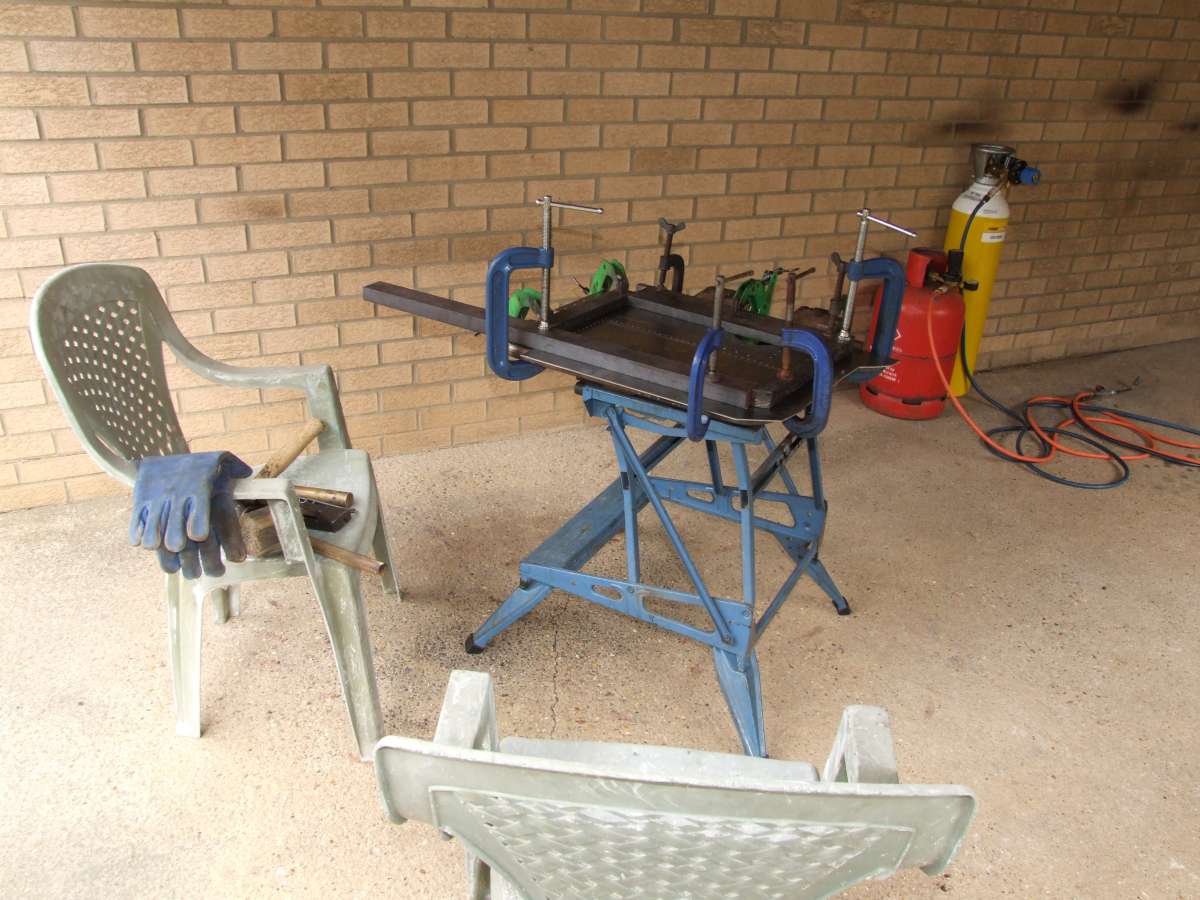

                                            Hi Brian,As a user of both Oxy acetylene and Oxy propane both for work and hobby,What no one has mentioned is the cost of  the bottles ! This is one big plus for propane which will be plenty hot enough. Unless you have all the regulators, torch, nozzles Etc this is a considerable investment.   The gases in small bottles are A expensive and B don’t last long – there is nothing worse than running out half way through a heat. I anwered your question on size from practical experience. Send me I PM I may be able to help you with the equipment Etc. Noel.

                                              The smallest size acetylene bottle that Hobbyweld do is 5 litres. That would be plenty for what you want. The smallest oxygen is about 10 litres which would be fine. Whatever sizes you have, they won’t do anything as convenient as running out at the same time.
                                              It probably wouldn’t apply for what you want, but the small acetylene bottles can be inadequate on a cold day if you have a high demand for gas, e.g. a number 10 PortaPak nozzle. The acetylene is dissolved in acetone inside the bottle, and it has to ‘boil off’, like CO2 from soda water. If it’s too cold, it may refuse to do this.
                                              I think the hazards of acetylene may be slightly exaggerated above; at one time (maybe not so much now) every garage, scrapyard, etc had oxy-acetylene equipment, and they rarely had anything terrible happen (If it was that dangerous, I’d have probably blown myself up long ago). Which isn’t to say you shouldn’t treat it with respect, of course.
                                              Cutting torches are used more often with propane than acetylene now. It’s so much cheaper, and works just as well. They’re useful gadgets. It’s surprising how delicately you can use them – cutting a nut off a 1/4″ diameter bolt without harming either the bolt threads or what they’re fastening is surprisingly easy. Another handy trick is to use them to remove thick, scaly rust – just play the flame over the surface (without pressing the cutting trigger) and differential expansion makes the rust just crack off. I was rather pleased with myself when I discovered this, but I later found out it’s a recognised industrial technique
