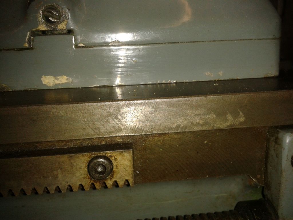

                                          John Stevenson 1
                                            @johnstevenson1
                                            No Myford's ground the beds all thru the working life of the 7 series, can't comment on the earlier Drummond derived machines.
                                            The saddles were also ground where it fitted to the bed and then hand scraped, top slides were ground but the saddle where the slide fitted was hand scraped.
                                            If any Myford's exist with scraping marks on the bed then they have been done at later rebuilds.
                                            They prided themselves on the finish of the bed ways.

                                            Matts BitsNBobs
                                              @mattsbitsnbobs
                                              This is mine at the tailstock end, sorry if its a bad picture best I could get, but it looks like scrape marks on there, if not please tell me what they are?
                                              I am the second owner, the first was a factory where it had little use and came with a pile of bills etc even the original letter confirming the order and when it would be delivered, but nothing of a later regrind. I was always told by an old engineer, who sadly passed away last month, that they are scrape marks? unless someone in the factory had a go?
                                              Matthew
