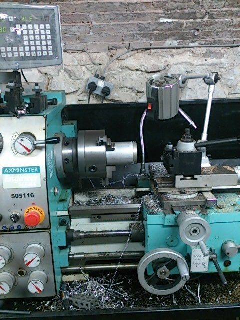

      I have what is basically a generic 12×36 import gearhead lathe. When I bought it a forum member helpfuly pointed me to the Grizzly manual for their 'Gunsmith's lathe', which is a (much!) better written guide to the machine than that which came with my machine. That manual says that removal of the gap piece would be a ''modification', ie irreversible.. I didn't give much thought to this because I thought I'd never want to turn anything bigger than 12" anyway, but you know how it goes…
      The lathe is running nice and true at the mo – my question is, am I likely to screw things up by taking the gap piece out?
      Robin

                                              Well, conflicting views, but it sounds like the importers are just covering their backs by saying that they can't guarantee that that the lathe will still run true if the gap piece is taken out then replaced. Which is entirely reasonable – they are selling mainly to the hobby market I suppose, and there's a wide range of experience ,skill and expectation they have to cater for.
                                              My plan isn't going to work anyway – what I wanted to do was work on a bit of plate mounted on the lathe's faceplate, but the gap is so big I won't be able to get anywhere near it. Doh! I'll find another way to skin this cat, (buy a bigger mill!) but thanks anyway for your replies – if ever I find a sensible reason for taking the gap out I'll do it. In pic below the front of the saddle is lined up with the break in the bed.
                                                  This is one reason I much prefer the English apron, the handwheel is on the right and still has some travel when the gap is out. True it's unsupported but better than nothing.
                                                  The American pattern which is gaining favour as the Chinese sell more in America than the UK has the hand wheel on the left as in the picture. Right in the way of all the red hot crud flying off the work.
