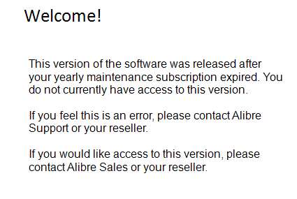

      I’d not used Alibre for quite a while, but when I tried to open it yesterday it proudly offered an “up-grade”. I am usually wary as these invariable adding more bells and whistles I don’t understand, need or want, but I loaded it anyway. I don’t think it gave any choice anyway.
      Then Alibre said this:
      Screenshot 2024-12-25 090716
      I did not know I had bought any “yearly maintenance subscription”. I thought I had simply bought the then-current version of Alibre Atom by one-off purchase. Anyway, although Alibre Atom is still taking up space in the computer, it will not now open even from a drawing made in the older edition.
      Unless I have Alibre Atom on my previous and now spare, off-line PC, I cannot even convert my Alibre drawings to transferable formats possibly useable in TurboCAD.
      Well, not without buying a new version of Alibre Atom.

        Surely [correction: make that hopefully] there must be a way to retrieve use of your, now unsupported, previous version.
        You don’t deserve to encounter hurdles like this, Nigel
        Edit:__ a Google search for alibre atom downgrade returns some reasonably encouraging links.
        #772442
          You got a limited amount of maintenance when you originally purchased it, most likely 1 year.
          Just as I told you before when you thought you had lost Atom from your computer it is simply a matter of downloading the version you have paid for from the Alibre website
          It’s not a hurdle if you know how to jump.
          Select Atom from the first dropdown that comes up here and then go to the bottom “all versions” and load the one you have. Any problems then the Alibre forum should sort you out.

            As Jason mentioned, uninstall the version that won’t start, then re-install the previous version.  Ignore messages about licence release when uninstalling.
            You should have seen a warning during the update that it was not valid with you licence, and had the option to cancel at that point.

              Once you have Atom3D working again, I suggest that you disable automatic checks for updates.  That will avoid the problem in future.

                    To be clear, Atom3D does not enforce a subscription based licence – though in North America a subscription option is available for those who really want it.
                    The default licence type is perpetual (for the version of the software that was current at purchase).  Software updates (access to newer versions) are optional and can be purchased in 12 month chunks.

                      I now have it back.
                      Thankyou David!
                      The way it had acted, as AA 28, suggested it was completely locked, not even simply rejected the up-dating.
                      It took two attempts to re-load version 27. The first failed because v.28 was hogging the space, but once uninstalled that it all worked fine and did not even need ask for the licence key – though I have copied that to a reference ‘Word’ document.
                      It worked so well it even showed me I had as usual, aligned each part on different planes and not the correct ones. I’d created a simple, 2-part non-return valve… that would squirt water over everything from a hole in the body side!
