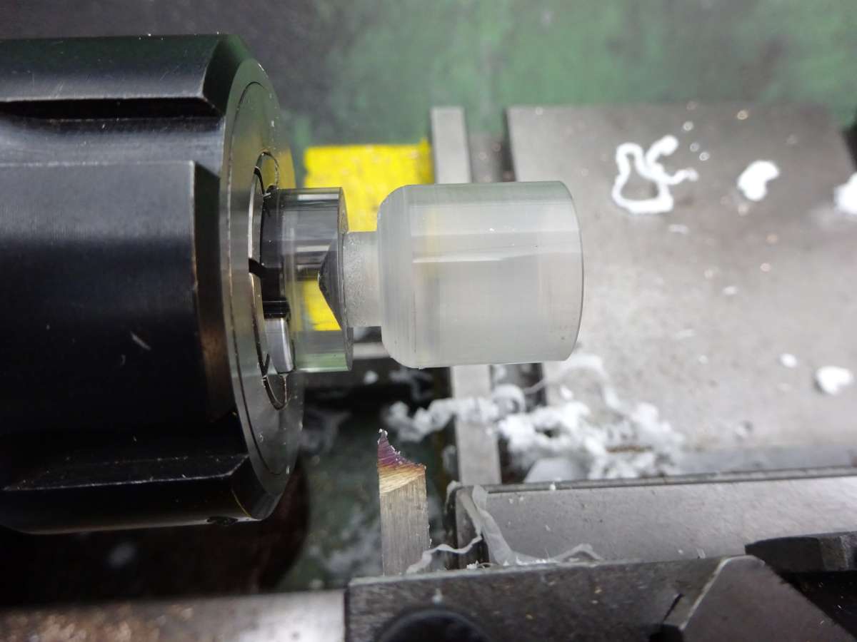

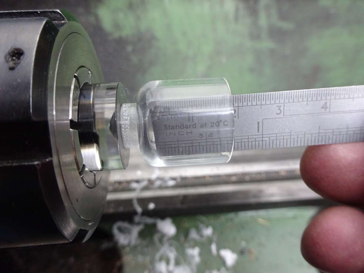

                Not tried iton Ebonite but have done various plastics and clear acrylic using Micro-mesh which are a range of cloth backed abrasives down to 12000grit and then a final liquid polish which is a lot finer than metal polish. Said to have originally been designed for removing marks from fighter jet canopies. My kit (KR70) goes down to 6000g which has been been enough for my uses. Uses water to stop the mesh clogging so nothing else to stain the material.
                As machined
                DSC02641
                Polished mostly inside and the curved bottom
                DSC02643

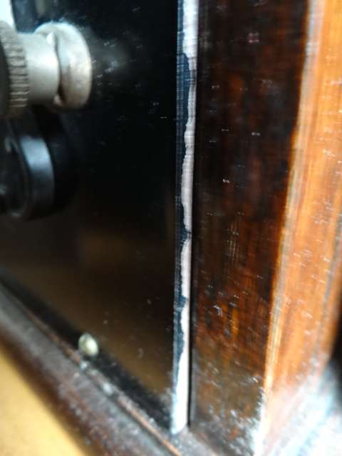

                      I’d try polishing as described by colleagues first, but if it fails to get a ‘good enough’ result, this photo is an example of my mate’s work.
                      DSC06860
                      The camera does a poor job of capturing the colour of the panel edge, in real life it’s a medium grey.  The black splashes on the edge show my mate restored the panel by painting and buffing on a wheel.  Don’t know if my radio was done with the black dye used to restore shoe leather and black boot polish, but he mentioned that as a possibility.  His work looks OK from a distance.
                      His efforts were in vain!  After recreating a working 1920’s wireless receiver from an original wooden chassis plus period parts, he sent it off to a proper auction-house hoping to make big money.   Nope, the auctioneer’s expert denounced it as a fake, and it came back with a letter saying he should never contact them again!    Restoration work is controversial because the genuine article in good condition is worth serious money, and fraud is a major problem.

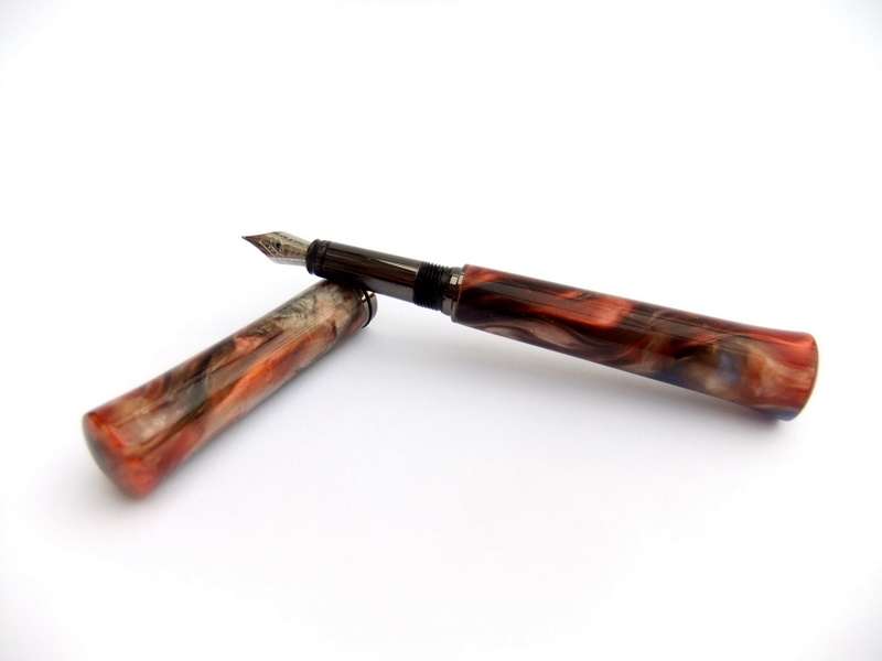

                          I use THESE on acrylic pen blanks along with THIS. and get a finish like the photo. As it is a flat panel it will take a lot longer as when doing the pens the acrylic is rotating.
                          DSCF6518 (2)
