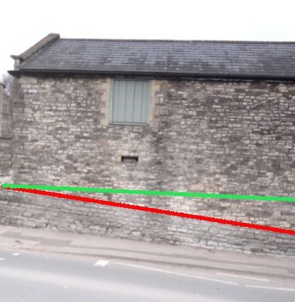

      On the way to visit mum I stopped in Corston to buy her some stamps, and took the opportunity to photograph this building which has intrigued me for years:
      It's an old outhouse, built on the corner of a walled garden. The hatch and slit window are consistent with hauling bags from a roadside cart into the upper part of a stable.
      The outhouse is built on top of an existing wall, that's been laid at an odd angle (red line), not horizontal (green line).
      Peculiar in my limited experience, because brick and stone walls are normally built in strictly horizontal courses. If laid at an angle as in the photo, the weight tends to cause sloped courses to slide down the ramp. The construction is unstable, and I think it's dangerous to build on a sloped wall as has been done here. The outhouse on top is built conventionally with horizontal layers.
      Though it doesn't show in the photo, the lower wall is a different type of stone to the building, which is the area's usual limestone, likely 19th Century or earlier.
      Presumably to save money the outhouse builder took a risk by reusing an existing wall, even though it was tilted. And got away with it, because there's no sign of movement!
      But why build a wall with off-horizontal courses in the first place? To me it implies a need to support something heavy resting on it at an angle, in the distant past. Anyone know the answer or able to offer an intelligent guess?

          Possibly the original wall was built when the road surface sloped down like the top of the wall. If you could dig down below the pavement level, I suspect you would find the foundations of the wall sloped down below pavement level.
          Subsequent road "improvements" have levelled the road surface.

              Not if it started out as a 3 ft high boundary wall or similar and was subsequently used for the base of the existing building. Most dry stone walls for example follow the slope of the ground and are not stepped or laid in horizontal courses

                Mundane answer from me :
                Because it was originally built as a boundary wall, and followed the terrain.

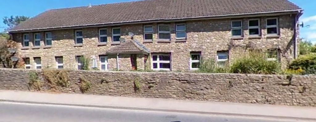

                  Good example of the old wall following the natural contours just up the road on google maps

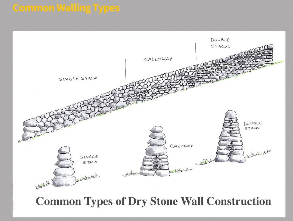

                              Different types of wall only one with horizontal coursing the double stack, as me and Michael said it was possibly a (field) boundary in another life
                              Admittedly the wall in question has fairly regular coursing which would make slipping more likely, usually you would have more raddom stone sizes so there are no long sloping joint lines to slip

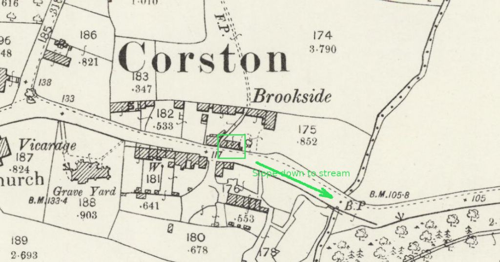

                                    I like the boundary wall suggestion. This clip from the 1909 25" Ordnance Survey map shows the road slopes down to cross a stream.
                                    The road is the A39, built as a Turnpike in 1707 connecting Bath to Wells, and re-engineered by McAdam sometime before he died in 1832. My guess is the original road dipped down steeply to ford the stream, but was raised high over a causeway that removed the awkward dip. In which case the sloping wall could be earlier than 1832, and it's right for the boundary of the Brookside property, sat in a 0.852 acre garden.
