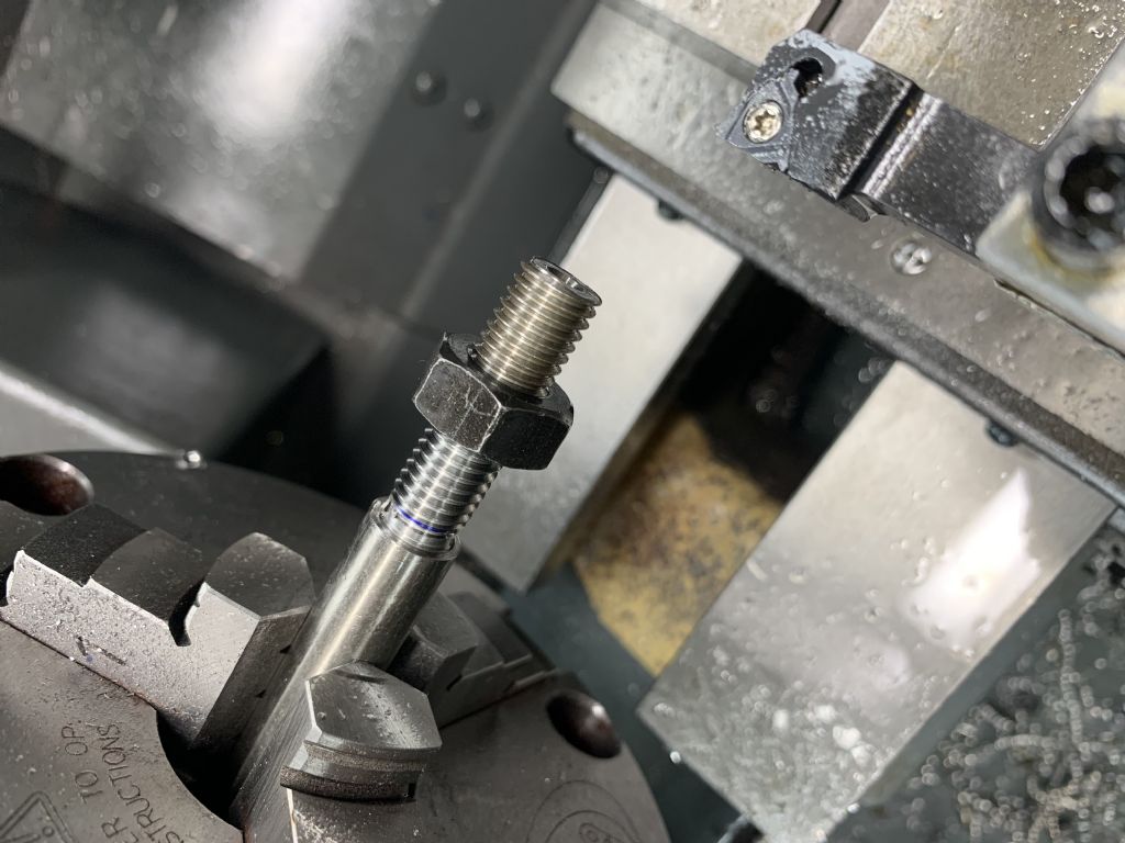

                          Gents,
                          I took all of your advice to heart and had another go today. Total succes, even pleased with the fit. This is not a functional part, merely a test cut to validate Brian Woods drop arm and 33T/34T set up. Worked like a charm.

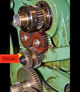

                              I am glad you have posted this, because i bought the 2 gears. Never got round to trying them, but what is it I have to make, (Drop arm or something. Confused as to exactly where the 2 gears go. I have read a lot about this subject but not sure i ever saw which gears to change. Any pics would be much appreciated.

                                  @Steviegtr this is the wheel to place the 33t or 34t gear. Because it is a bit bigger than the gear normally in that position you have to drop the banjo a little bit lower. This means you have to make a simple drop arm.
                                  #477592
                                  Mark Gould 1
                                    @markgould1
                                    That is a pic I borrowed off this site. I'm not sure who's it is and all I did was added "this one" to show the appropriate gear.

                                    not done it yet
                                      @notdoneityet
                                      That pic of your early success looks as good as one might hope for, with later successes! Spot on!

                                          Mark, looking at your picture I would like to make the following observations. The thread looks good but the tool looks to be stuck out a bit more than i would have it and if you dragged that carbide bit backwards over the workpiece you are lucky if you didn't chip the insert.
                                          If you can then reduce tool overhang as much as possible. If you run a carbide insert backwards then always inspect it carefully if it hasn't snapped or obviously chipped from the upwards force on the edge.

                                              Martin, good idea. I have not examined the insert yet but will do that, thanks. I will also pull it back into the holder a bit more. No reason at all for the over hang.
                                              Mick, yes this was a plunge cut. I used copious amounts of oil As you can see in the photo but will cut them at the proper angle once I have discovered how to accurately establish the 29,5 deg recommended for a Metric thread. Thanks for the tips,
