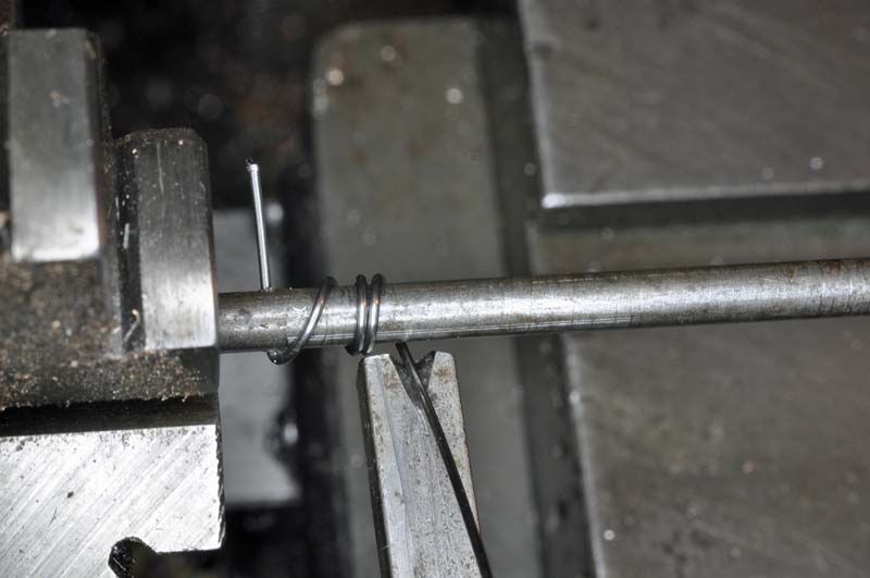

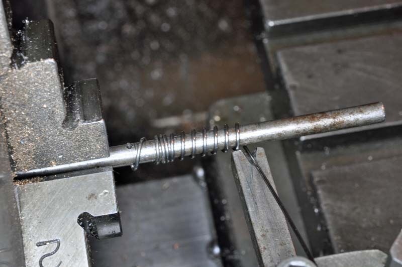

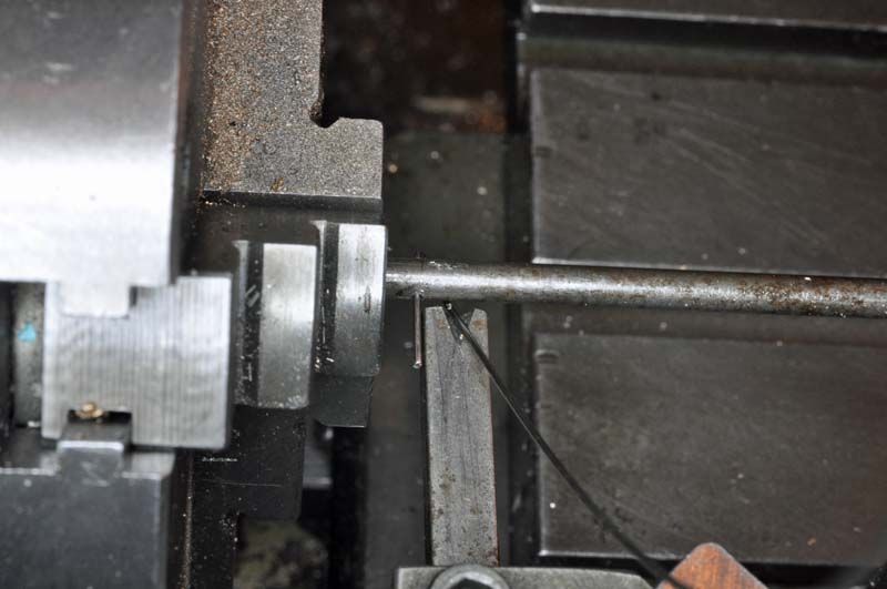

                                  Winding your own springs is very straightforward. Choose the gauge of spring (music/piano) wire and the i.d. of the spring. Find a bit of MS steel to act as the mandrel and drill a cross hole to anchor the wire. Mount a bit of bar in the lathe toolpost so that the top of the bar is at centre height and file a V groove into the bar top surface.
                                  Set the lathe up for screw turning to the desired pitch. Without engaging the lead screw turn a couple of close turns.
                                  Then engage the lead screw and turn the spring to the required length
                                  Now disengage the lead screw and add a couple more turns
                                  Snip off the wire at both ends and you have a spring with closed ends
                                  Now touch each end of the spring on a grindstone and you have a completed spring
                                  I turn the mandrel by hand for this process and you might need to do a little experimentation with the spring mandrel diameter. I've used this method on 3 engines now and the springs have fulfilled their purpose admirably. Spring/Music/Piano wire is available from the usual ME suppliers.

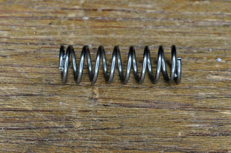

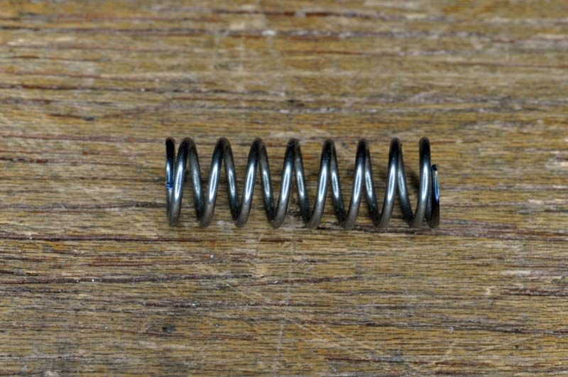

                                  #157180
                                  Steve Withnell
                                    @stevewithnell34426
                                    This is me winding the valve springs for the Nemett –
                                    Steve
