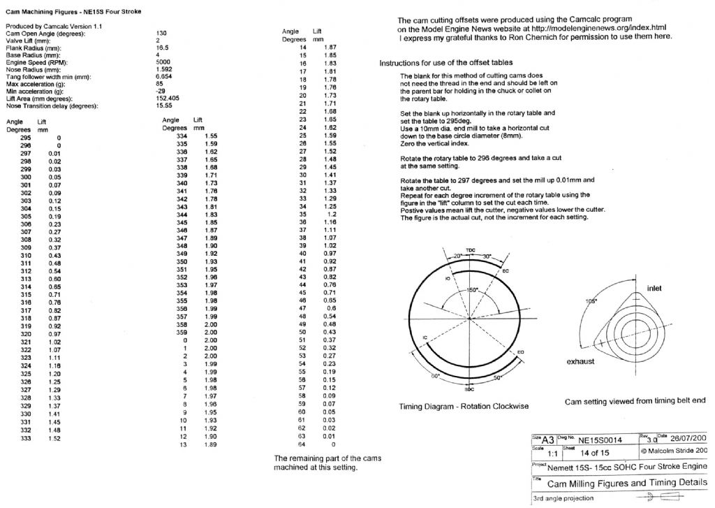

      I'm in the process of building the Nemet Lynx from the recent "Best of Vol3". I guess that with the original articles being published in 2006 any errors didn't make kit to the online forum, or the forum didn't exist back then..
      So apart from
      • the "Best of Vol 3" not having the complete set of cam tables
      • the drawings for the cam box in the 2006 version being completely wrong (not an issue in "Best of'" )
      • the stated offset of 1mm for the bearing holes in the cam box being wrong in both "Best of" and 2006 (it meant to say find the centre and offset by 0.5mm)
      • The spacing between the outer faces of the cam lobes being 19mm not 13mm as stated in both versions
      Is there anything else I should be aware of?

            Pete, regarding the offset on the cam box which is 15mm deep, if you place the hole 8mm from one side as shown on the drawing it will offset it 0.5mm from centre line. So only the text is wrong.
            Where are you getting your 19mm between cam outer faces from or the 13 for that matter. I make it 21.5 by the time the spacer has been added between the two cam lobes, though 19 would suit the valve spacing better.

              There is a correct table for the cam cutting, on a previous thread on this web site.
              As to having to assemble tha cams inside the housing. As far as I know that is not correct, that is why the bearing outer diameter is as large as it is, so that the cams will pass through.

                Correct Cam cutting table is in the thread "Best of Model Engineer 3" on page 7 posting by Katy Purvis pdf's for down load by Jason Hope this helps.
                David

                  Thanks guys I think I have most of this covered off. I'll address each on in turn so it all here for others.
                  It is possible to assemble the camshaft 'out of the (cam) box'. The cam blank is 12mm and this is machined down by 2mm to the base circle. So it ends up as 10mm to the lobe peak so will fit through the 10.5mm hole. BTW I did my hole 11mm which makes the bearing housing 11mm and a bit more robust when pressing in the bearings.
                  Jason
                  Yes its the text I was commenting on. If the builder follows the text then the hole is 0.5mm too low and the cam will probably not be able to rotate.
                  Spacer? There is no drawing for a spacer although the photo shows one. As you say the valve spacing is 13mm and with the 6mm cams the outer edge of the cams is 19mm. The width between the bearings is 29mm minus 19mm (not 13mm as the text) that makes the outer spigots 5mm (measure from job). With 19mm to the outer edges of the cams the inner edges are 7mm apart and therefore the inner spigots are 3.5mm as per the text. (One of our club members had started this build from the 2006 articles when he showed it to me the cam box looked all wrong. When we checked the 2006 version in the online archive the dimensions were all to cock http://www.model-engineer.co.uk/members/digitaleditions/popup.asp?t=8&i=444 Page 137 Not the case in the "Best off" )
                  David
                  Got that thanks, and copied here to consolidate the data.
                  On the missing cam data the direct link to the online copy of the original issue 4281 is on page 262 here.

                                  Hi bit late now but there are no errors in the cam box drawings from 2006, and there are no spacers on the cam shaft, the cams lobes are 6mm wide with bosses each side, one side 3.5mm wide the other 4.7 wide, the 3.5 bosses go together in the middle, this gives you your 13mm centres same as the valve centres, with the cams on there shaft the overall dimension is 28.4. the cambox is 45mm long with a 30mm long slot, 7.5mm each end, the bearing housings are 8mm wide therefore protrude .5mm either end into the 30mm slot, which will leave you with .6mm end float if your measurements are that accurate. The cambox is 15mm deep and the cam bearing holes offset towards the head by 1mm. Regards Alan.

                                    I agree the full set of drawings will be fine, I doubt if they would have been changed since 2006. The problem is a transcription error from the drawings to the magazine article in 2006. The cam box dimensions are all wrong. I only noticed it when a club member showed me the engine he had made from the 2006 articles. Something didn't seem right so I checked. There are also errors in the text that have been carried over to the 'Best of ME' edition.
                                    Just a case of builder be aware, and check when working on this part depending on your source of information.

                                      At the risk of let every one know I've lost the plot. Looking at the cam box drawing in the Best of Vol 3 page 38
                                      the cam box depth is 15mm and the offset is given as 8mm giving 0.5mm. But the text says 1mm as does Alan above.
                                      Can you clarify which is correct. If it is 1mm then the bearing housing is only 1.5mm from the head face.

                                        My drawings are rev 3 dated 26/7/2007 and show the offset as 8mm giving 0.5mm from ctr line.

                                            Hi sorry I have lost the plot, Jason is correct, the offset is .5mm offset towards the head.
