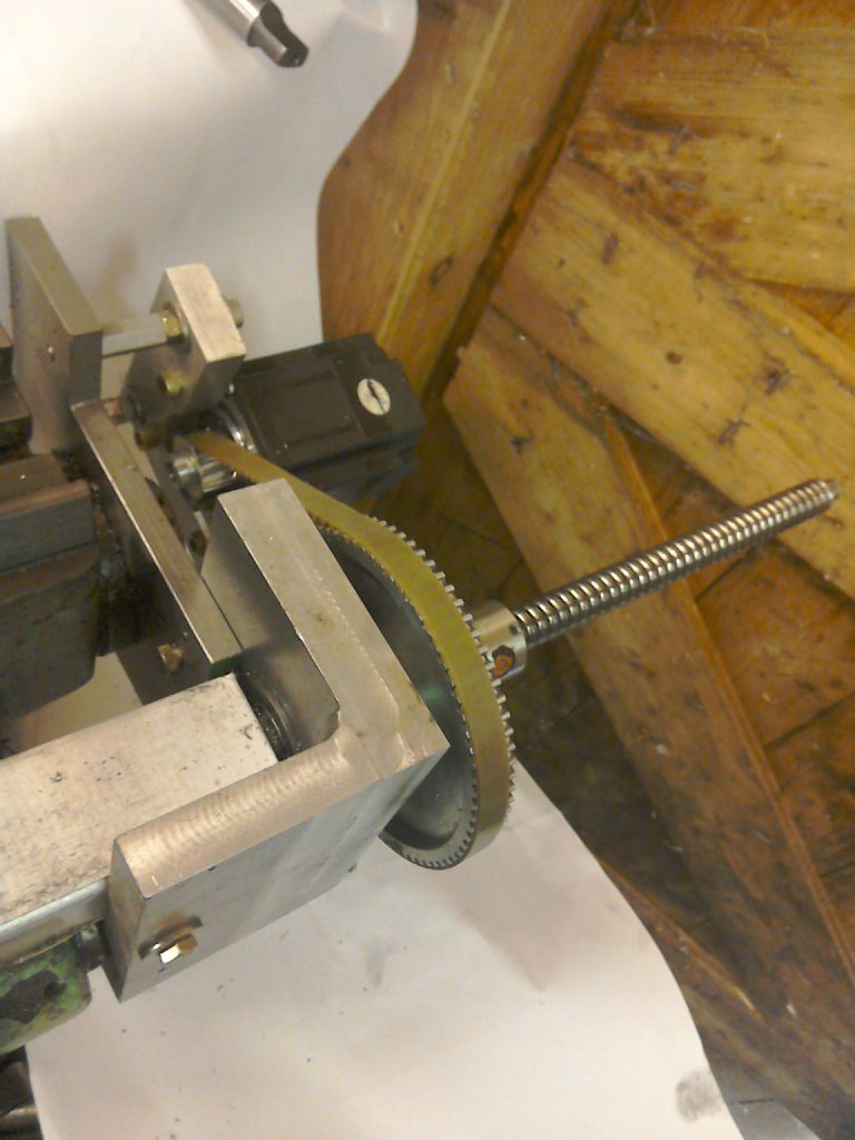

                If you buy closed loop stepper motors you can have an error signal to stop things if there is an issue with lost steps. It may cost more initially but you are only doing this once so may be a consideration. If you then have a slightly smaller stepper motor the occasional times you try to move things either too fast or too hard the error signal will trigger. Leadshine make closed loop driver and steppers but there are probably others, I haven't looked for a while.
                This photo is of a rotating ball nut operating a push/pull ballscrew connected to the carriage. Note the small stepper motor. It is a Leadshine 3 phase closed loop matched to their driver unit.

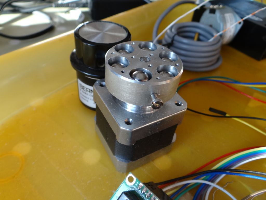

                          All steppers I've used suffer from resonance. Worse when run unloaded on a table, but can be annoying at certain speeds when mounted on a machine. Rattle dampers are easy to make, not sure how effective they are because this one is unfinished.
                          Each hole contains a slightly loose fitting 10mm ball bearing. The idea is they break up resonances by bouncing around inside – when a resonance causes the wheel to decelerate, their inertia reduces the effect. Likewise, they slow short sharp accelerations by soaking up energy.
                          As shown the rattler noticeably reduces resonance but the holes should be filled with oil to dampen the balls and sealed with a cover.
                          Need to make another one – there's a broken tap in one of the cover threads, I shouldn't have chamfered the top (it wasn't on my drawing!), and I carelessly misaligned the fixing screw hole so it broke into one of the chambers.
                          I've no idea what theory says about optimising the design. There must be a relationship between resonance and the number and weight of the balls arranged in a particular diameter. Hopefully it's not critical. Anybody understand how to design rattle dampers?

                            I did quite a bit of work on the 'rattle dampers' – fitted one to each axis of my small CNC router, which upped the rapids hugely Also fitted one to the stepper on my rotary table/hobber, which likewise upped the max rates tremendously. For the life of me I cannot find it in all my posts on this forum! No search mechanism here helps…
                            Anyway, I don't wish to contaminate this thread with info on all that, but to extract the available torque from a stepper requires that the correct supply voltage be used – as high as possible – to overcome Di/Dt at high(er) rpm's, where torque will fall anyway, but if the supply volts are as high as possible, at least that will not cause premature loss of torque.
                            Another critical element is stepper acceleration. If accelerated very slowly you would normally not have any issues – and unless really undersized, no steps easily lost. This would be the typical use in an auto-feed say on a mill axis, where acceleration is not normally an issue. It is a different matter on a NC application, where rapid moves are at high(er) speed, so acceleration tuning becomes key.
                            However, a stepper can also lose steps, and even start to go in reverse(!) when it hits bad mechanical resonance.
                            Coupling the stepper to the machine shifts the resonance point, but it is still there. Coping with this resonance is achieved in two ways – acceleration through the resonance point(s) as quickly as possible, fitting a flywheel to force the rotor through the resonance without stalling, or fitting a viscous or rattle damper.
                            There is a lot of info available of the design of a viscous damper, and they work very well – are the best type. However, it is still almost impossible to design one in the hobby shop, as you need to know so many paramaters regarding the machine the stepper is driving – all inertial masses, friction coefficient, damping constants, stiction, etc – nigh on impossible for the hobby man to measure.
                            My rattle dampers were a fair suck on both thumbs – first I found the resonance point of the system ( stpper mounted on the machine) where the stepper would stall or lose steps. Then I added a plain flywheel and sized that till it no longer occurred. Then search for new resonance point and change the flywheel circumferential mass till that resonance no longer caused a stall – then checked the first resonance point, etc…
                            When resonance was no longer an issue of concern, I then pushed the stepper acceleration , till it stalled or lost steps, and then drilled out that flywheel and fitted mild steel slugs – rods – as close to the periphery as practical. I found the acceleration achieved was then easily 2 to 3 times more, before problems reappeared.
                            Unlike the viscous damper, there is NO design info, patent, or published science on the rattle damper..
                            But is does work very well indeed, even if you have to become a little infantile and suck your thumb.
                            I have no idea if my 'design' is optimal, or what can be done to make it better, but the concept does seem to be effective over a broad design envelope, and very forgiving of error margins. But do the flywheel versus resonance thing first – the flywheel alone already enabled around a 1.2 to 1.5 times acceleration increase.

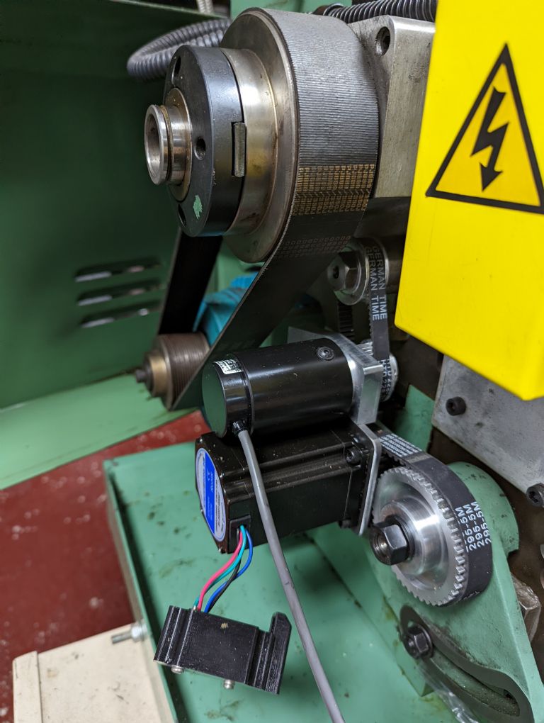

                                                    Pic of motor and encoder on my 254.
                                                    For anyone interested I did some work on the Clough42 software.
                                                    Adding; custom threads, thread to shoulder, multistart threads and a few other bits and pieces.
                                                    You can pull them down from **LINK**
